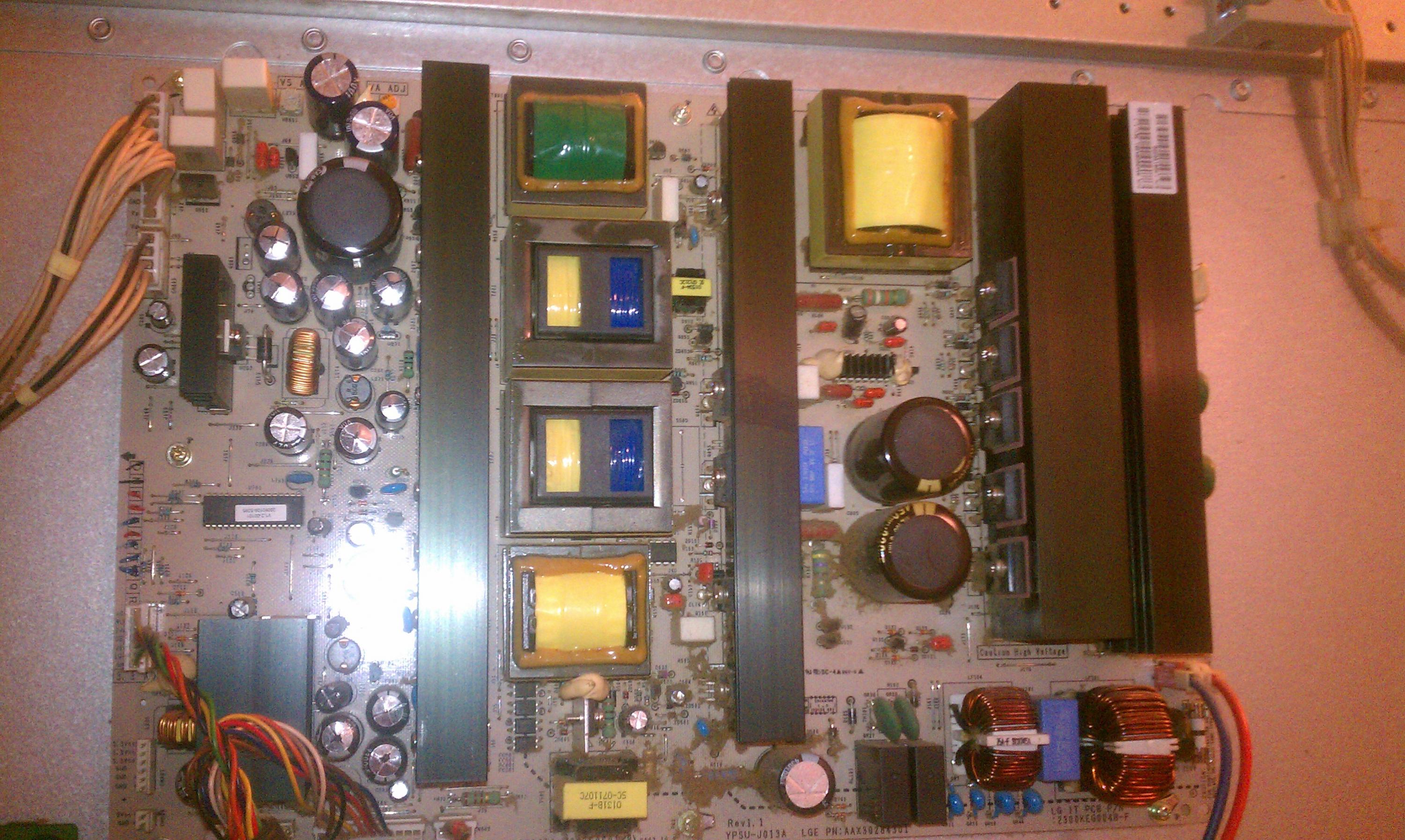

    I acquired this from a family member. I have zero electronic skills, I am a painter. So, this system turns on and then starts blinking, the picture just goes off and on. It makes no noises to speak of. I asked another family member about it, and as a result of that conversation, I took out the power board (with help) and had it repaired (11 popped caps).
    So as happy as I was, when put back together, it still blinks.
    I am at a loss, and I have read several posts about y boards and x boards, but no idea what one looks like, top remove to haver it repaired. Taking it in for repair is not an option. Anyone have any input, and thank you very much in advance.

    First thing you need to do is pull the plug. remove the connectors that go from the power supply to the board on the far right and the far left. Power it up. Does it stay on or turn off again. If it stays on unplug it. Wait 10 minutes then plug in the right board again. Power it up. Does it still stay on?

            This PSU may also suffer from the LG AC detect issue. Check the AC Detect pin if you can find it.

                        Is the picture you provided taken before or after the caps were replaced? You can clearly see bulged caps in the picture
