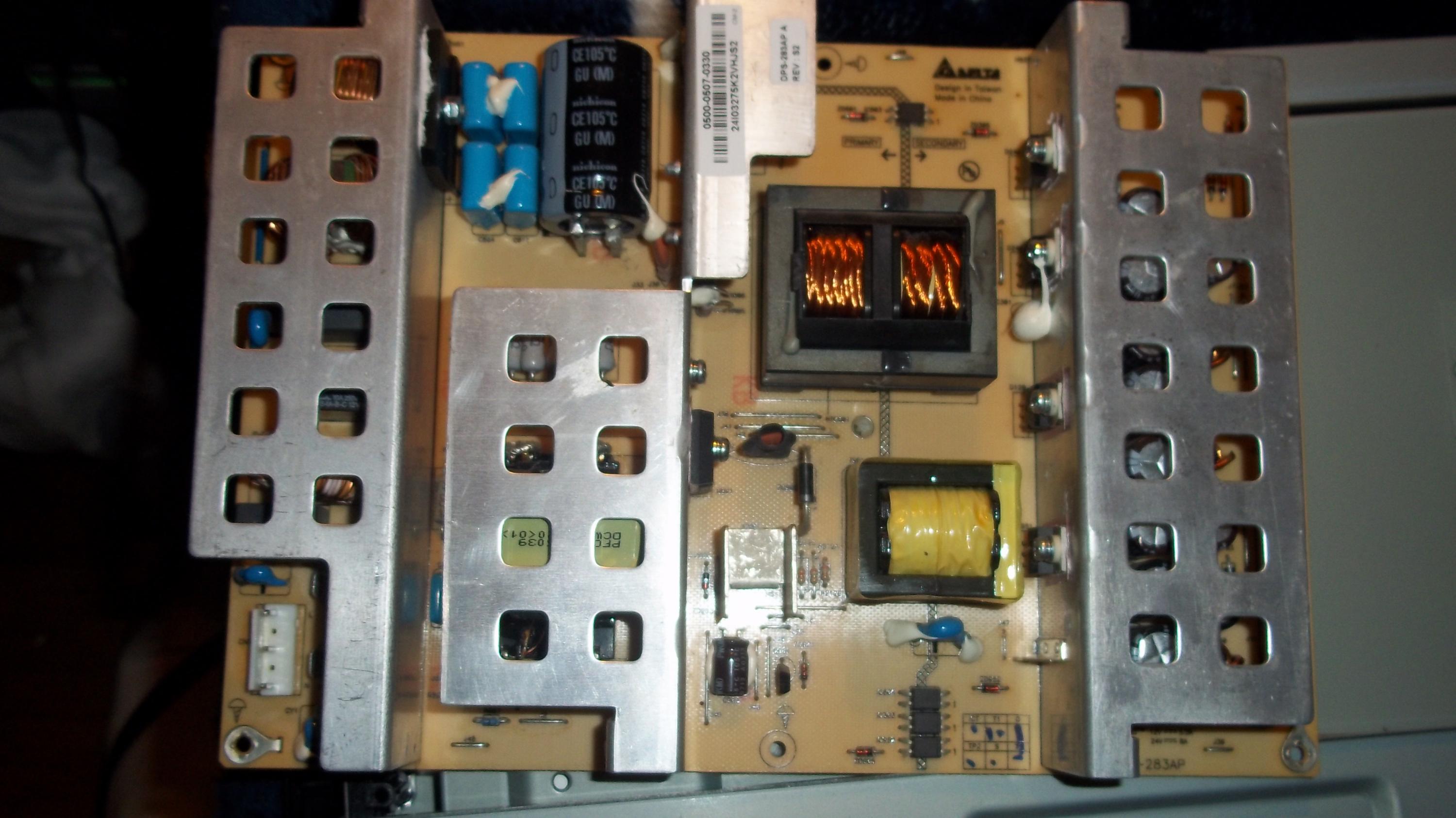

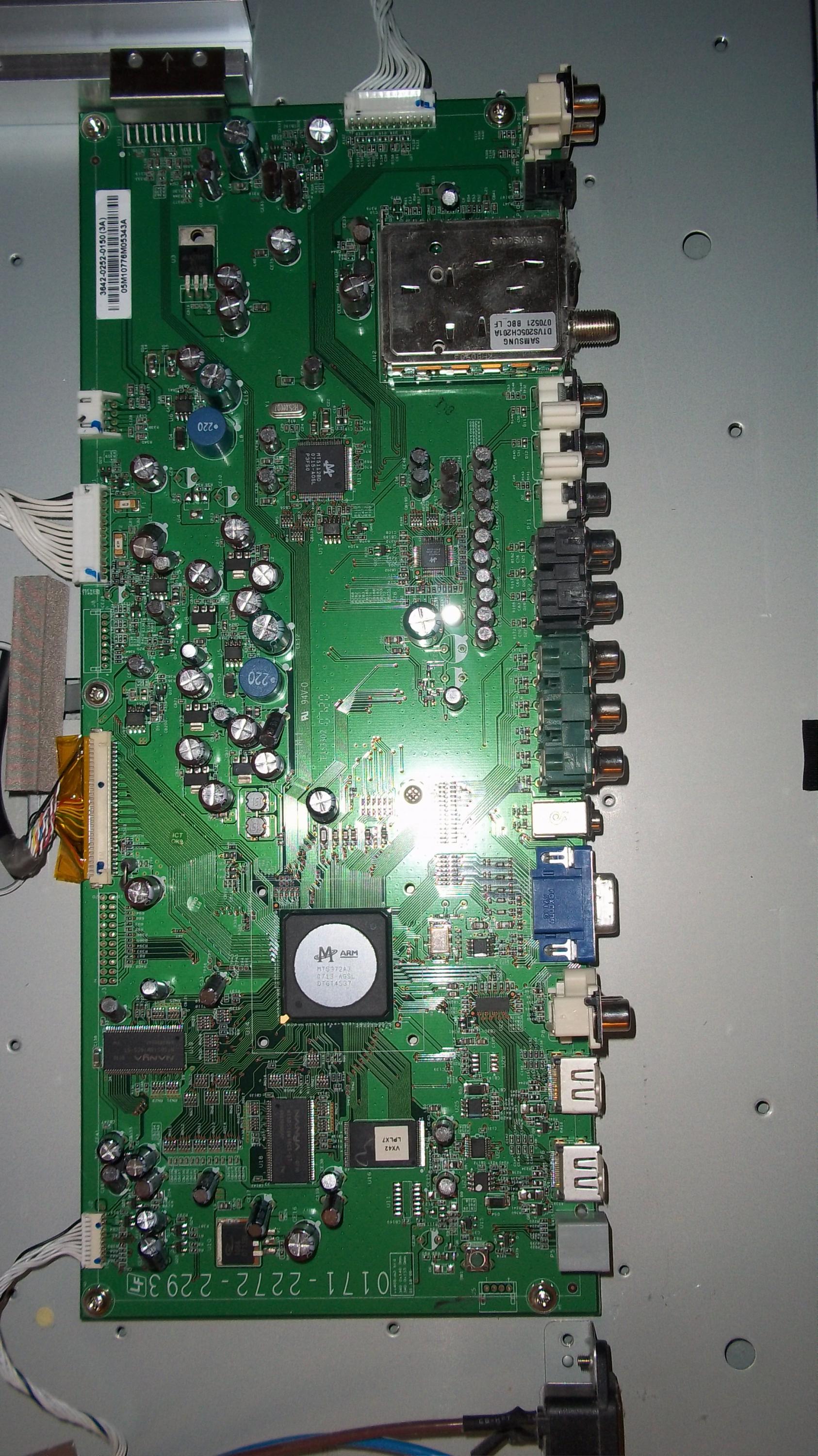

    Hi, I have been searching the web for answers to my problem. I was given a vizio vx42L lcd tv that previous owner said made a little pop or click and then it would not come on.
    I checked it and found the fuse blown so I replaced that and as soon as I plugged the power cord in it it flashed/smoked, and popped. I looked the power board over and found the fuse still good but a blown resister near the main transformer. I have a pic as good as I could take, to show the smoky board and the resistor culprit. Oh, the resistor and the burn mark is near center to left of the blue thing.
    Question, could the resistor be bad alone, or might there be a worse case situation? is it cheaper to just replace the power board? I have a dynex 42" lcd with no screen, does anything interchange with this set? And how cheap can I replace stuff...I am on very limited budget, part time work.
    Any help, suggestions, ideas?
    Jim
    Re: vizio 42" lcd power board issue

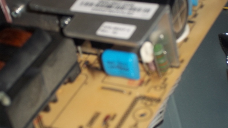

    The resistor is in the circuit to limit the current flow through the circuit. In your case, it burnt up because the device (MOSFET, Diode, transistor, etc.) it is connected to is shorted out. You can try troubleshooting it down to component level or replace the whole module.
    I do not know your experience in troubleshooting, and more likely you will not have the diagram for this power supply, so if you want to fix it, we will need good clear pictures of both sides of the board.
    Replacement board is about $65.
      I will take the pictures...I cannot get any power to the board, not that I know about. I have only a multimeter, and limited experience of soldering. My dad was the technician. maybe I can find a replacement board, but I still will try to keep this cheap as I can and work with you. thanks.

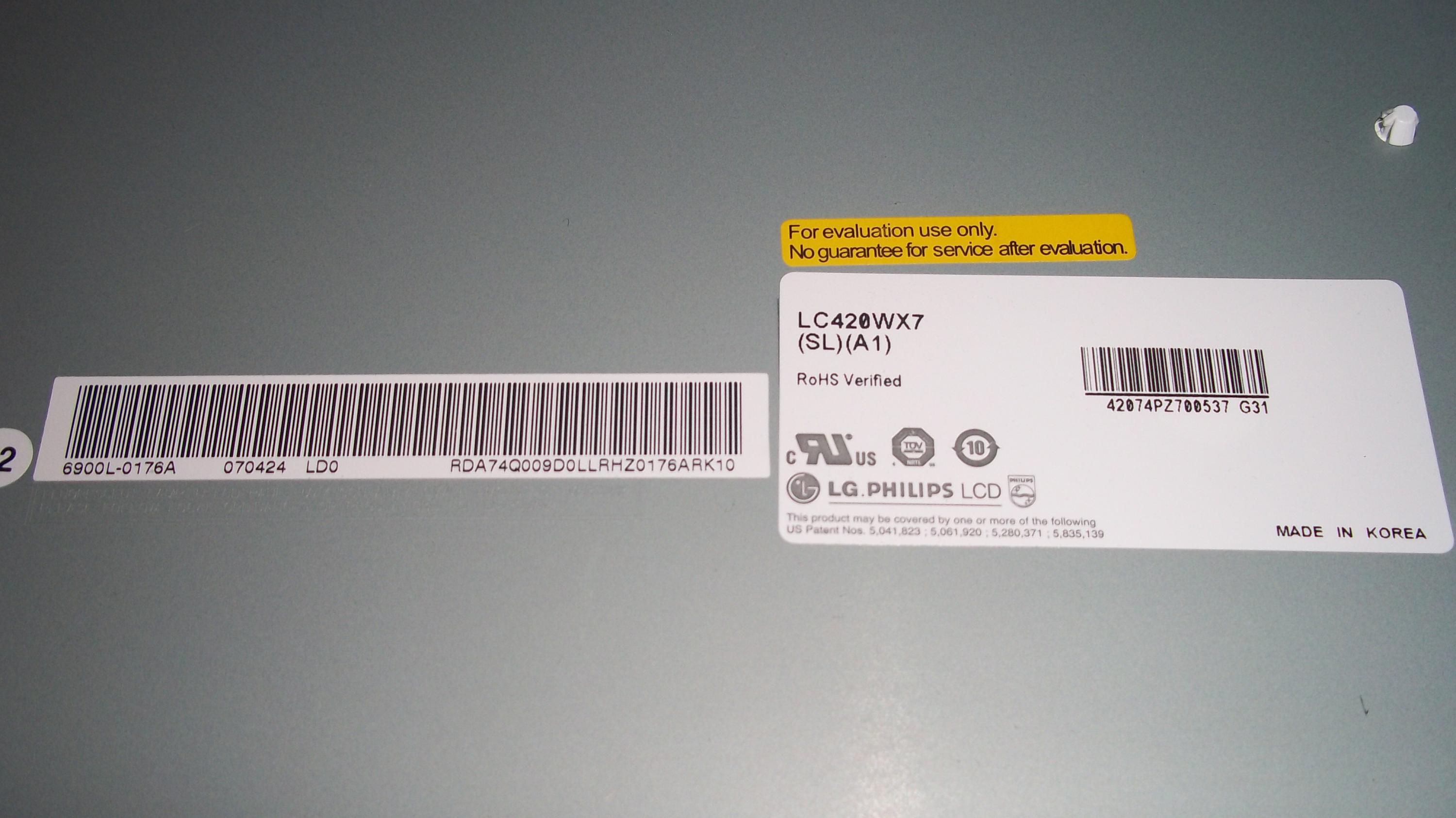

        now for the big question...I have a 42" lcd dynex tv...same year but the screen was broken. Is it possible the 42" screen from this vizio will work as a replacement panel for the Dynex? I thought I had heard there were only a couple of lcd panel manufacturers. I am hoping, if anyone knows.
          Look at the stickers on the back of each panel and see if they are the same.

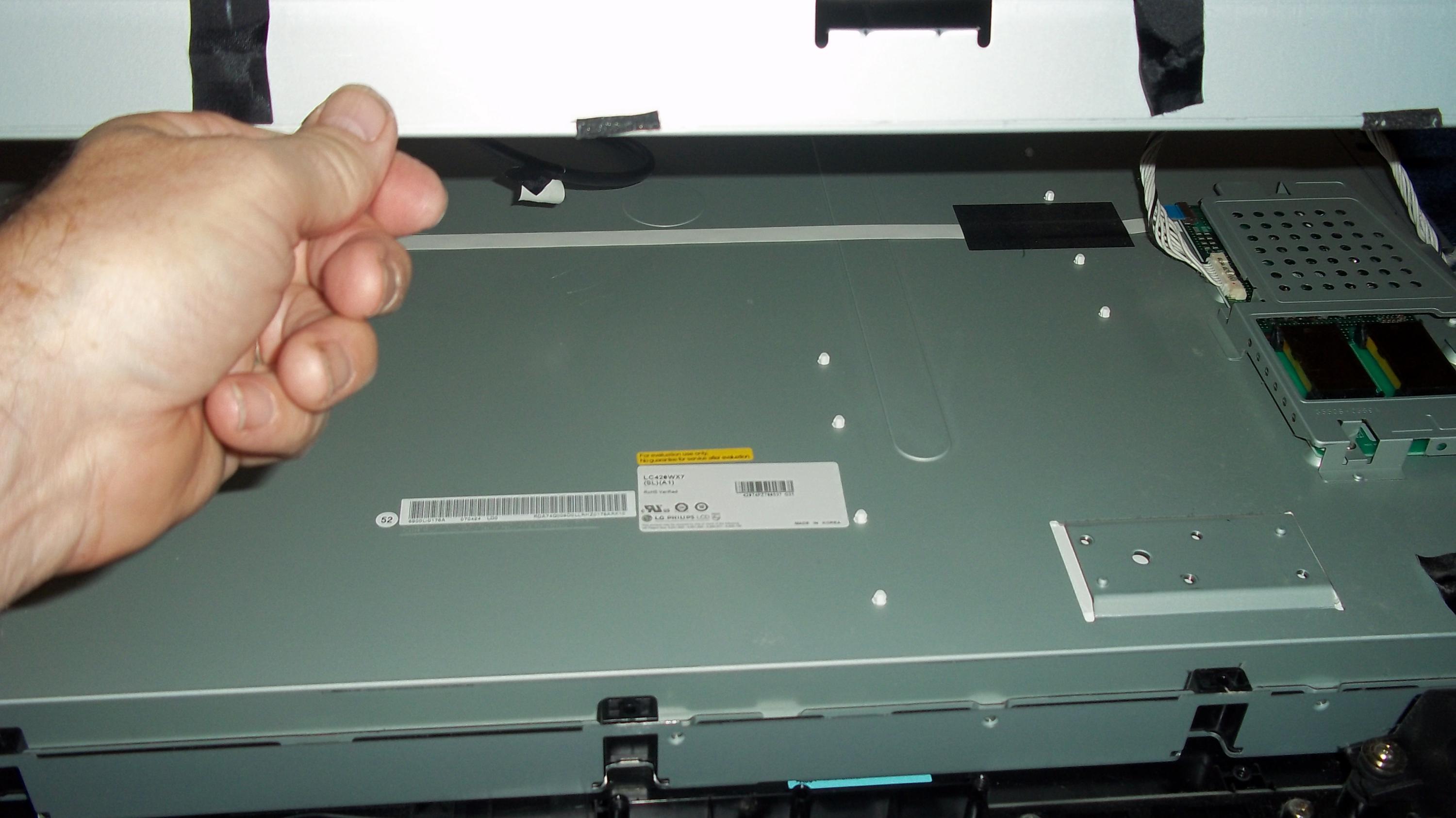

            this is what i get when I open the vizio tv...I think it is a lg model LC420WX7..is that the lcd panel number? I will go get the other dynex tv and check it out too.
            • Mr Bill
              • Nov 2011
              • 648
              Yep, it's a LC420WX7(SL)(A1)
              If the panels don't match you could sell dynex boards on ebay and then get a power supply for your vizio.
              • nukid
                • Oct 2012
                • 31
                Well, they don't match....grrr...but was gonna throw it away..so I will advertise on ebay. Thanks for suggestion.
                          if it's a 3 pin i would check pins 1-2, 1-3, 2-3. Post a picture and the numbers on it if your still unsure.

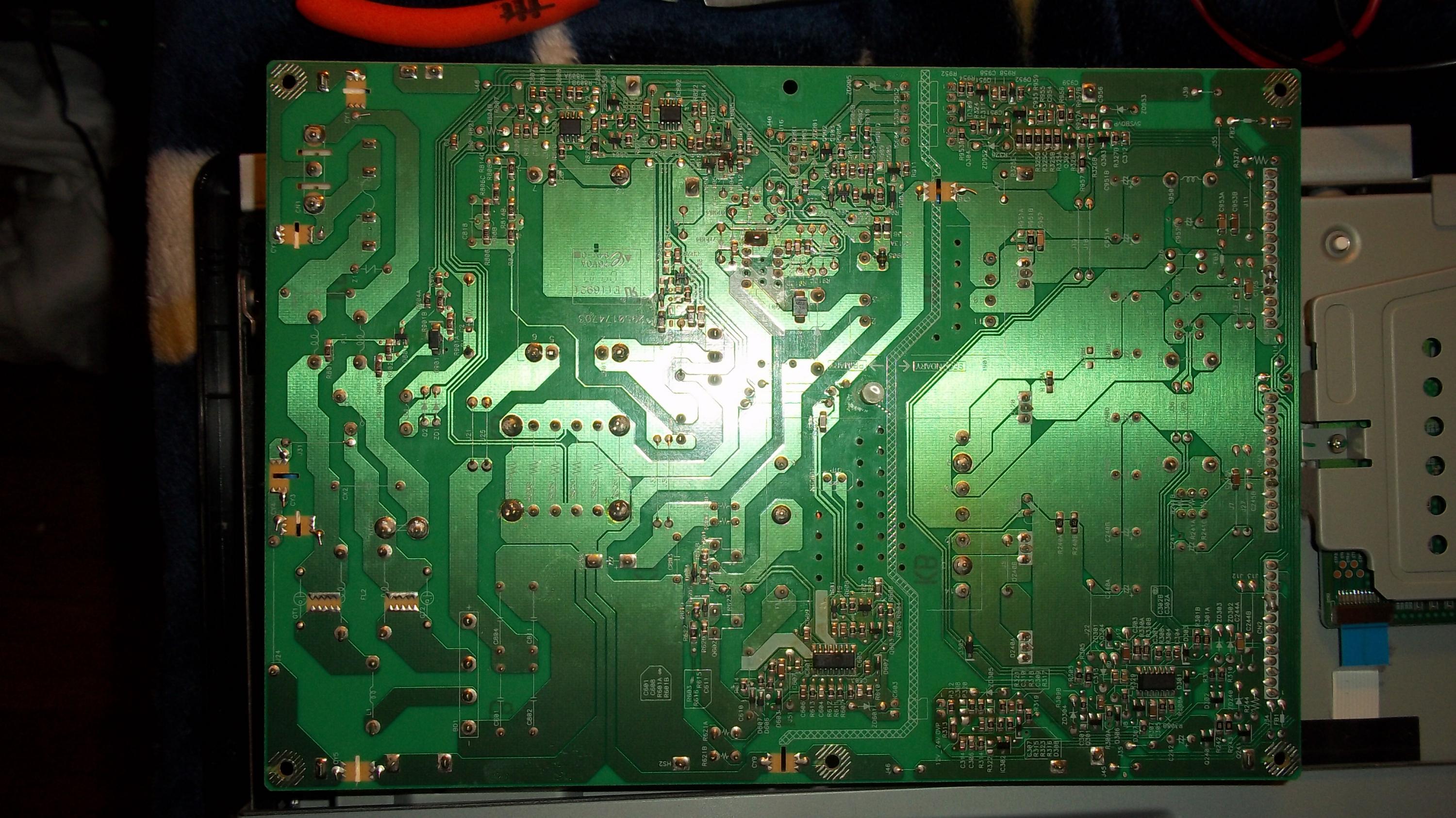

                                well, I put in a board I bought from ebay and plugged it in...no sparks at least. but no power either. It does nothing. I guess I gotta check voltages somewhere now, huh? Moving this weekend so it may wait till I have moved. but...where do I check? thanks for all the insight so far.
                                Jim
                                  You need to see if it is at least putting out standby 5VDC.
                                    where do I check the 5 volts at? I do know that there are no lights anywhere. I tried to check the 24 and 12 volt pins but got zero. supposed to be a good board, but who knows from ebay.
                                      if no lights you are prob not getting 5v stb,
                                      Using the chassis as a ground just check each pin for dc volts. 5v stb should always be on.
                                        well, I just checked and found I do have 5 volts at the pins on one of the ps plugs going out to the main board. Only 4 pins have 5.1 volts, but no other pins have any power at all.??? now what?
