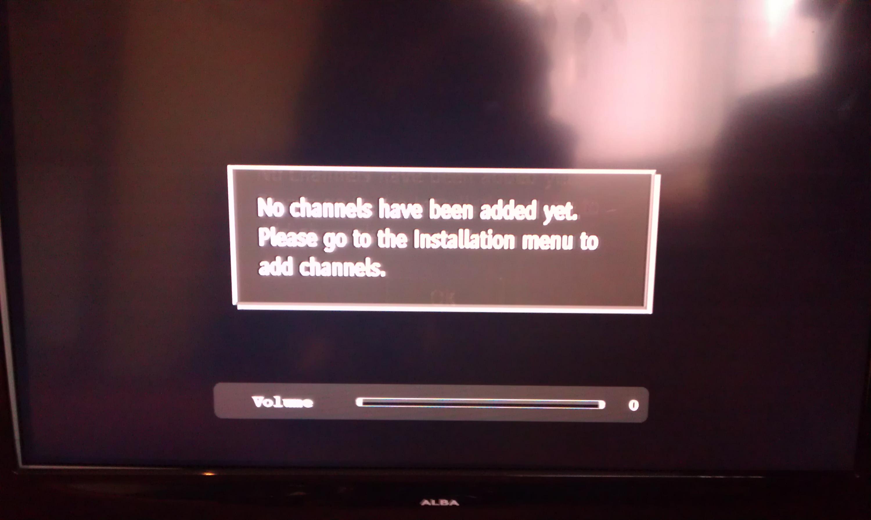

    Hi guys me again.
    I have been given an Alba LCD32880HDF it turns on backlights come on, then blue screen with channel number etc, but the volume bar comes on and the volume is going down without touching any buttons, Then the screen just goes blank, but it has sound so i'm told. No source has been connected to confirm this. Do you think it may be the main board that is faulty? as the screen stays on for varying times the longest being when it is first turned on.
    I have noticed that the large chip on the board does get quite warm even in such a short time.
    Any help would be much appreciated, Thanks in advance.
    Neil

                            right guys quick update for you after having a fiddle when i came home i found that if you turn it on with the number buttons you get this screen. It will sit there at that screen for ages no problem so im guessing it is not power supply problems or am i wrong? it will also bring up another one if you try to change channels that has an ok button on it at this screen you can adjust the volume but the menus only flash up for a second then go off again.
                            Any thoughts?

                                slight problem menus don't stay up long enough to do anything. Just flash up then disappear.
