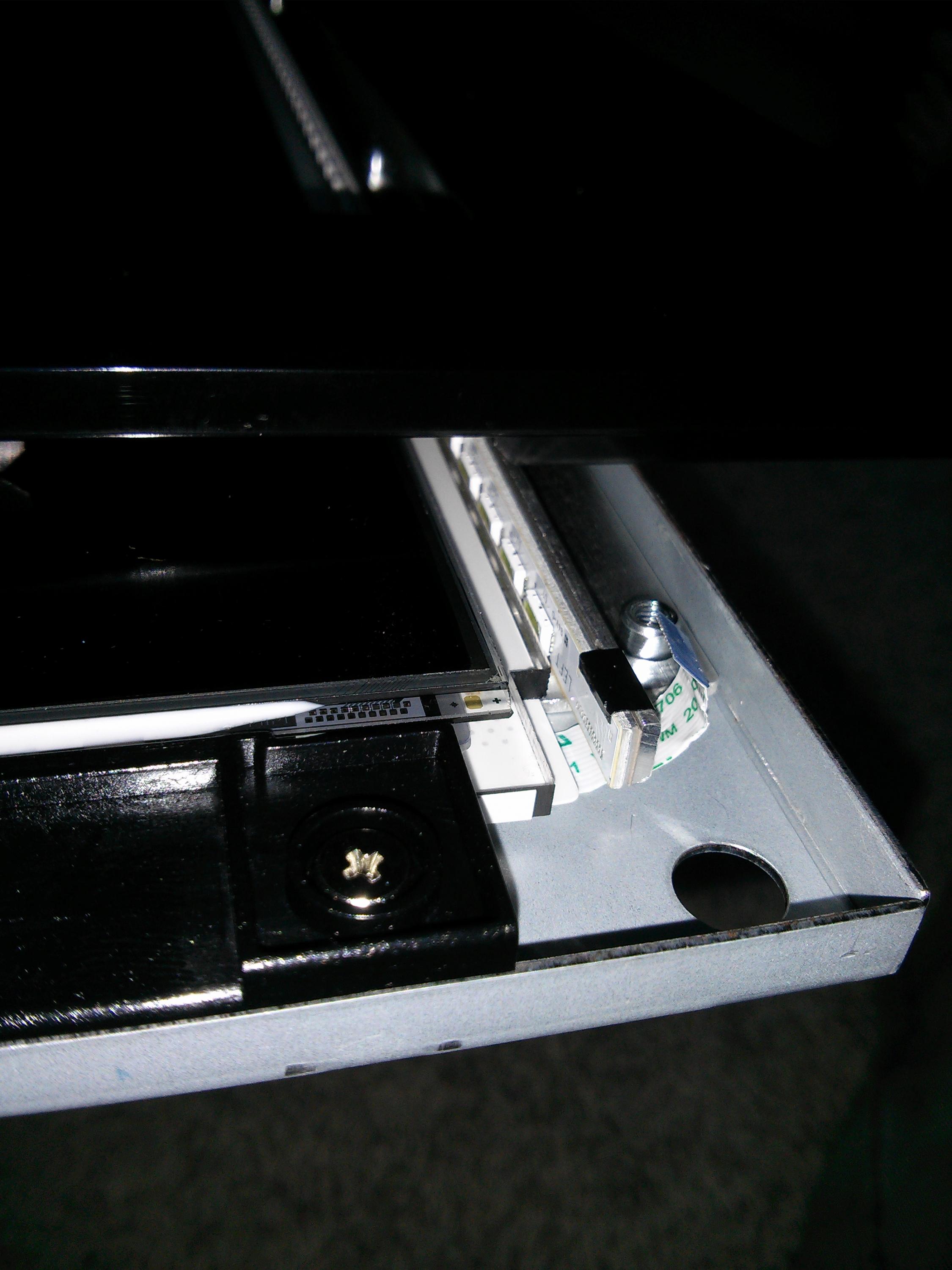

                            I need some more help, earlier today I posted how the tape fix worked. In an attempt to add tape to the other side to avoid future failures the entire lock for the ribbon cable fell off the led strip. I'm killing myself right now as 20min ago I had a 100% working TV. Is there anyway to connect the ribbon cable directly to the strip or is there a place to buy a new led strip? Please help

                              #114
                              Re: Westinghouse LD-4655VX - My First LED
                              That happened to me, had to rely on some Gorilla tape to hold it in place.

                                #115
                                I tried holding the cable in place with my hand and couldn't get it to power up. So you didn't have any of the clip at all and were successful at taping the ribbon cable directly to the led strip? if you see in the pics there is barely any points of contact left. Thanks

                                  #116
                                  In my case the locking tab broke off, I can't really tell where it's supposed to be in the pic. Did the whole connector break?

                                    #117
                                    Yeah, the whole connector is gone. Bare metal with 12 very small points. I believe its done.

                                      #118
                                      Yes that would be very tough if not impossible. If you're really good at soldering you may be able to scrape the end of ribbon to expose the traces on top and try to solder it back on but that's a long shot.

                                          #120
                                          Originally posted by johnboy1313
                                          I called about that one Saturday morning. It was either drive to Antioch for that one or Tinley Park for a 60" Sharp. I chose the 60" Sharp. Though when it's all said and done, I may have had more opportunity for profit with the Westinghouse. Was the seller able to locate the base for it?
                                          Yes he found the stand.
                                          Originally posted by misaacs6516
                                          I found the cable to be chewed up as well on the right side where it connects to the led strip, I removed it and cleaned it then added a small piece of electric tape to the aluminum to keep the ribbon cable from touching it and viola!
                                          Electrical tape alone won't hold up unless you cut the plastic above the cable to prevent it from pressing down on the ribbon.
                                          Why people are ordering replacement cables? There's plenty of slack on the originals to repair the damaged area.
