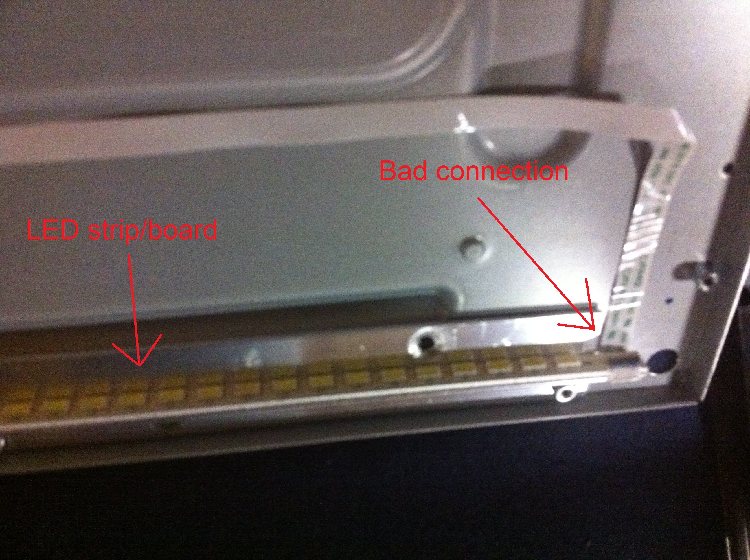

                    #29
                    Re: Westinghouse LD-4655VX - My First LED
                    ok so I got it all figured out. sorry for the delay, I set this thing to the side for a bit while I worked on some other stuff. So, the good news is, I fixed it and did not have to buy any parts. Bad news, I have never had to strip down a tv to this extent in order to make such an easy repair! I had to take this thing apart to bare bones. Front panel has to be completely taken apart until your left starring at a sheet of flat metal. Its ridiculous. So to make a long story short (see the pics at the bottom, and sorry for the poor quality...) the ribbon that plugs into the LED strip for some reason just wasnt getting a good connection. I simply unplugged it, stretched it out a little and plugged it back in, making sure it was solid and then turned it on. Bam. The previously failed LED strip came on bright as day. Now I'm getting ready to put it all back together. I hope this works for you. Also, as someone mentioned earlier, the ribbon did seem to be kind of chewed up which is strange but we'll just chalk that up to poor craftsmanship on the part of the fine people of Westinghouse Let me know what happens on your end and let me know if you have questions. Good luck!
                      Thanks for doing this and the shots are of decent enough quality. I will attempt to repeat this when I get some extra time. Maybe over this 3 day weekend. Glad you got it fixed, hope the same works for me.
                          yep, there are two, one on the left and one on the right that run right underneath the panel
                            quick udate, i just ordered a new ribbon cable. I ran the tv all day, then put it all back together and it went out again. Same cable. I should have left it taken apart!! Oh well, a ribbon in good shape should take care of it
                                          Here's ribbon I used:
                                          http://www.ebay.com/itm/AWM-20798-WF...#ht_1109wt_920
                                          I had other problems, the locking tab in the lower left corner where the ribbon attached to the LED's broke, and I had to rig it so it would stay put.
                                          Also the original cable routed inside the panel and then back out the bottom. I chose to go directly from the main board to the corner on the backside.. Don't think it would have been long enough the other way..
