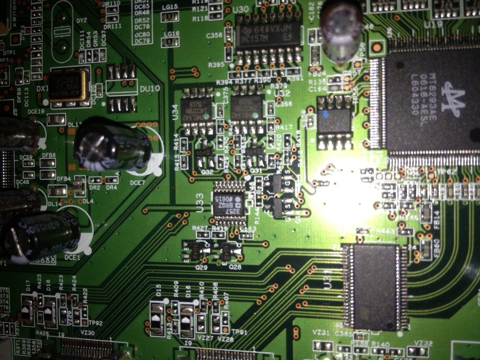

                  I located what I think is the U33. How can I test this? If this is whats bad, this is testing my skills on soldering...

                    Have you posted a picture of your main board?

                      Re: Vizio GV42L HDTV amber light no pic only clicking rapidly
                      Your board it's different.
                        The U33 on this board is not the LDO 3-PIN regulator IC like other chassis.
                        Can we see good clear pictures of the main board?

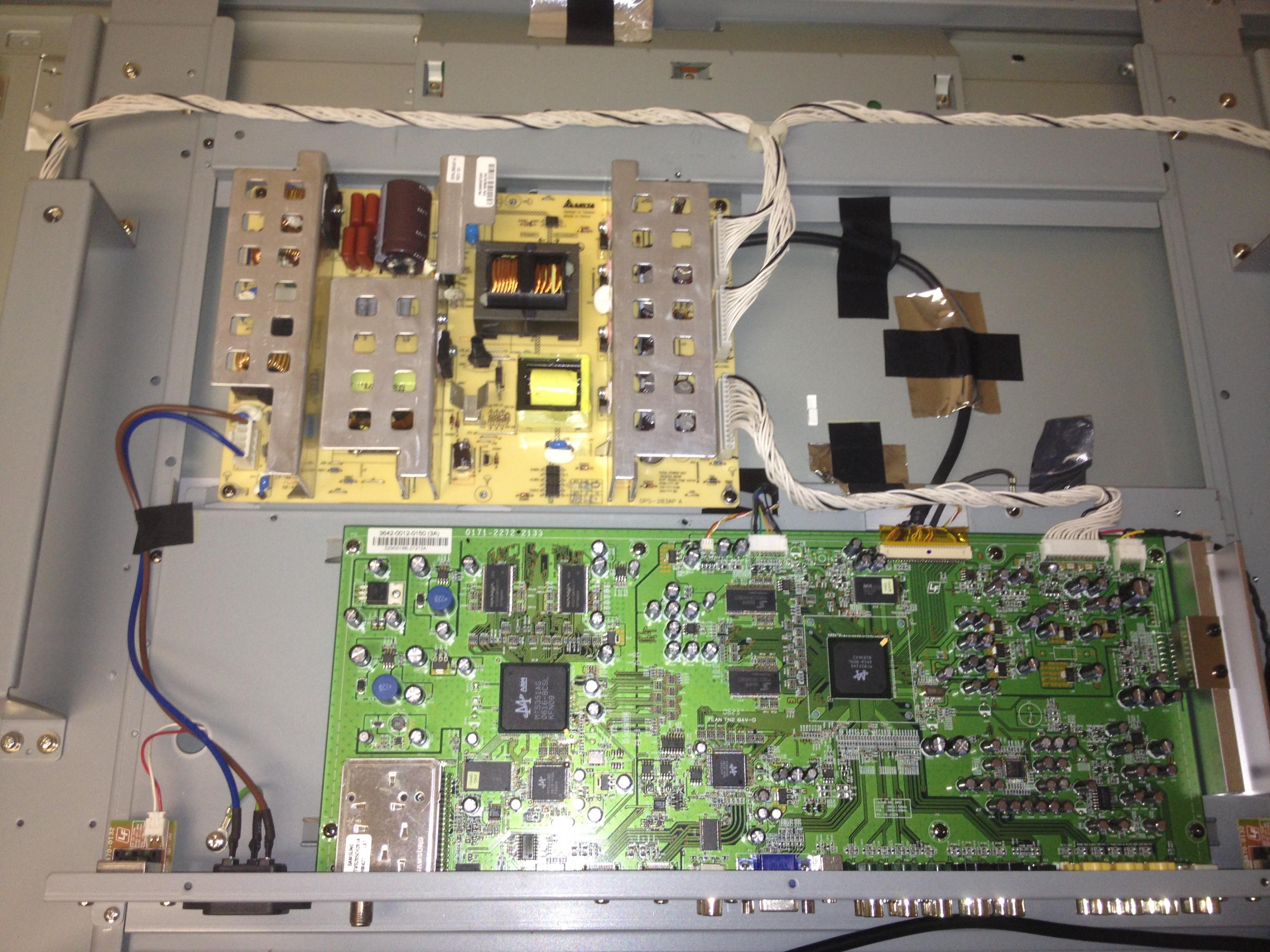

                            Attached is my TV board.

                                  @schwegy, I can see some 3-pin LDO on the main board. Can you post clear and focused picture of the main board alone?
                                  You can disconnect the top two white connectors that go to the Inverter boards and see if the clicking sound stops.
                                  By the way, where is the relay you replaced located?
