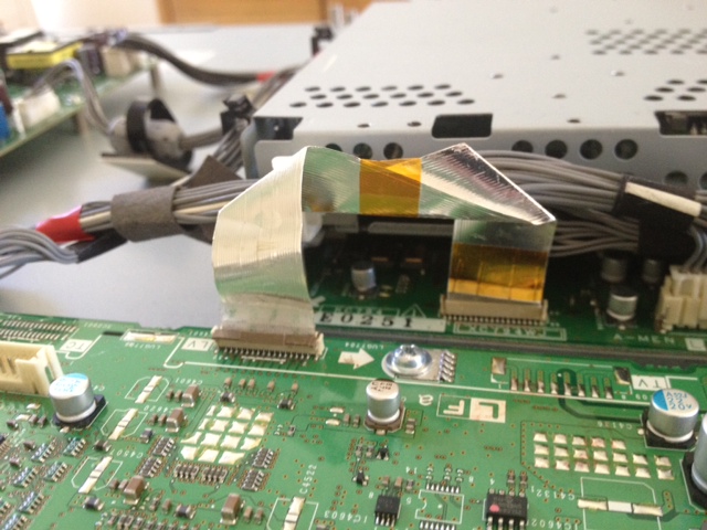

    I have a Sharp Aquious lc-34 series LCD set with a bad harness connection the LCD controller and the main board. Sharp doesn't sell this part but pretty sure they are available from folks like Digi-key. I don't know the name of this cable harness material. Does anyone know what it is called or a likely TV shop that might have the exact replacement?

    We really need the exact, full model number of the TV, and pictures showing the connector you are looking for, to be able to help you.

        Re: Help please need flat flexible 33 conductor harness
        Sure it is not LC-37D5U?
        I couldn't find anything, and digikey would not have that.
        But if I may ask, what leads you to believe the cable is bad? From the pic, it looks like it is just mis-seated (but I don't know if you just threw it in to show us location).

            The harness is now missing traces which were damaged during installation after taking the pictures. Before removing it for pictures, the video would intermittently be filled with noise and what appeared to be loss of sync. Just touching this harness would fix the issue so I knew it had been compromised during repair of another issue. Now there is no video with the additional damage. Thanks so much please keep looking and advise if a replacement part can be identified. Would really be happy to have one from a discarded Sharp of the same model.

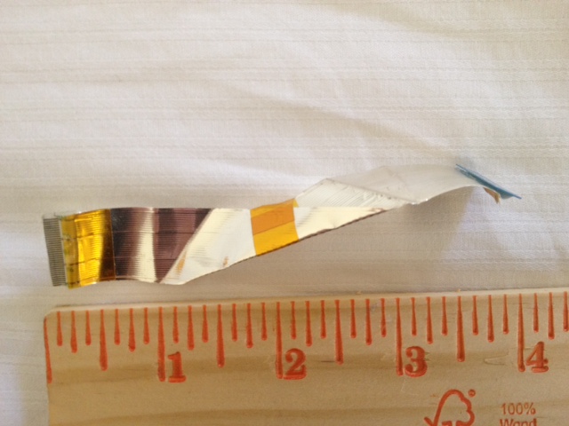

                    Can you take a better shot showing what the connector labels/position is. Is there a part number on the item?

                      Along with that picture, show the damaged part of the connector. We might can salvage the ribbon cable - worth a shot, nothing to loose.....I just messed with one of my spare ribbon cables and it's possible.

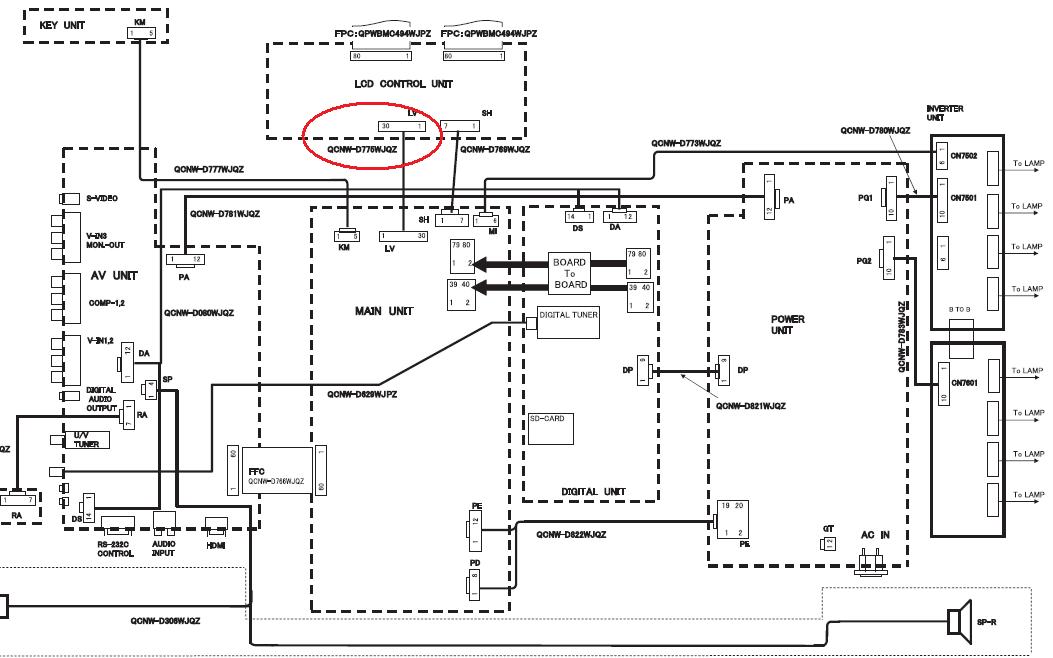

                        This is out of the DB5U manual. QCNW-D775WJQZ
                        Gulp at the price i saw if it this is it.

                          True, I have an LG plasma with a ffc and it does not like being pulled in and out. The ends started bending up. I got a safety blade and cut it back by placing it straight and hit it through to trim of the bad stuff . used a soft cutting board and a swift tap with a hammer to punch it through. only took off just enough and is Just useable!
                          If you can get more info, like how many connectors, width, and pitch you may just get lucky finding a ffc on ebay or something.

                              Of course Probably explains why if that part number I found is correct it is $68.

                                    Just realised after all this, your title said 33 conductor, so this looks to be of no use. this one shows 30 way. Bugger.

                                      Hey, thanks to all who had responded this far. I've tried the following so far:
                                      Searched eBay for one of the boards that are connected with this FCC or LVSD part, called various dealers in the So Cal area who sell used parts, called Sharp and called shopjmmy, and continue to shake all the bushes.
                                      I may have to make my own home brew 33 pin FFC from individual conductors between both board mounted connectors. I'll need to solder to each connector then add some type of Molex connector on each end of the wires soldered to each board connector. The Molex connector will terminate both of the pigtail SL that I can disconnect the two boards for future servicing.
                                      Did want to go this route, and still don't but hopeful some may have a better idea or is able to locate the exact part.
                                      I was in hopes of cutting the damaged ends and scrape off the insulation to expose virgin connection surfaced but I can't remove the baked on protective coating. The ends of this FFC assembly are flat not round wires , which I'm not certain I can overcome if I make my own harness
                                      Please feel free to offer suggestions or possible sources for the original part that was never offered by Sharp as a replaceable part.

                                        I think if you take the existing and cut it just past damaged point, then take like an exacto knife and just take your time and scrape off one side (the side that makes contact with the connector pins so it'll still be in firmly in the connector) it'll work. You cannot separate the individual wires though.
                                        I can demonstrate if you wanted me too.
