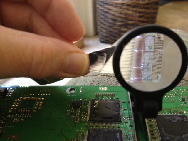

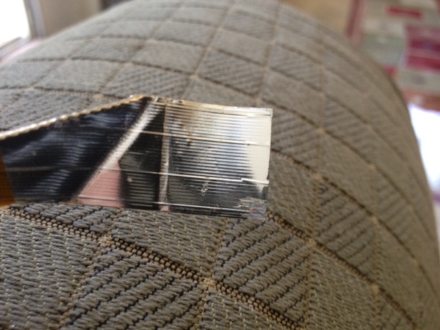

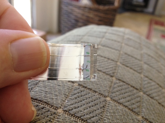

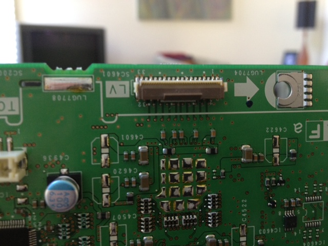

          Here are some pictures of the damaged cable and a picture of the board where the mass termination FFC cable connects to one of the two boards. Note the through holes in the board behind the connector. 10 of the total pin connection are ground with one ground preceded by two signal pins. This pattern is repeated for all pins within the connector/FFC interface. The through holes would allow 28 Ga solid wire connection if I have to go individual wires to replace the FFC. Much thanks for all responses!!

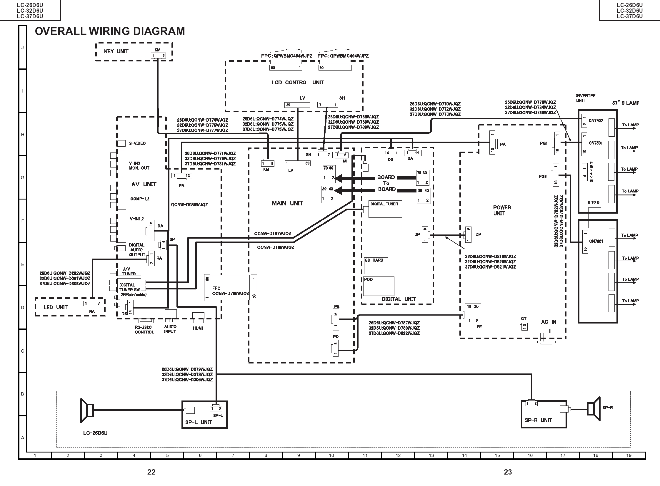

              This is out of the DB5U manual. QCNW-D775WJQZ
              Gulp at the price i saw if it this is it.
              Service manual for the LC-37DB5U

                I found the Manual for mine, here is a copy of the page the part is on. Looks like it may work.
                • Worminizer
                  Telephone Guy
                  • Aug 2012
                  • 51
                  Re: Help please need flat flexible 33 conductor harness
                  The 27" is different, but the 32" and the 37" are the same as yours.

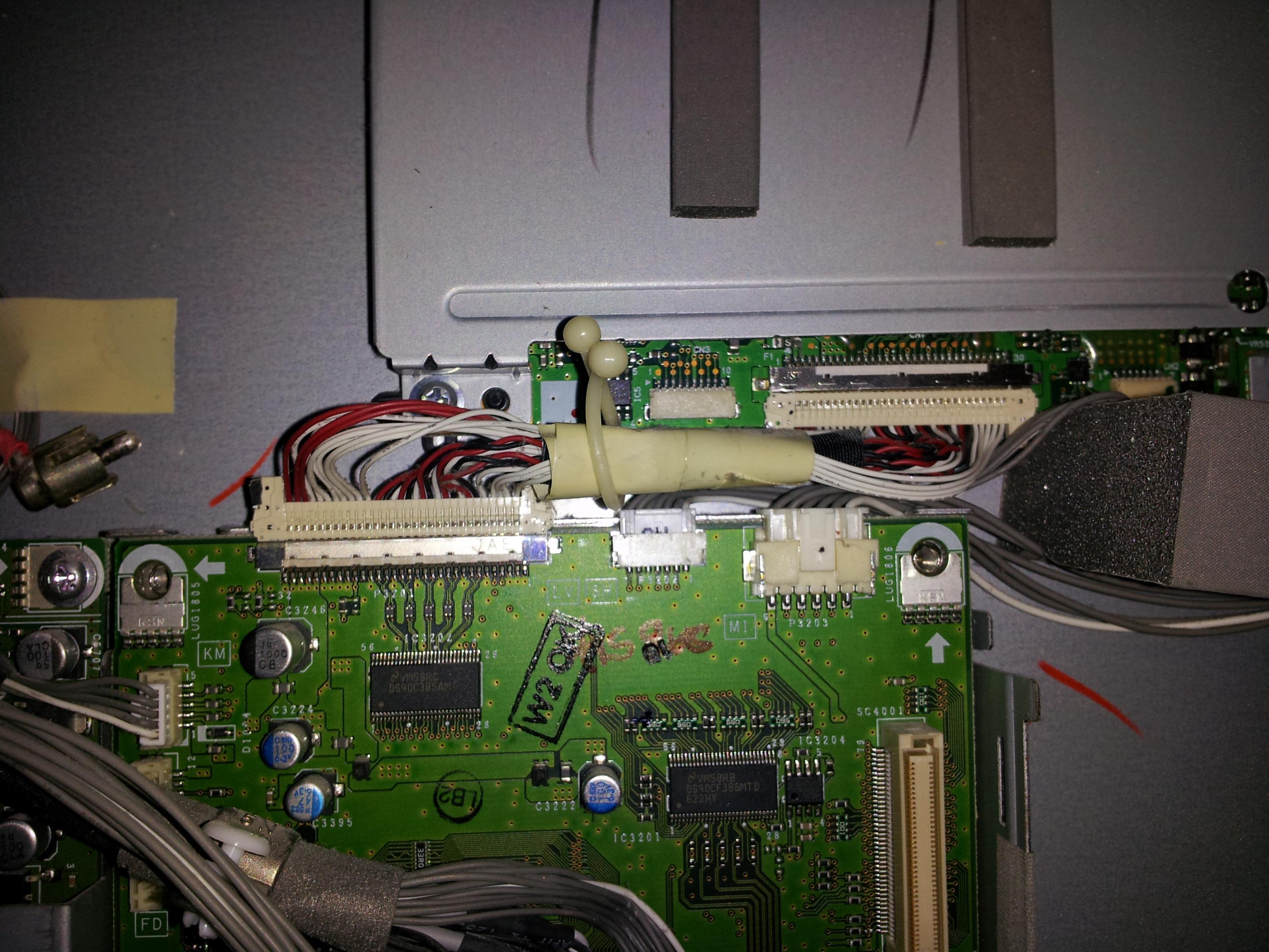

                    I'm going to go lug that tv into the house, and rip it apart. I will post a picture of the cable when I get it out.

                      Ok, the harness labeled LV in mine is not a ribbon. It has molex plugs on both ends and I've attached a picture of it. I'm not sure if they used different ones in different chassis, but this is definitely not what you need.
                      At least this gave me the motivation to part this thing out.
