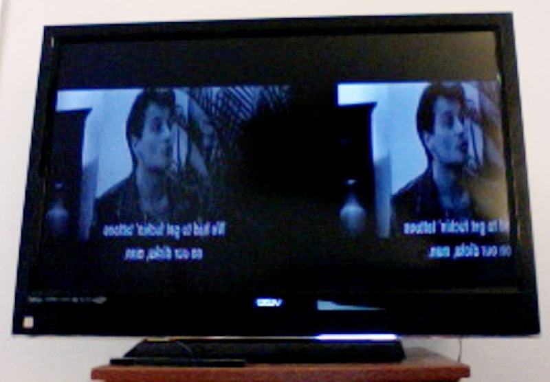

    I'm thinking of picking this TV up, but I would appreciate any input of what the problem could be. T-con?
    Re: Vizio VO42E possible purchase
    Could be t-con or main. Looks like it might be 1080p LCD, but with 720p input (perhaps wrong panel setting?)

      Vizio logo is backwards did they take the picture in a mirror??

        I have asked her to make a better/bigger picture with the menu on the screen and this is what I have got from her, actually I had to double the size to be able to see something.
          Yes need to see if you get the same with the on screen user manual, that will eliminate external source not sync with the video processing inside the TV.

            False alarm. It was the DVD player

              The video output of the DVD player was set to 450p and the composite video output jack (Yellow RCA jack) is used instead of the RGB Video output RCA jacks, hence double images.
