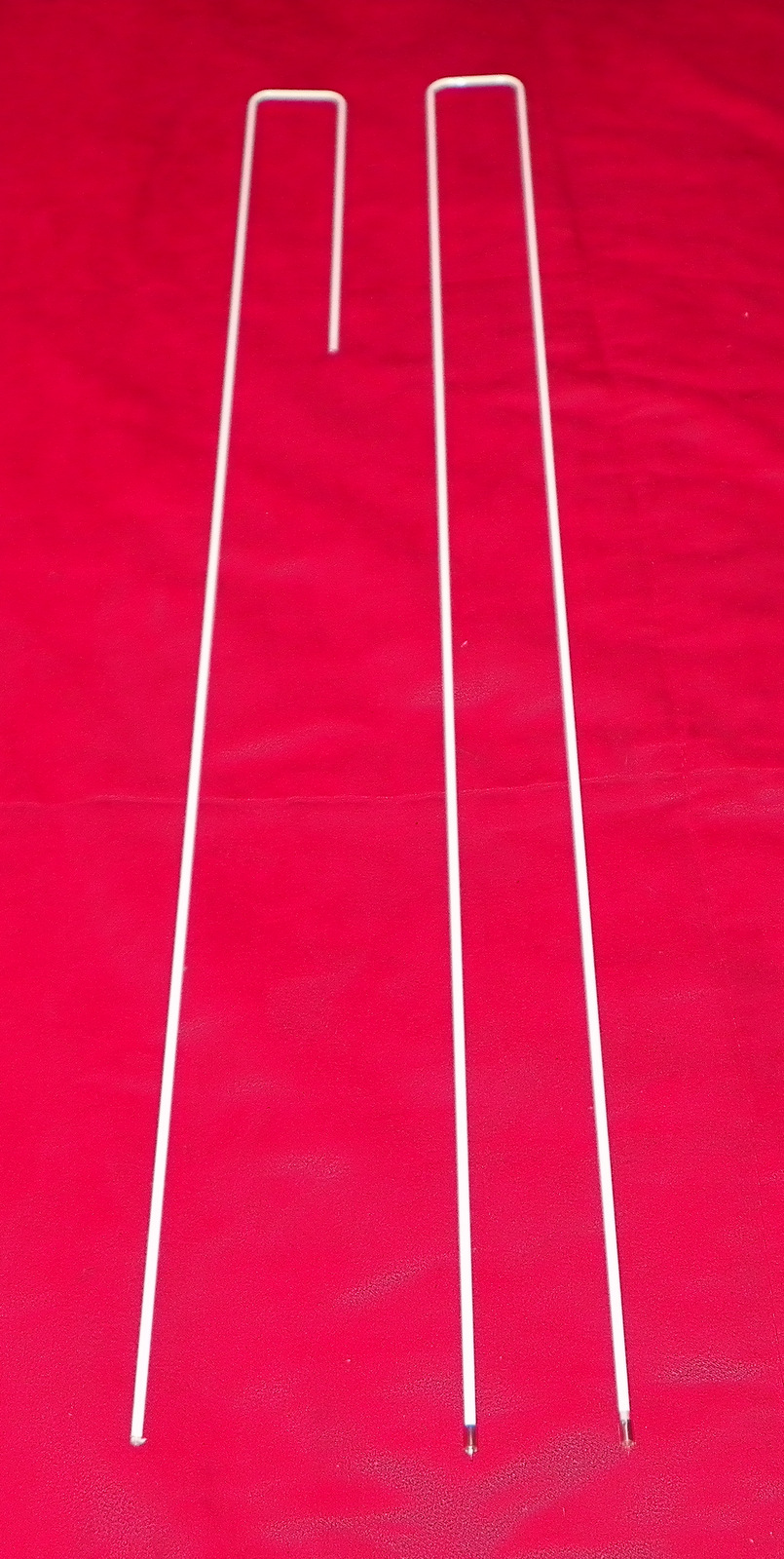

    Once inside the LCD screen I found one broken U shape CCFL back-lamps. I have other E321VL with a busted LCD screen but this LCD screen have single straight CCFL tubes inside. Not having the exact U shape CCFL, I temporary used 2 straight tubes replacing the broken U shape CCFL. Now the TV stays on and is working with no problem.
    My question is would you leave this fix as a permanent fix or should I try to hunt down the U shape CCFL?

    Could you please post a picture with this U shaped setup? I have never seen one. We can learn from this for the future.

      ok I will later tonight

            I decided to hunt down the original CCFL and I found a seller on eBay
            ( rescued-parts) who had the lamps in stock.
            I uploaded a picture of both lamps, one is broken and the replacement from eBay seller.
            Now the LCD TV is back working.
