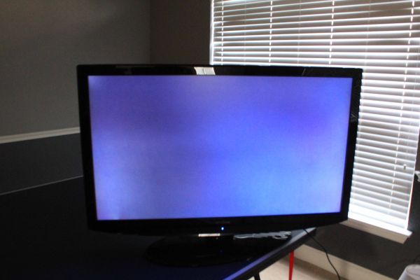

    wanted to see what you guys think if it is a good deal for 50 dollars and what could be wrong with it by picture .thanks
    Re: 47 insignia lcd tv
    That is a good deal, the main board, power supply board, the inverter board, and the stand total are worth more than $50.

      Could be as simple as a bad voltage regulator on the mainboard. Worst case, one of the chips on the mainboard is fried.

        thanks for feedback will buy it.will post pictures soon as i get it .

          Well bought the tv unfornately I think I might have a bad panel one of the tcon ribbon gets hot and starts to burn ribbon strip.I tried another ribbon did the same thing it is the left side the rights seems to be fine.will post pic in few phone won't allow it

            what panel is in it? Had a westinghouse 47" that had the "glowing black screen" and the panel was the fault.
