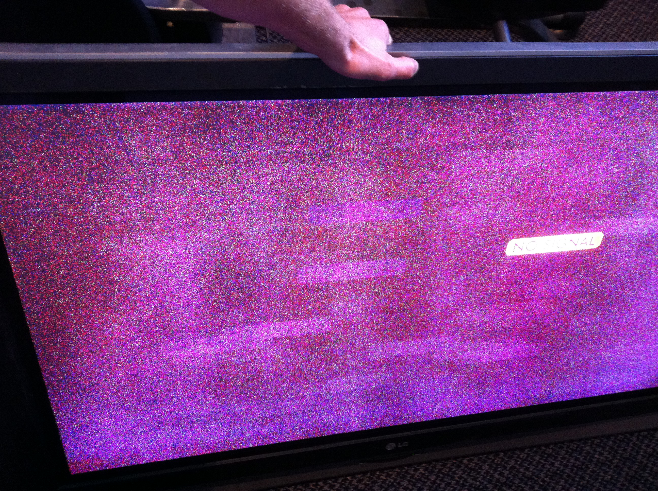

    Plasma 2 : LG 50PC3. This one powers on but image is pinkish with snow on it, it really doesn't look good. I see a no signal logo floating around that leaves some marks of it when it changes position. Here is a picture of what it looks like, see image attached. Only thing ive seen on the y-sus are the 2 resistors also shown on attached image, replaced them from another board. No change !

    The second one is either Z-sustain or more likely someone who has tweaked around too much with the adjustments on the Y-sustain and messed it up! It should be fixable with a multimeter.

    Adjustment procedure for TV #2:
    - Test Vs voltage. It will be indicated on the panel sticker - around 190V. Check it is within 0.5V of this. If it is not, adjust it until it is.
    - Test Va voltage. Use the same procedure, around 65V. Adjust it until it is within +/-0.5V.
    - Test Vsc voltage. This is usually across a resistor on the Y-sus; post a larger image of the Y-sus and I'll point it out. Typically 190V. Adjust to within +/-1V.
    - Test -Vy voltage. Similar to Vsc but negative, around -190V. Adjust to within +/-1V.
    If all of these are in spec, suspect Z-sustain.
    If not - Now you will likely have an acceptable picture but with some sparklies (flickering picture) or image retention - here is where it gets tricky. Basically, the get rid of sparklies, turn SET_UP clockwise until they either reduce or get much more significant. If they get more significant go the other way. Then, try tweaking SET_DN if you still can't get a perfect picture.

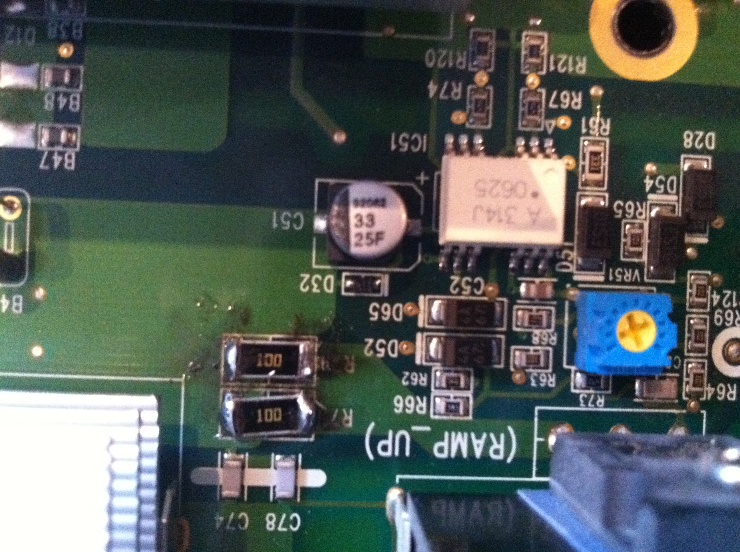

      Here is a better picture attached ! I adjusted a little bit the VS and VA, but it was within spec.
      Do you have a clue what caused those 2 resistors to burn on the YSUS ?

          Generally the "SUS" IPM fails more often, but you may have to replace both, which is difficult/expensive... I don't have enough experience with LG plasmas to say whether both need replacing or just one. A better option may be to find someone selling used Y-sustain boards, or someone rebuilding them.
          Can't see any burnt components on your Y-sus. Can you highlight them?
          On older LG plasmas, the -Vy was tested across a resistor. Let me check if I can get the service manual which explains where to check.

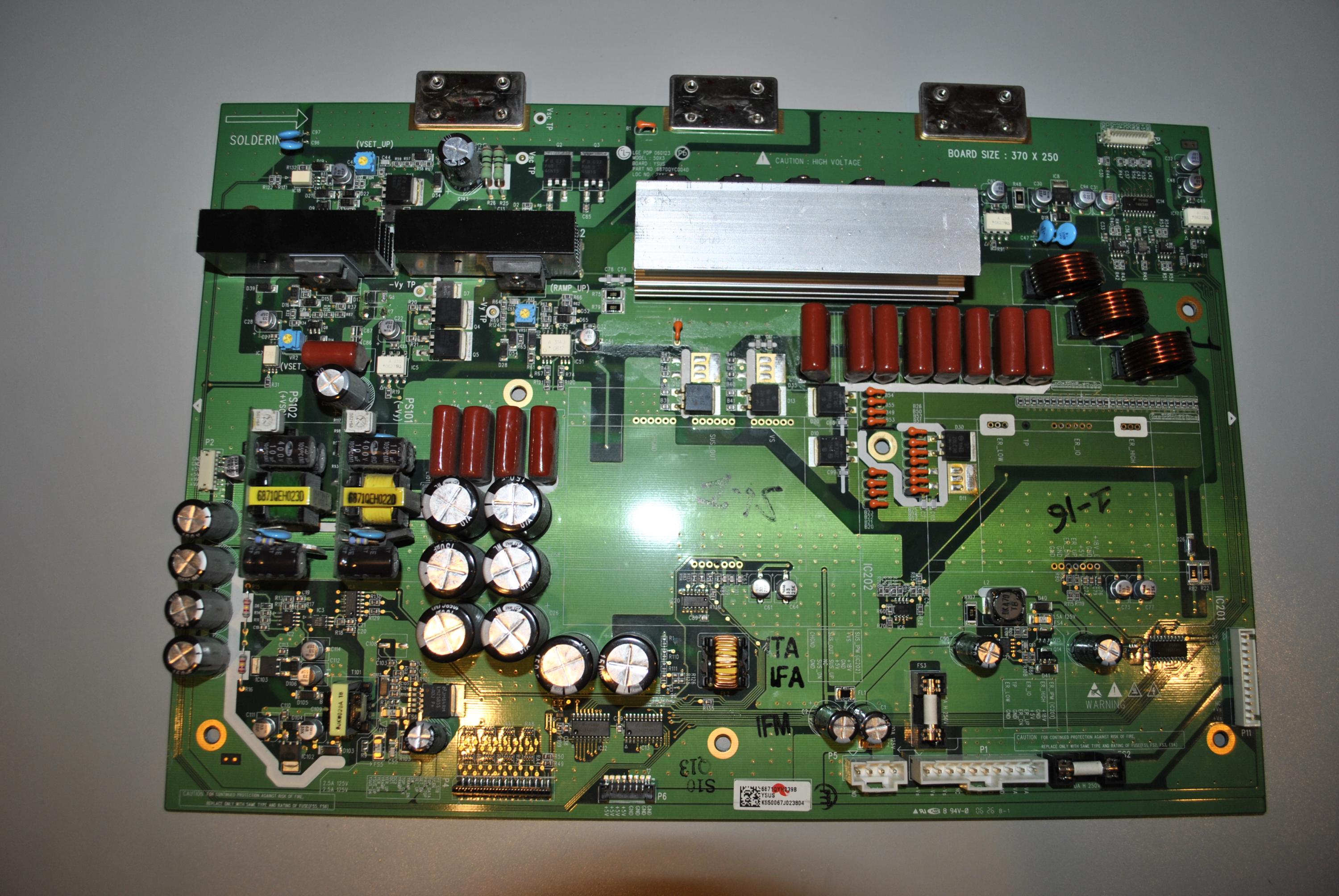

            This is another y-sus board i have here from 1 of the 3 tv's on which i removed the IPM's.
            The 2 burned resistors on tv #2 are just left of the big heatsink, marked 100, R75 and R79.

                Check the fuse on the board. Looks like you will be looking for three Y-sustains if you can't find the IPM or find it costs too much...

                  Ok, found that one. One of the fets, the one on the right black heatsink, is shorted ! Prolly the cause of the 2 burned smd resistors. So far, one ES1G smd diode and 1 102 smd resistor open in that area. I hope not too much is burned, but the FET was def. shorted and caused a little damage there.

                    I see the burnt resistors you talk about. Those control SET UP which manages the initialisation of the PDP. If that goes wrong those symptoms (lots of misfiring pixels) fit well.

                      Swapped 2 resistors, 1 fet, 2 diodes from donor board. Wondering if i should try it now :/ Checking to see if i missed anything..
                      Well, after putting it back in the unit, the 2 100 big resistors near the silver heatsink burned again. It seems they're acting like a fuse with my issue, they're the first to go...
                      I've seen the magic smoke, and those 2 resistors burned again. Is there something else shorted that i'm missing to get them to burn ? I was also wondering if it could be an mis adjustment of one of the pots there, RAMP_UP, VSET_DN, -yv, VSC ?
