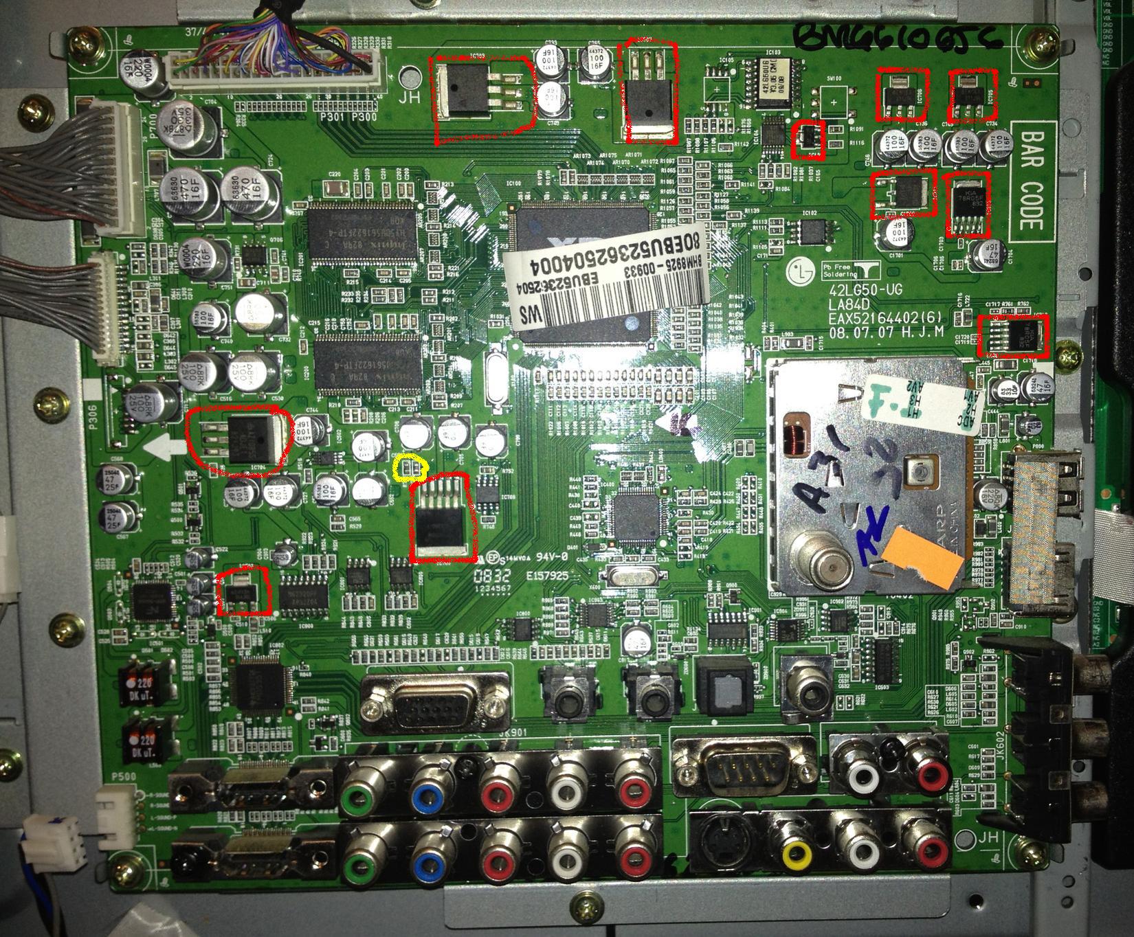

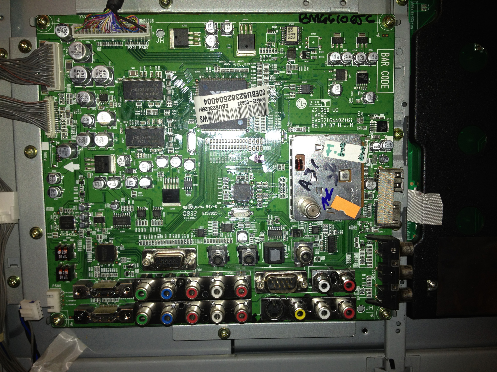

    I'm totally new to this so I'm sorta fumbling around as to where to go. I ordered a replacement power board, but wanted to see what else that I could do while I awaited it. In research, I found that often times a faulty main board is to blame, so I wanted to see if I could figure out if that were the case with mine.
    I went through the instructions located in this post and tested the voltage regulators on the main board. I have attached photos of this main board.
    QUESTIONS
    1. I'm hoping that someone can look over the results that I found, as well as the attached photos and datasheets, and let me know if I am correct in saying that IC704 is bad but that IC703 and IC707 are good.
    2. I had a hard time finding the correct datasheet for IC709 and was hoping someone might be able to assist me in determining if that is bad or good.
    3. Finally, I'm also wondering if I should have tested any other regulators that I did not test.

    Re: LG 42LG50 Won't Turn On
    Originally posted by craig34
    QUESTIONS
    Thanks for doing some research and homework first. It helps us when you use my format to post things.
    For IC704, look at line 2. It says ADJ. That tells you it is an adjustable regulator.
    For an adjustable regulator, the formula is pin 1 + 1.25V = output of pin 2. 1.384 + 1.25 = 2.634 (close enough to 2.62 => I use a +/- 1% tolerance).
    http://pdf1.alldatasheet.com/datashe...I5M-X.XTR.html
    Hint, your package is a TO-263-5 (page 4). Pin 5 should tell you if the output voltage on pin 4 is correct or not. In addition, I circled two resistors R116 and R117 (in yellow). Their values will help you determine with is the correct output voltage as the forumula presented on page 5 in the ADJ column.
    IC709 is left for you to check.
    Yes. Always. It is easy to check and only takes a few minutes. I count 11 on the picture (circled in red) with the possibly more on the backside of the board.

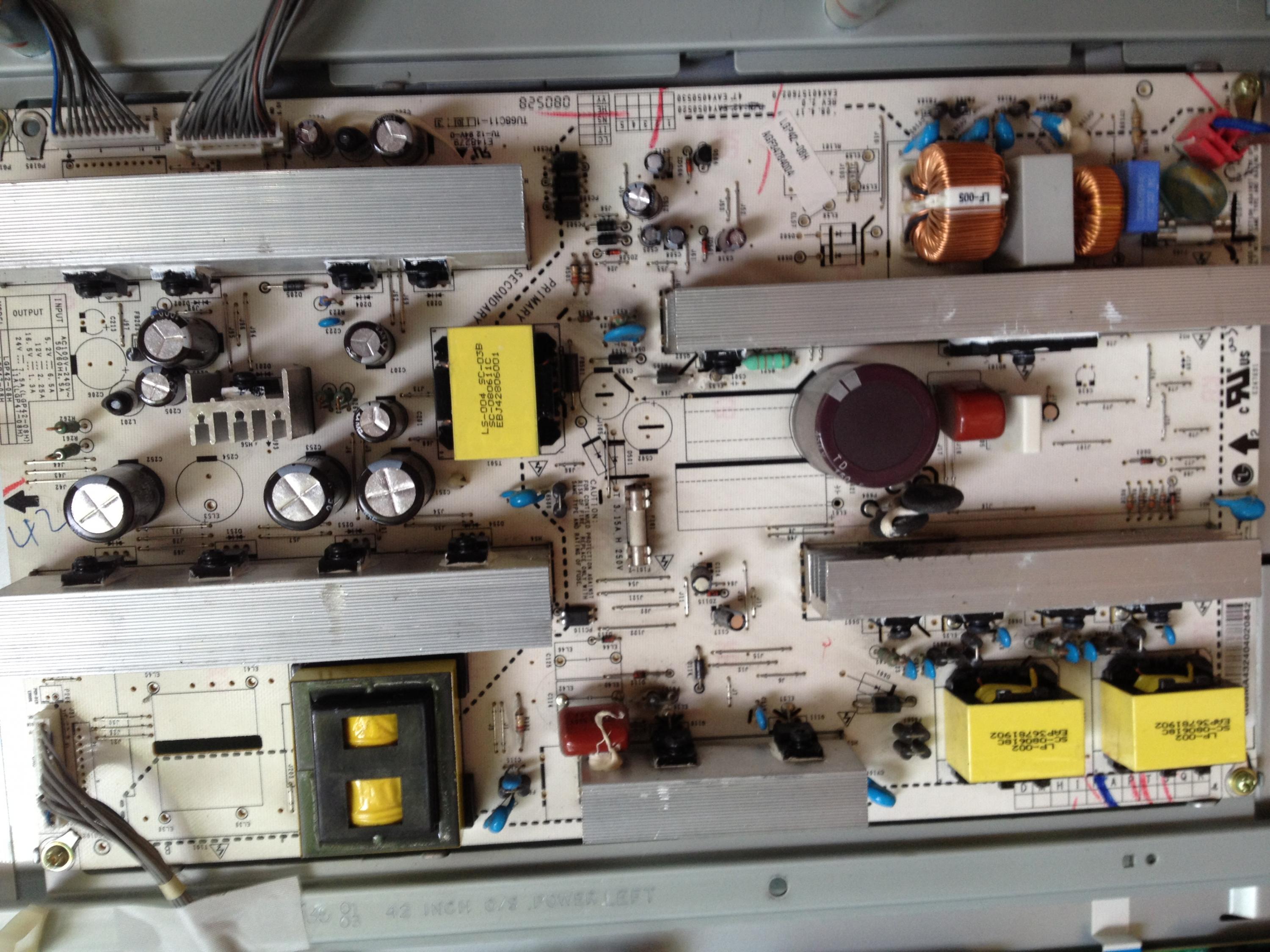

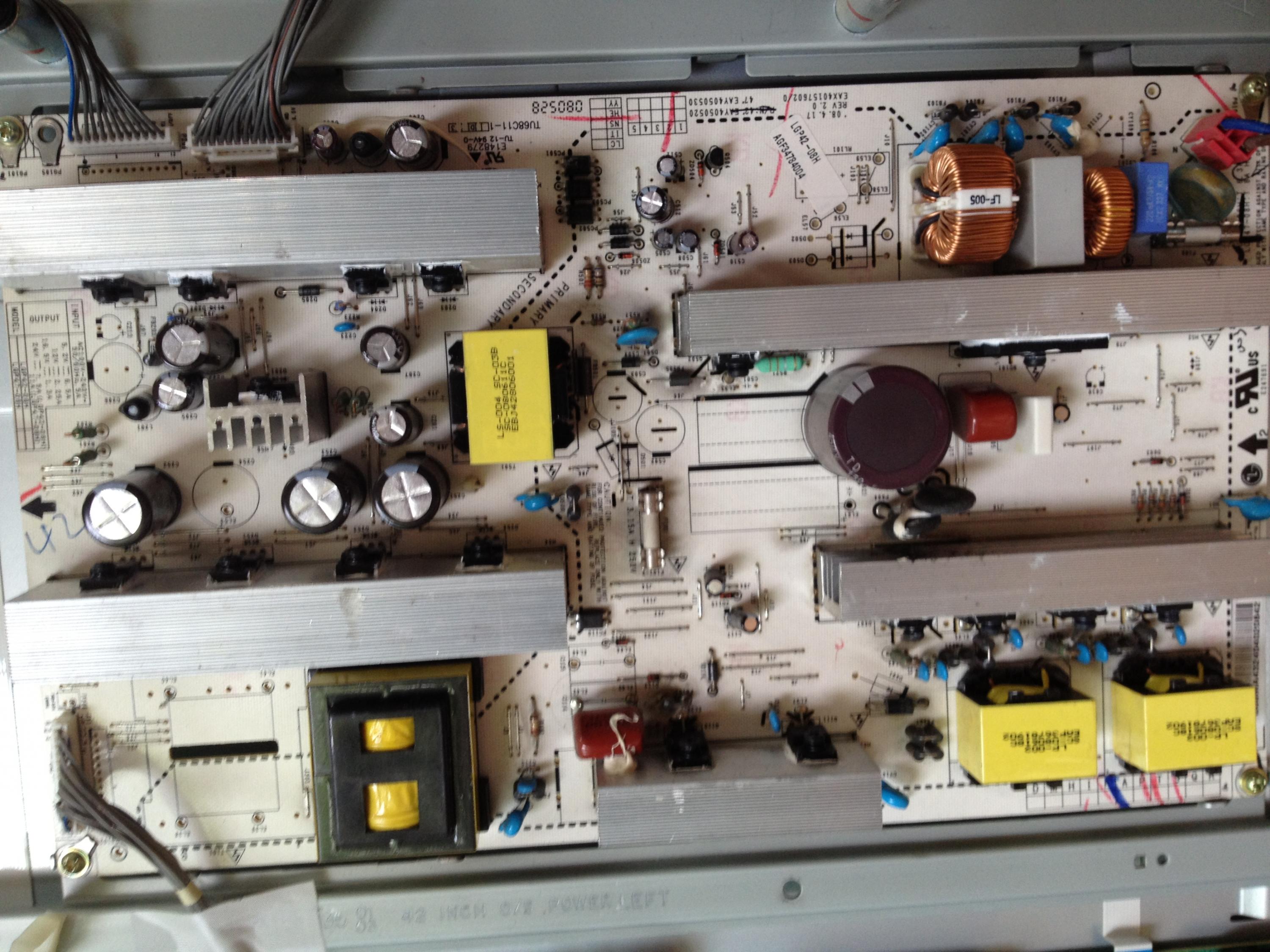

                          Re: 42LG50 Won't Turn On
                          I don't know if yours does or not since you haven't provided a picture of the power supply (hint).
                          Here are photos of the power board.
                          • retiredcaps
                            • Apr 2010
                            • 9271
                            The two connectors in the top left hand corner appear to have a legend, but are obscured by the cabling.
                            That is where you may find PS_ON, BL_ON, etc.
