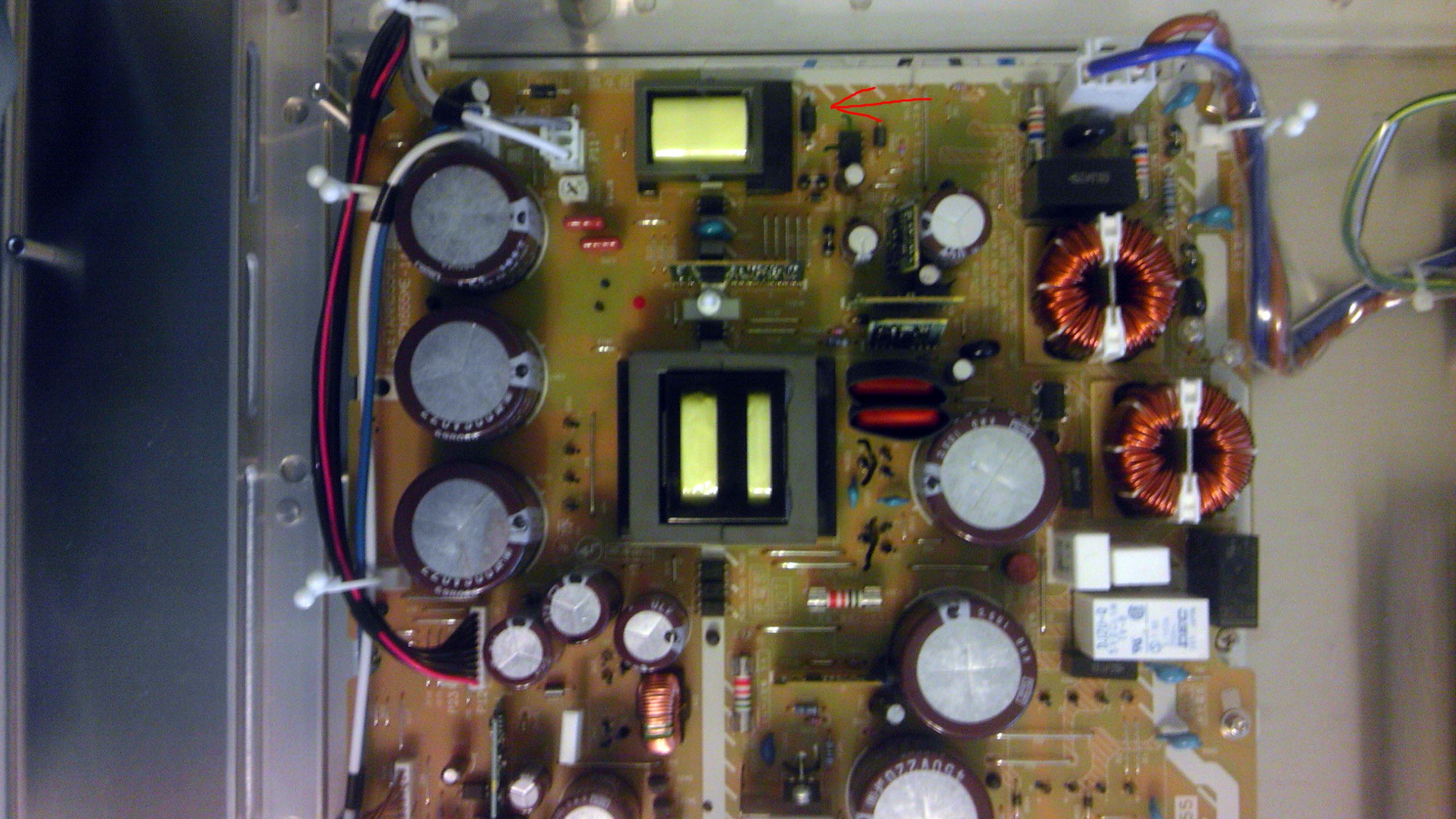

    I got a 50" Panasonic Plasma model th-50px75u that wont power up.
    When I plug it, I can hear a click.
    But after that if I press the power button, I just get a static red led, no blinking or nothing.

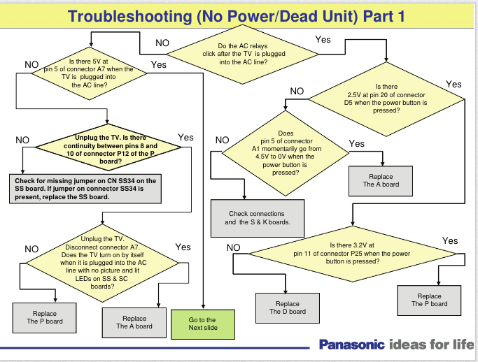

    Any way, I got a troubleshooting diagram from scribd, and followed the steps for No power/ Dead Unit.
    In pin 20 of D5 I got 3.0v
    and in pin 11 of P25 I got 3.2v
    So according to that diagram there is something wrong with the power supply. (power supply ETXMM655MEH )
    I did a visual inspection, and I cant see anything obvious, and measured continuity in all the fuses I saw.
    But thats about it, I dont know what else to look for.

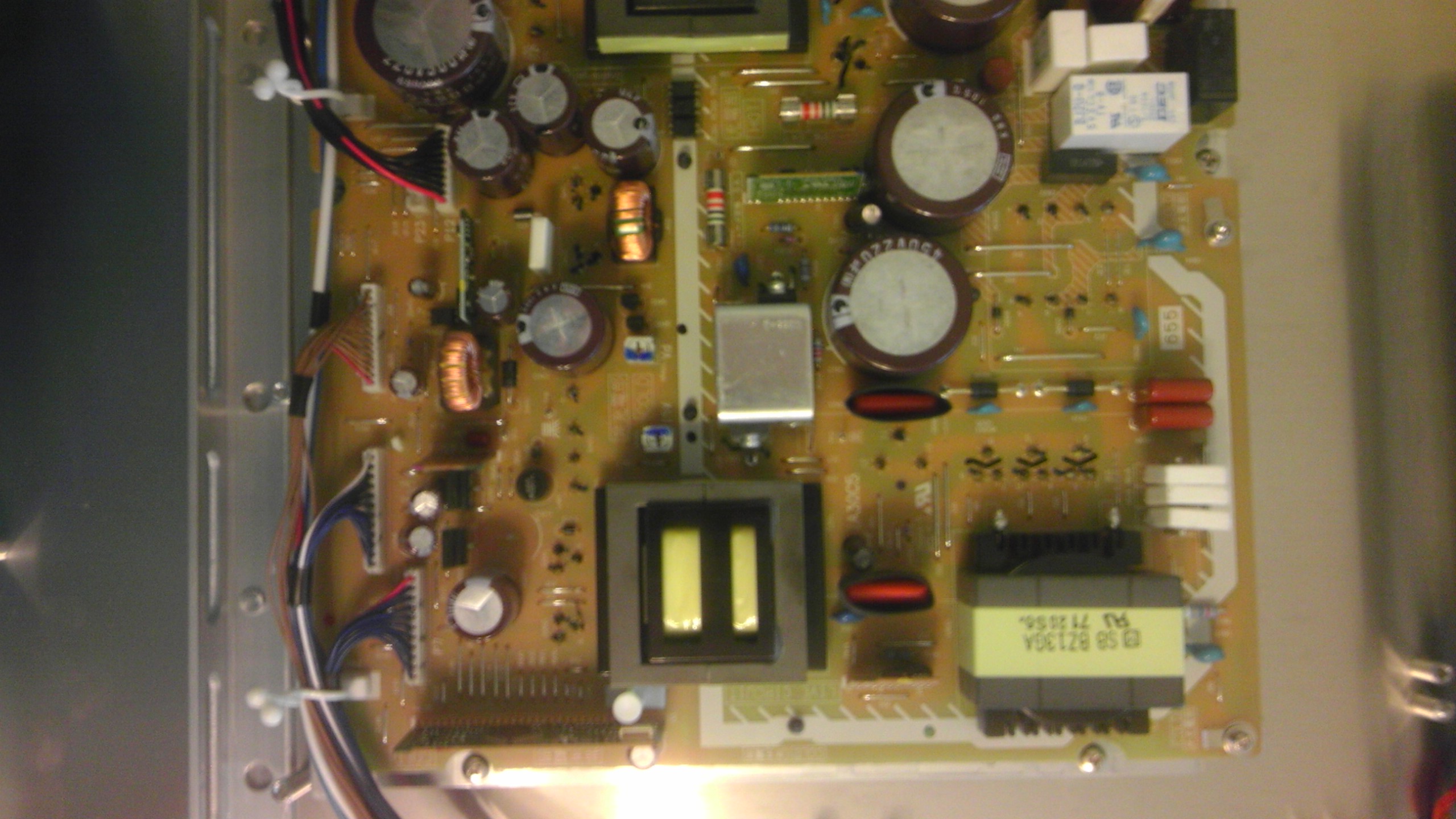

    Im attaching some pictures of the power supply.

    Looking in youtube how to check diodes, I found that two of them apear to be opened, im posting the pictures to see if this can help.
    Thanks again.

                That diode is probably good (it is a TVS, so will not conduct normally); is it still reading a short between the terminals on the PCB, where you removed the diode?
                  Re: 50" Panasonic Plasma dead.
                  If i use the continuity test between the two empty terminals where the diode was, I get a beep
                  If I use the diode mode I get 0.00 so I guess "yes"?
                  I get a shorts between the terminals.
                    OK, so there is still a short. Which area are you testing? (I'm not sure which one it is the picture.)
                      I took out the diode next to what it looks like a yellow transformer.
                      And I'm getting a "beep" between the terminals where the diode was.
                      Thanks.
                        That MAY be normal, as the diode is simply there to protect the transformer which will read as short. I think you need to look elsewhere.

                                  So following the flow charts in this excellent troubleshooting manual, I was able to pinpoint the problem in the GS board, so decided to take out the GS board...
