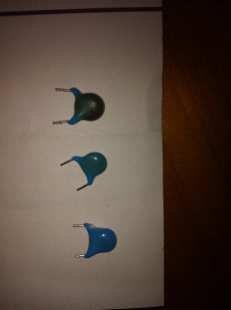

    My Tv the backlight has gone out. Can see the image in the back but there is no backlight. When the Tv is turned out the light stays on for a 1second then turns off. So I took the back off the Tv and the first thing that jumps out is there is three blue capacitors that have gone brown. I have unsoldered them to identify the caps.
    This is what is on them
    Cap 1.
    LY
    SL6KV
    27J
    Cap 2.
    39
    6KV
    SEC
    Cap 3.
    LY
    SL6KV
    10J
    I'm pretty sure that cap 1 is a 27pf 6000volt 5% tol high voltage ceramic cap, and cap 3 is a 10pf 6000volt 5% tol high voltage ceramic cap. I am unsure of cap 2.

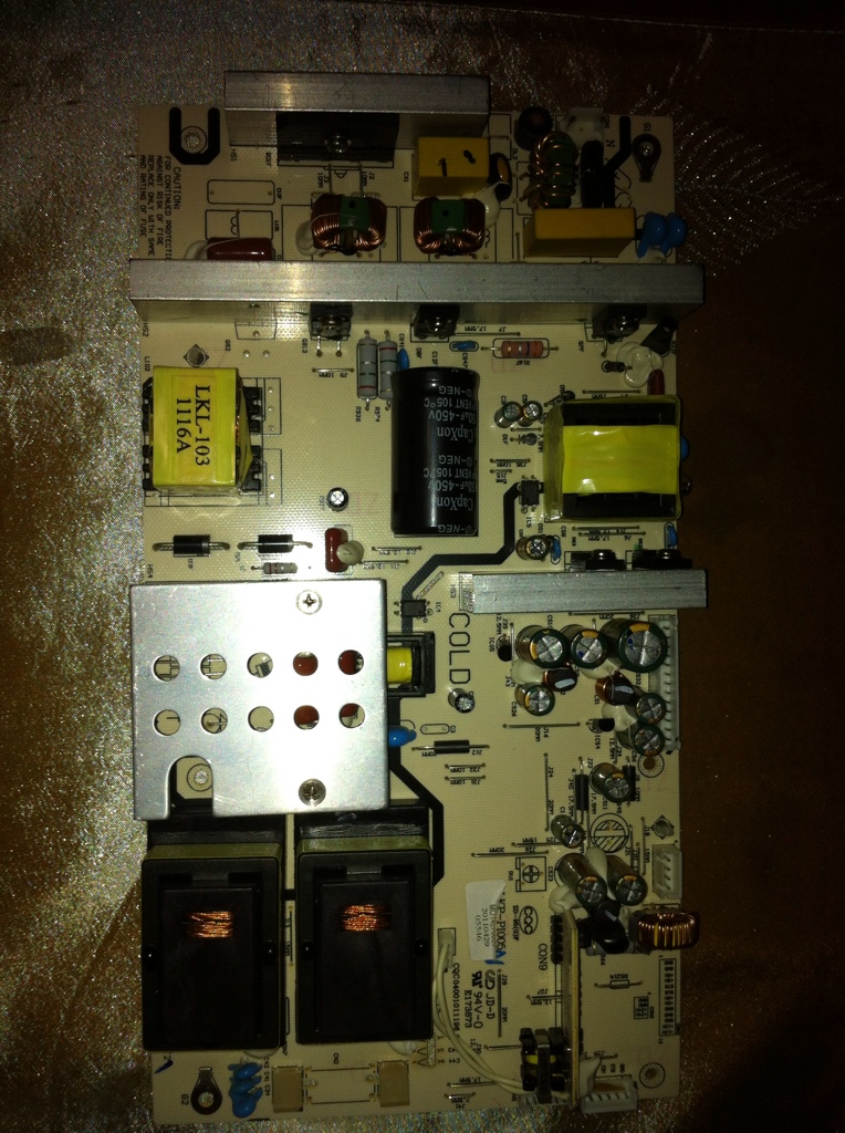

    Here are pictures of the board and caps.
    Please help

        Great - thanks its probably 6000v 39pF however these tend to crack when they are bad.

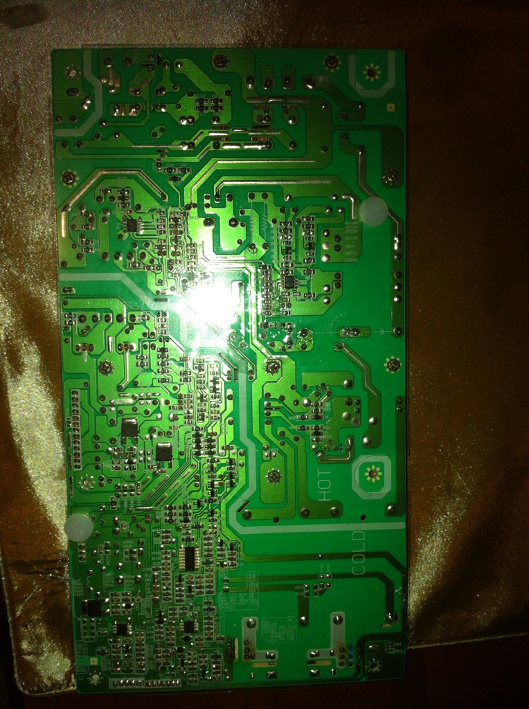

        From your description is could be the inverter transformer can you check the secondary windings - if you can read the part number or put up a picture of the back of the board we can help locate them.

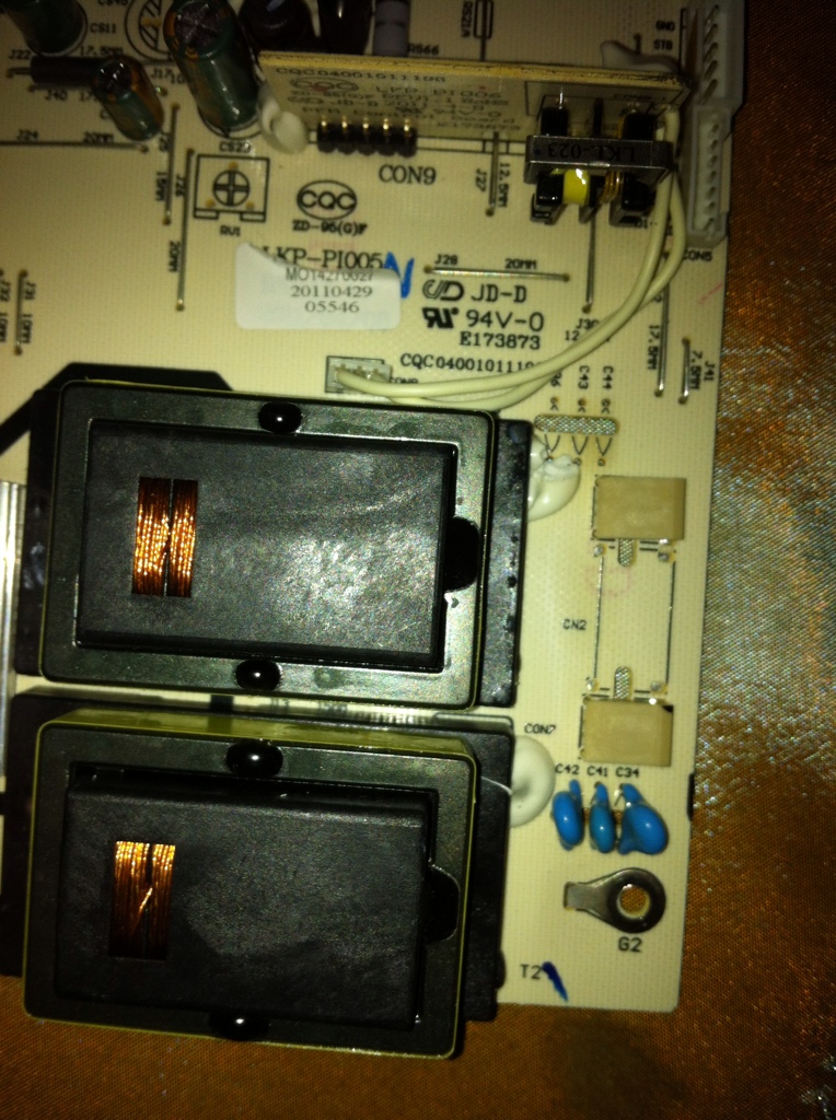

          The model of the tv is a Vivo LTV40FHD.
          On the board it has LKP-PI1005, but it did have a sticker over it with LK-PI400106E.
          The 39 is smaller then the rest of them. The 27J is the worst of all three, it is quite brown but it isnt cracked.

                              Are C41 and C42 both 39pF? I was able to read them without unsoldering. Had to bend them a little. Wonder if the wrong one got put in there. All the ones on the backlight circuit card are 27pF on mine.
                              Both C34 and C36 are 10pF.
                              My C43 was the problem. Not sure how long the others will last but I bought extras if I have to replace them later.

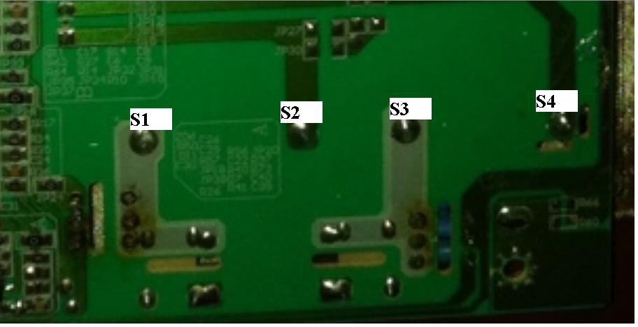

                                I have been looking at the area deciding which are the secondary windings on the transformer and think that are as marked . In doing so I see where the 3 caps have been removed but also that the other three do not look "factory"
                                so perhaps all 6 were replaced previously?
                                OP can you see what markings are on your other 3
                                Transformers - think these just provide power to the inverter board? but you can still check - power off meter on ohms check S1 >S2 and S3>S4 dont know what to expect but may show up a mismatch or open.
                                (just in case new caps dont fix it)
