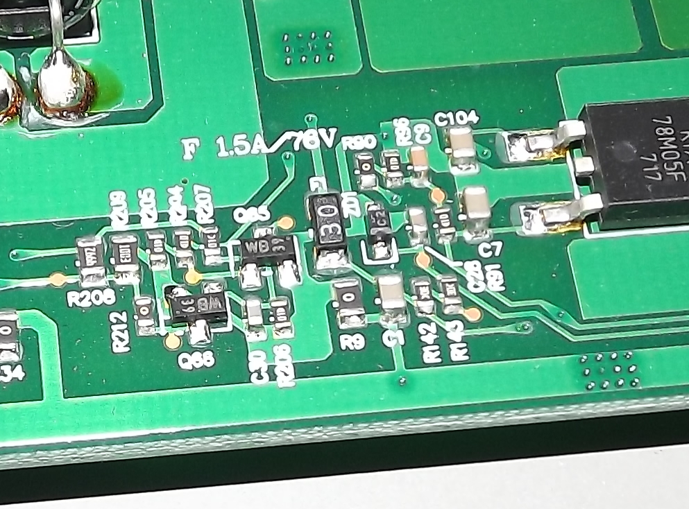

    Visual inspection...

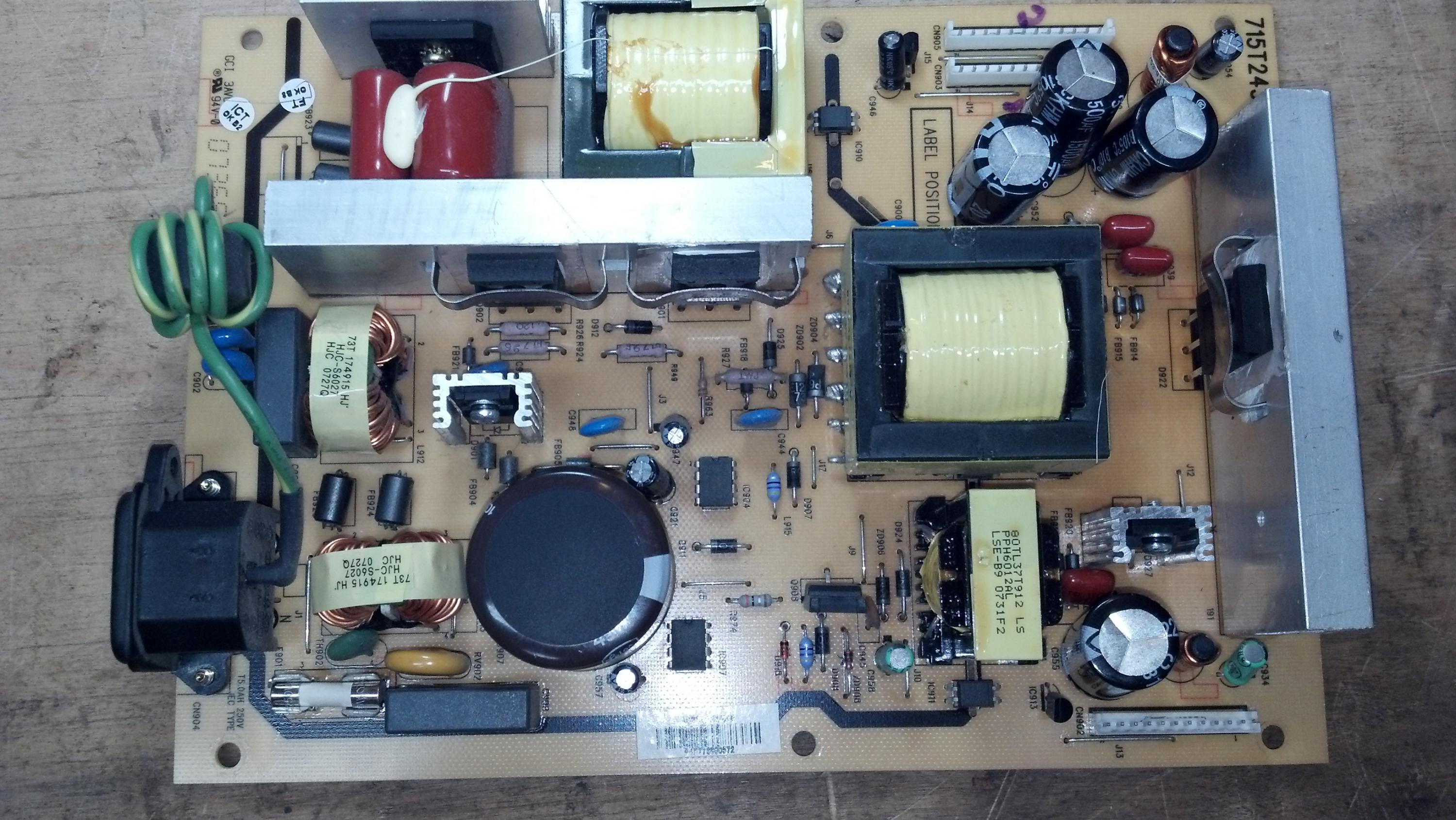

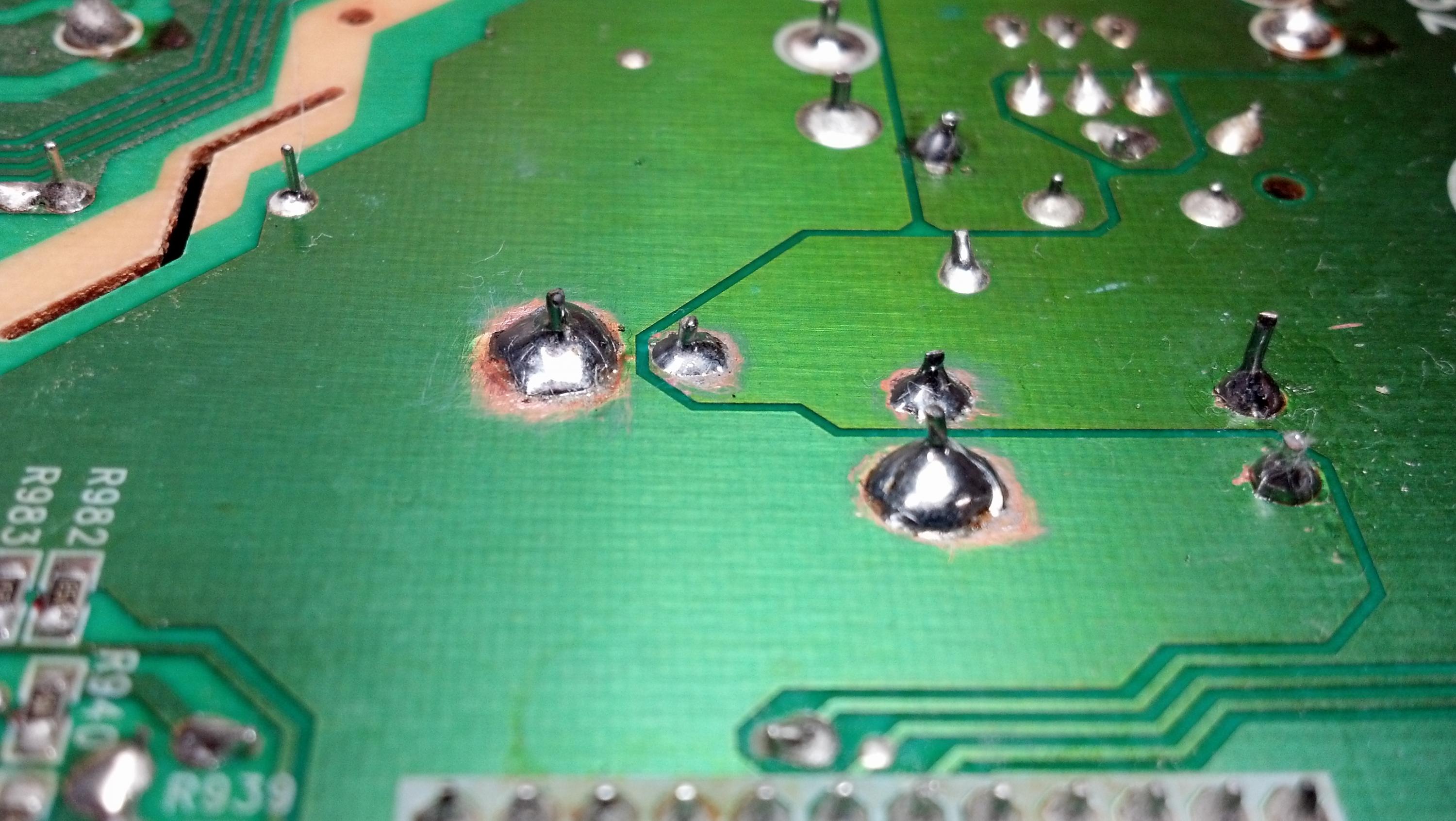

    Removed back of tv,first thing i see is sombody has already replaced the 4 bigger caps that are known for failing.
    There solder job was terrible!!!
    Caps they used where physically to big,with wider pin spacing,but he got them in there!
    I have downloaded the service manual and there temp /capacitance/voltage is correct,and he got the polarity correct.
    But i believe they are just general usage capacitors!
    They are illinois capacitor ckh series.
    So i decide to desolder them to resolder them and find out he damaged the pcb pads on a few of them!!!
    I scrapped back the solder mask around a couple pads to get more area to solder to, and i tinned the copper and got them soldered in pretty good.
    Put power supply back in tv,Same sypmtoms as before,no backlight,with sound..
    Now i have read just about everthing about this model on here and have seen where some ppl have shorted diodes,mosfets and rectifiers.
    I have read how to test them componets with a dmm in and out of circuit,and have tested 2 mosfets for shorts,test ok, tested bridge rectifier in circuit,test ok, tested another rectifier out of circuit,test ok.
    tested a bunch of diodes in circuit and most tested ok,pulled one lead of the couple that test funny and they tested fine out of circuit.
    One question i had was those general purpose caps ,will they at least make the tv work? I have no problem replacing them and the other smaller caps on ps board with the correct good quality ones that are low esr,once i know the set has a good picture!

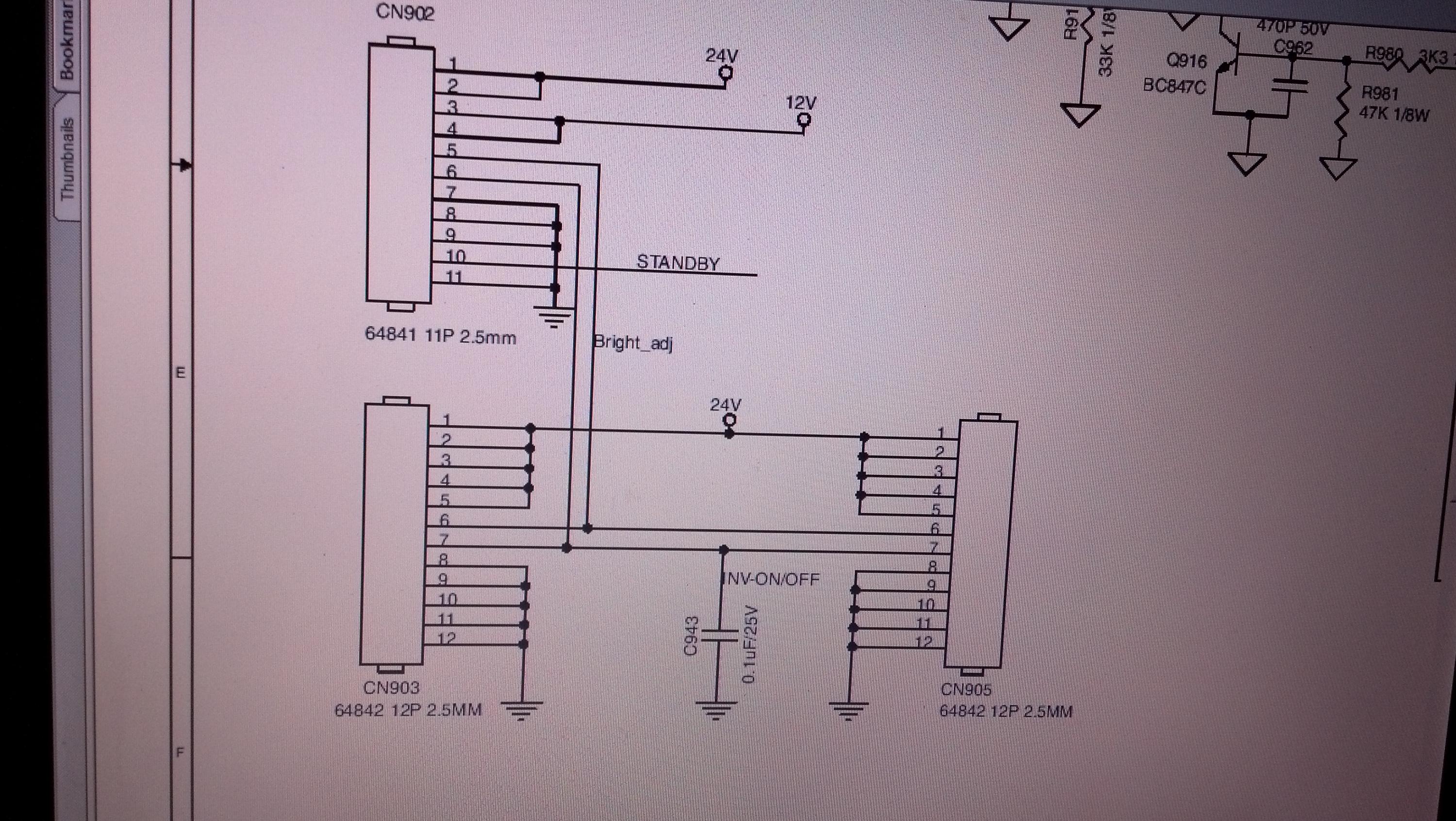

    I installed the power supply back in tv,and with help from the service manual i tested voltage at the output of the power supply with the inverters and main board connected..tv plugged in and turned on..
    Im getting 24v going out to the inverters
    Im getting 24 and 12v going out to main board
    I didnt check standby power as the service manual does not state the voltage.
    I will post a pic of the pinouts and voltages.

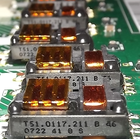

                    2) What is the part number of the inverter transformer? There are 20 of them on each board. They should all be the same part number.

                    I took a pic of the inverter part # for you,should be able to read it well.

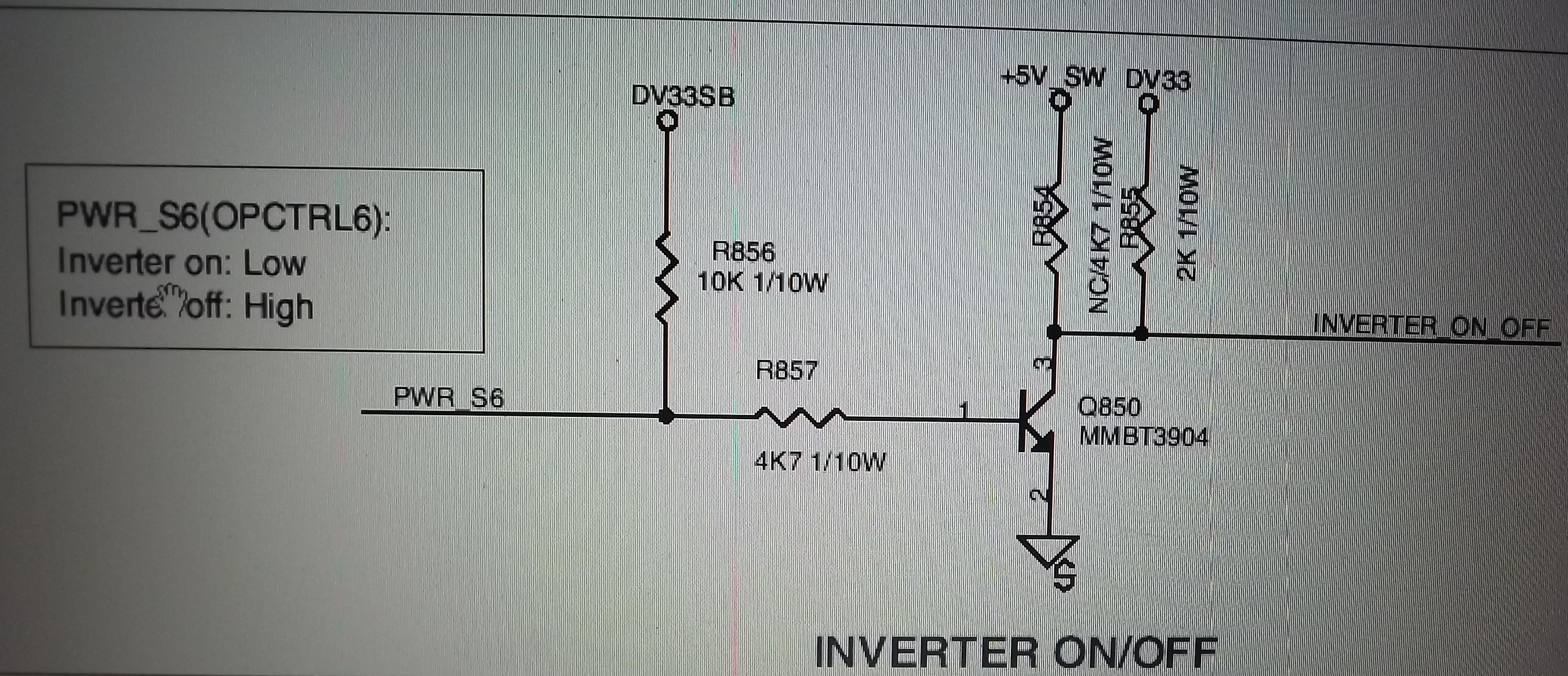

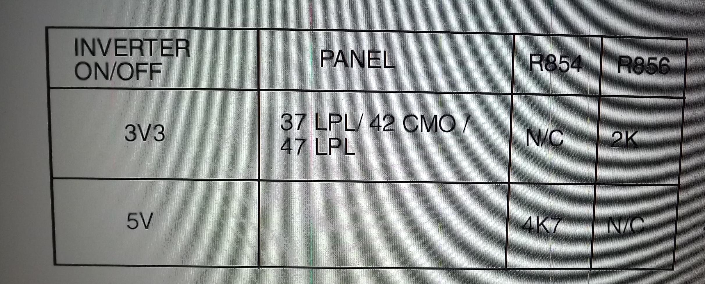

                      Re: philips 42pfl5432d got sound no backlight
                      Looking at the service manual for the inverter on/off
                      What do you make of it for voltages?
                      I see 3v3 not sure what that means?
                        Refer to
                        http://www.lcdparts.net/TransformerD...ProductID=2816
                        For each inverter transformer on each board, measure the resistance between S1 and S2. They should all be around 1000 ohms. Report all your readings for above like so
                        T1
                        S1-S2 = 1001 ohm
                        T2
                        S1-S2 = 1004 ohm

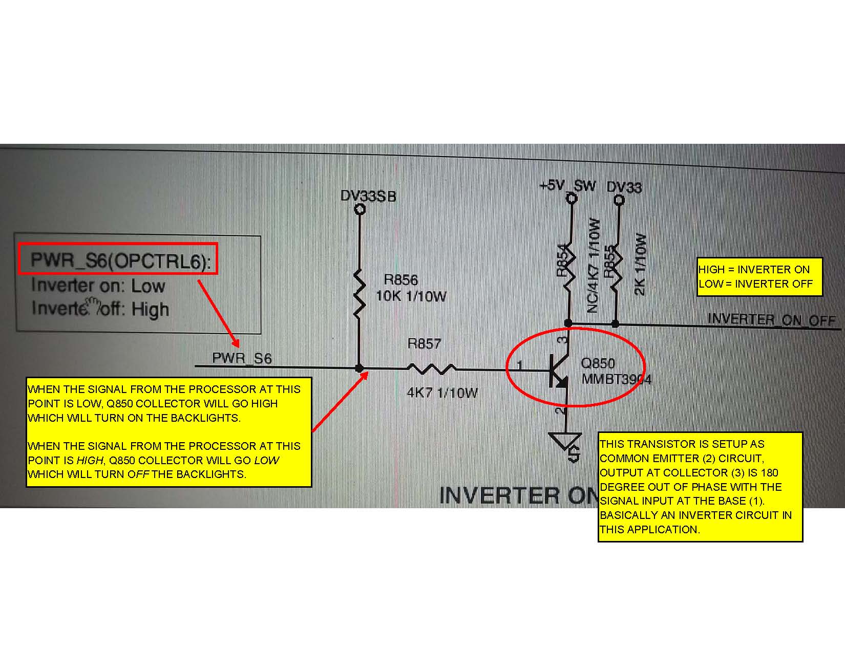

                          Hmm,
                          According to the screenshot, it says
                          Inverter on: Low
                          Inverter off: High
                          Normally, "Low" means 0.0V and "High" is 3.3V.
                          That means the main board isn't toggling BLON from 3.3V to 0.0V.
                          PS. 3V3 means 3.3V.

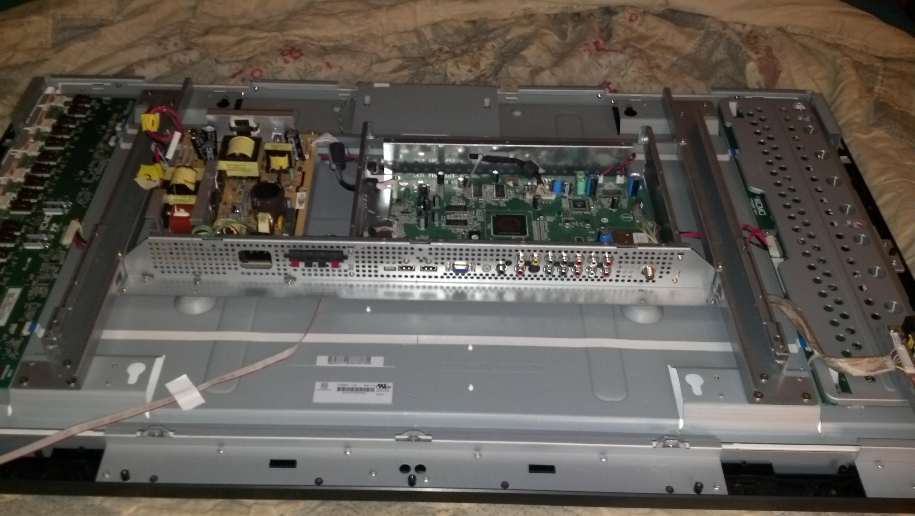

                            1) Can you post a clear focused shot of the main board?
                            2) Can you post a clear focused close up of the area where Q850 is?
                            --- begin sig file ---
                            --- end sig file ---
                            • allsmith
                              • Aug 2012
                              • 179
                              Trying out a new camera,hope this aint too bad.I dont want my picture file too large,so im trying turn down the camera and still get a decent pic.
                              ok yeah i noticed that about high being off and low being on.
                              I cant seem to find Q850 yet on board even with magnifing glass.
                              ill see if i can find it on service manual,or if you can point it out ill get a close up pic.

                                Sorry still cant find Q850 anywhere,and ive looked on all boards..but i did ohm out the inverters.
                                Inverter transformers are all testing out at very close to 2000 ohms,
                                The pic of the inverter you found for me is pictured upside down,so im pretty sure im testing s1-s2.

                                  Do this. Trace the BLON from the inverter board back to the main/logic board. Post a picture of the main board BLON and its surrounding area (maybe a 6 x 6 inch area around the BLON).
                                      Did you look at the backside too?
                                        OK, I look at the INVERTER ON/OFF picture in post11, you do have BL_ON (>3.3V = ON) signal correctly feeding your inverter board, please see my explanation in the picture.
