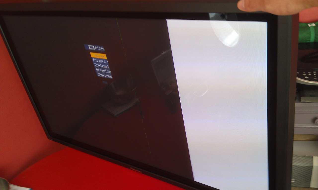

Panasonic TH42PH9 Half screen working
  • J-Man
    • Aug 2012
    • 3
    • Netherlands
    Panasonic TH42PH9 Half screen working
    Hello all,
    I got a Panasonic TH42PH9 with only the right side is working.
    The left side has part white part black
    I checked the ribbons they seem to be Ok.
    And i replaced the D board .. also no effect
    maybe the C buffer? or did the panel failed?
  • J-Man
    • Aug 2012
    • 3
    • Netherlands
    Re: Panasonic TH42PH9 Half screen working
    anyone please?
    • alexanna
      • Mar 2010
      • 1346
      Re: Panasonic TH42PH9 Half screen working
      This is out of a 46 Panasonic TV.
      I am not sure if it pertains to your model.
      Whatever I do, I consider it a success, if in the end I am breathing, seeing, feeling and hearing!
      • J-Man
        • Aug 2012
        • 3
        • Netherlands
        Re: Panasonic TH42PH9 Half screen working
        I have only 2 C buffers .. buy yea same idea
        i ordered an C buffer for that side, so lets hope that solves the problem ..
        If not .. what could it be then?
        • smic717394
          MSI Optix MPG27CQ half screen working. Identify burned component
          by smic717394
          I have a MSI Optix MPG27CQ screen to fix, only half screen is working, I found a burned chip on the right buffer board (S270DP01V00_HF_SR) but I can't read the model. Can anybody help?...
          04-08-2025, 05:53 AM
        • valvashon
          LG 55UH6150- trouble powering up, then half lit screen (pictures!)
          by valvashon
          The 55" LG has been in the basement for a few months without being used. Turned it on yesterday, set came on as it should and showed a complete screen for about 5 seconds (was on a broadcast channel but no antenna was connected), then the screen went mostly dark with about 1/3 of the screen on the right lighting up with brighter lines in that lit part (sorry, no pictures of that). Power LED was cycling too, preventing the TV from fully powering up.
          Pulled the back off, all boards looked OK. Pulled the LED connector, turned the set on to see if it would power up but I don't belive it...
          11-24-2024, 12:08 PM
        • Raulnn
          TD Systems K50DLG12US half black and half white screen
          by Raulnn
          good night! I have this screen that looks half black and half white. the tcon gives a low vgh value (5-6v). the rest seem fine. I first removed the flex from one half of the panel and then the other. Removing the left, vgh increases it to 25-26v. I think the problem is in that area, but there are not many elements on the integrated controller board. there are no shorted capacitors. could they be a cof? Some help?
          By the way, now the entire screen is black. Maybe some flex was not connected correctly... I have exchanged the flex and there are no variations, I don't think they are the...
          01-20-2024, 04:49 PM
        • Gabriel Lucas
          microsoft surface pro 5 touch screen not working
          by Gabriel Lucas
          Hello everyone, I bought a Microsoft Surface Pro 5 and the touch doesn't work. According to what the previous owner said, the screen stopped working after an update. The screen has no physical damage, and the touch works for 1 second when it turns on and then stops working. I've tried updating the drivers, formatting, and returning to factory defaults, but nothing worked. Can you help me?
          02-18-2025, 09:24 AM
        • howardc64
          by howardc64
          Problem
          08-04-2024, 10:36 PM
