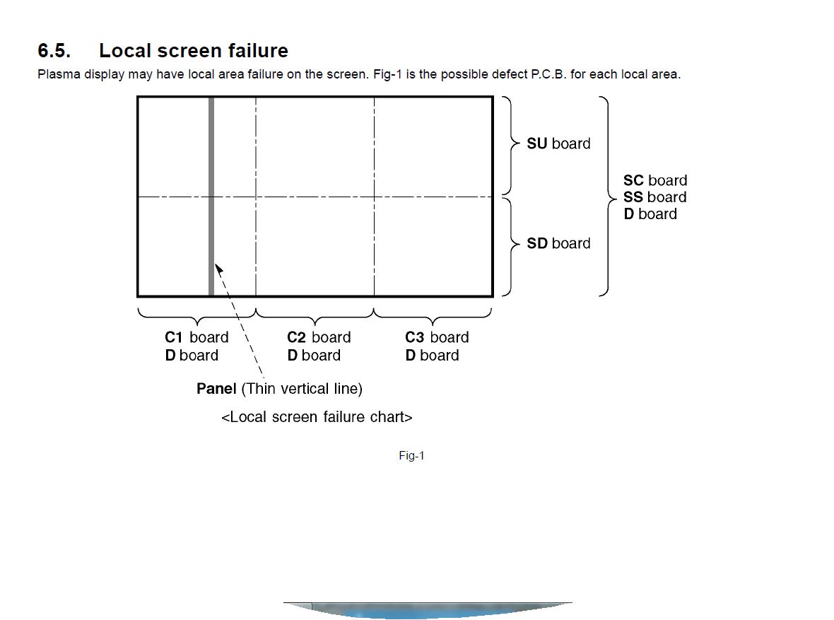

    Hello all,
    I got a Panasonic TH42PH9 with only the right side is working.
    The left side has part white part black
    I checked the ribbons they seem to be Ok.
    And i replaced the D board .. also no effect
    maybe the C buffer? or did the panel failed?

    • alexanna
      • Mar 2010
      • 1346
      Re: Panasonic TH42PH9 Half screen working
      This is out of a 46 Panasonic TV.
      I am not sure if it pertains to your model.

      • J-Man
        • Aug 2012
        • 3
        • Netherlands
        I have only 2 C buffers .. buy yea same idea
        i ordered an C buffer for that side, so lets hope that solves the problem ..
        If not .. what could it be then?
