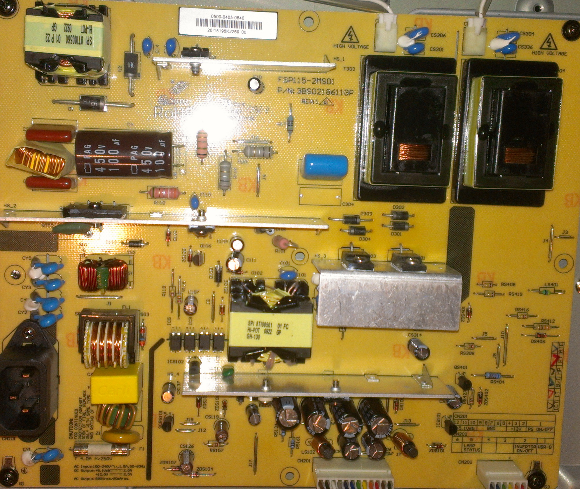

    When first powered on it has the gray screen and some vertical lines and some blotches. Backlight comes on and stays on so no issue with the inverters or backlights. After 20-30 minutes of being on, the picture comes in perfect and no further problems. Seems like something is having to warm up or maybe a solder joint expanding until it makes contact. Power supply and mainboard pix attached. Power supply voltages seem to be normal though I don't have a SM for this TV. Pins 1&2 on the PS small connector read 2.87V and 2.92V. On the larger PS connector pin 1 is 2.77V and 2,3,4 are 12V and 9, 10, 11 are all 5V.
    I am getting voltages from the the 1117 LDO's and the two transistors or voltage regulators and will post those shortly. I haven't tested extensively yet but it seem when I poke around some of those components that the screen comes to life sooner. More on that later. The caps on the power supply are rubicon, on the mainboard they are several different generic and/or cheap no name brands. Maybe some ripple current??

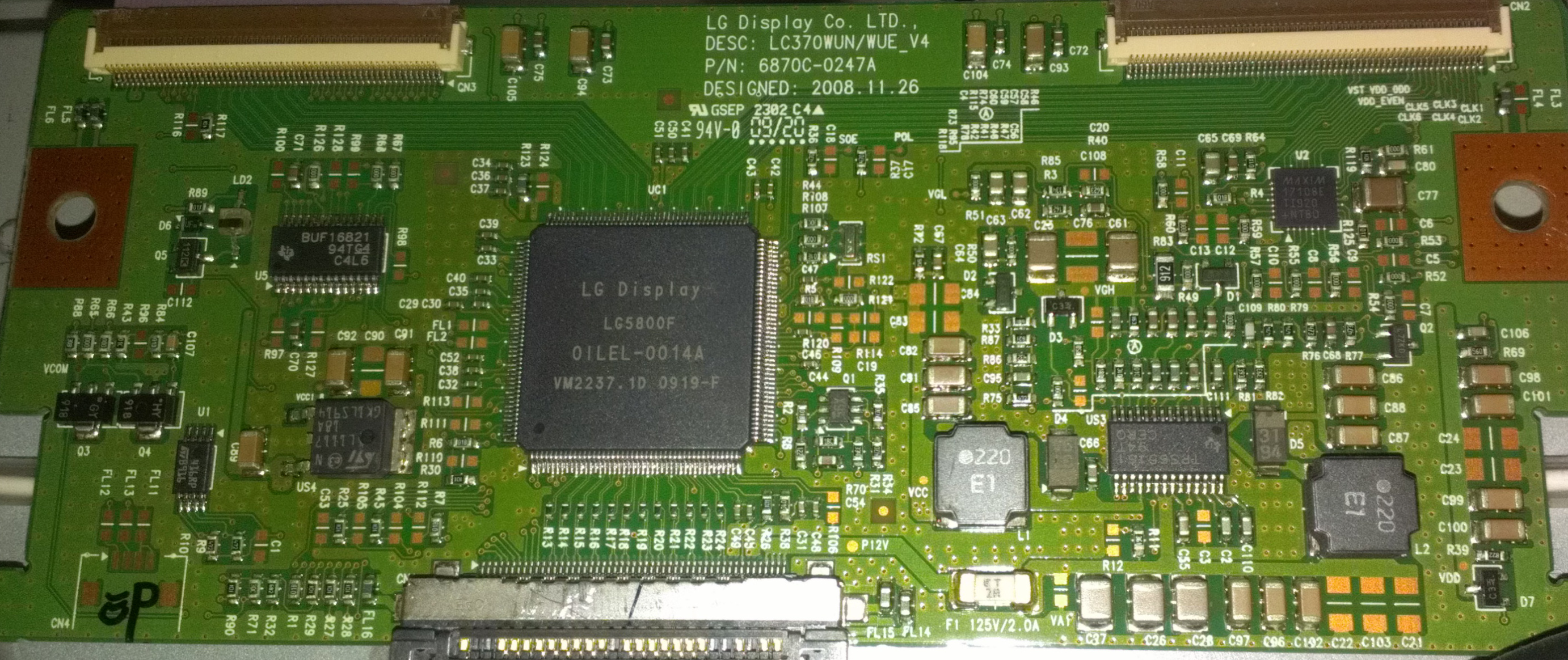

    Check any voltage regulators on the T-CON board yet, at the T-CON fuse?
    • DakotaKid
      • Nov 2010
      • 165
      Re: Vizio VL260M takes time to warm up

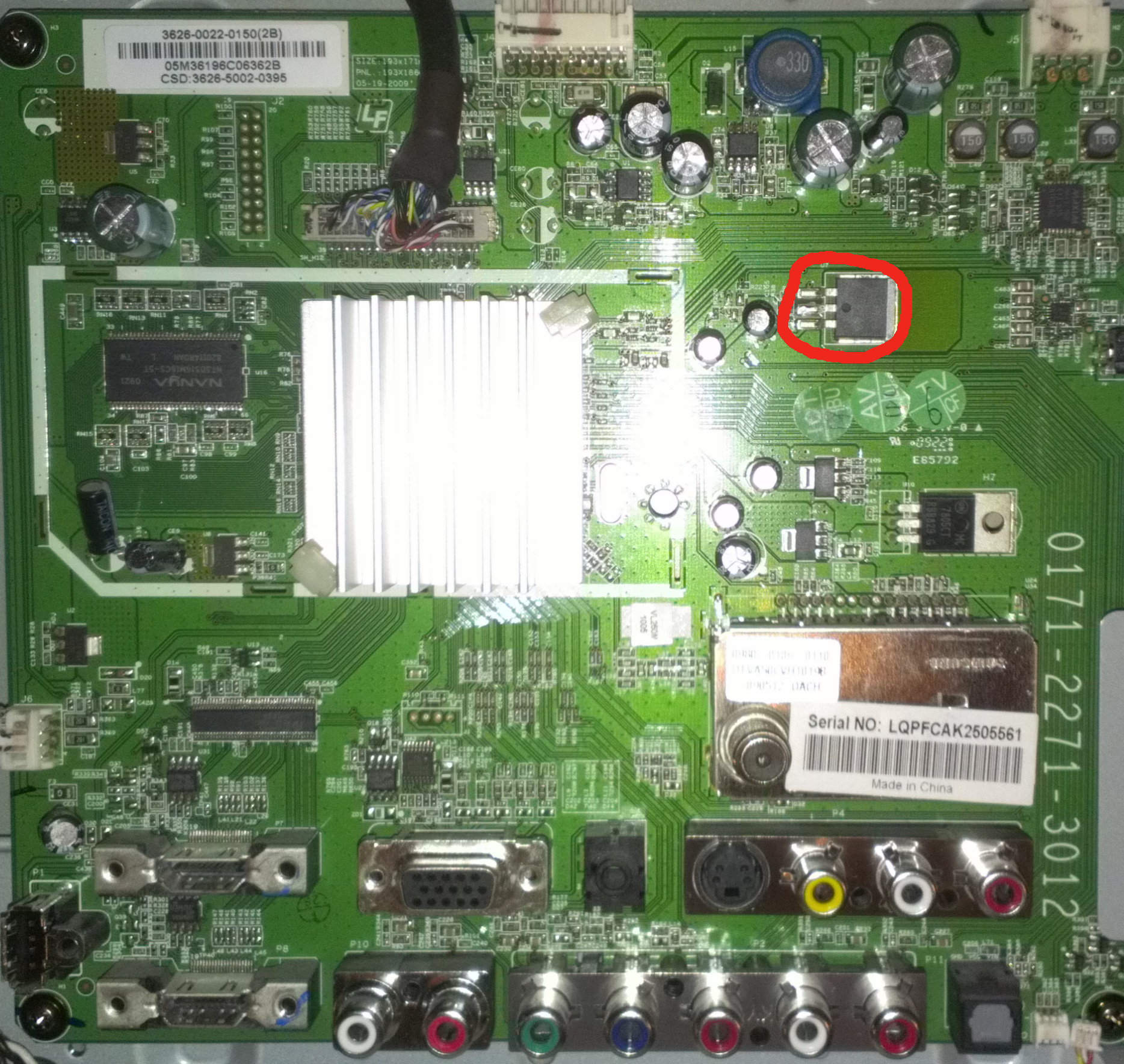

      Added picture of T-con. Voltages on the large regulator are (top to bottom in pic) 0V, 1.7V, 3.23V just after turning the set on while the screen was still gray with lines and didn't change when set was operating properly about 25 minutes later.

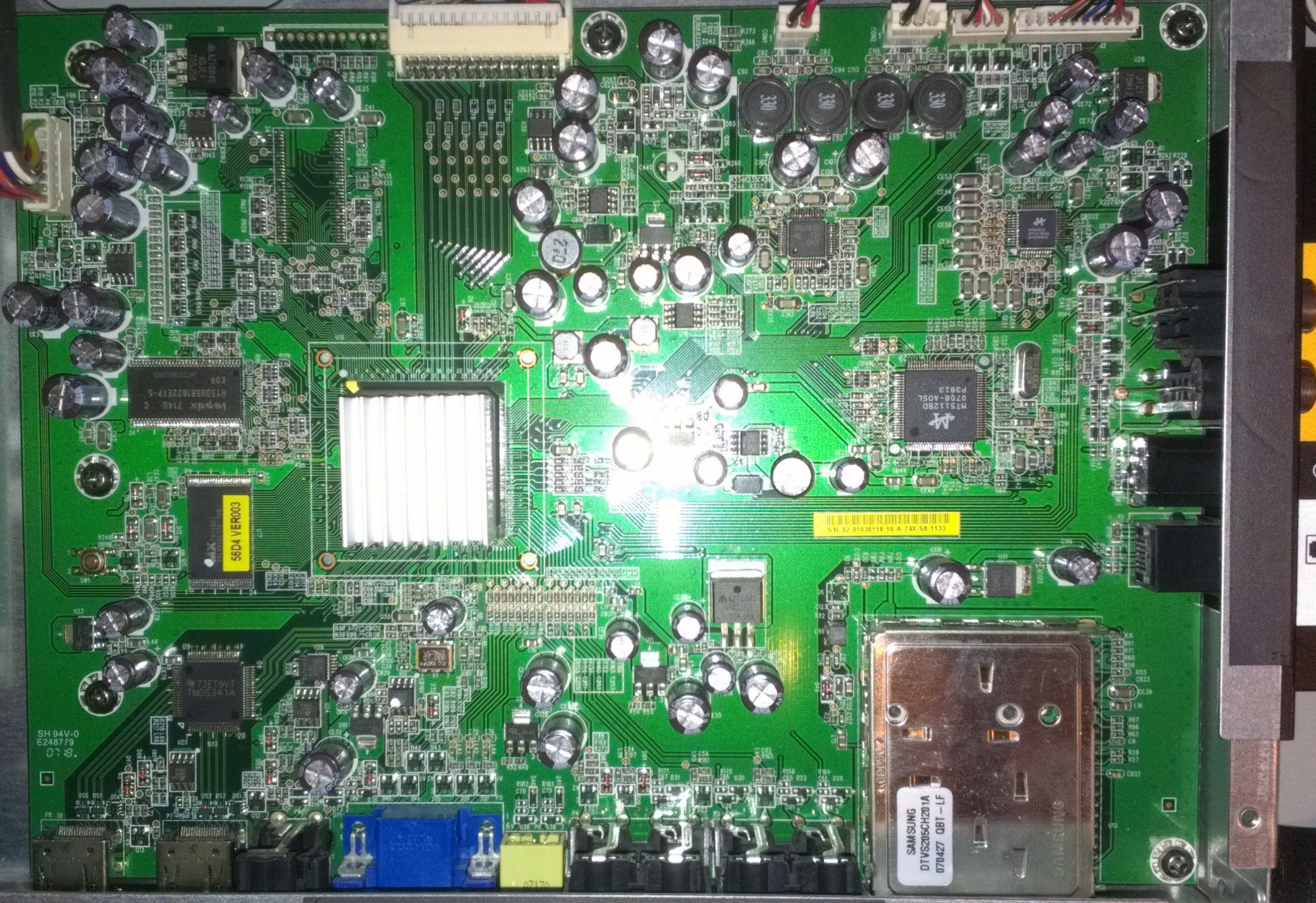

      And, ooops, I accidentally pulled in the wrong mainboard picture yesterday. I have attached the correct image to this post so please disregard the mainboard pic in the OP. I don't know how or if I can delete/replace that image.
      The top ground/adj leg of the uppermost regulator in the picture (marked in red) does something that seems odd. When I put my DMM probe on it, it reads 1.7 or 1.8 for a brief instant then jumps to 10V for an instant then settles back to a very steady and stable 2V and remains there. It does this every time I touch it with my probe. I don't know if it is just that sensitive to the DMM or if it is something of concern. The markings on it are 1084 and 0849IL so I am thinking it is a 5V input adjustable output 5A current limiting LDO regulator LM1084.
