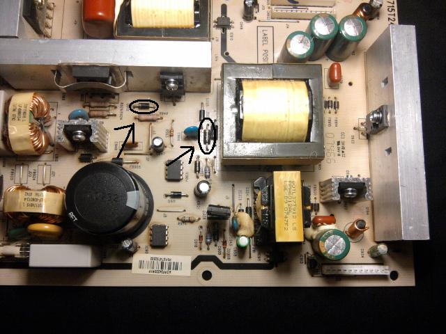

    Hi! I am a new member and love the site! Thanks for all of the information, very helpful!!
    I have a MAGNAVOX Model:37mf337b/37 that currently has the squeak/squeal going on. The Stock CapXon Caps are currently present in the t.v. @ a rating of 1000uf 35v.The three caps will need replacing due to bulging, also I tested the Diodes and found that two need replaced:
    ZD902 (KE12 74) tested at .017 and .017, D912 (RD) tested at .001 and .001 while installed to PSU.
    What brand of caps should be used?
    What are the correct diodes that I will need?
    Part #'s, Brands, any advice would be helpful.
    I can be more specific if necessary, Thanks again!!

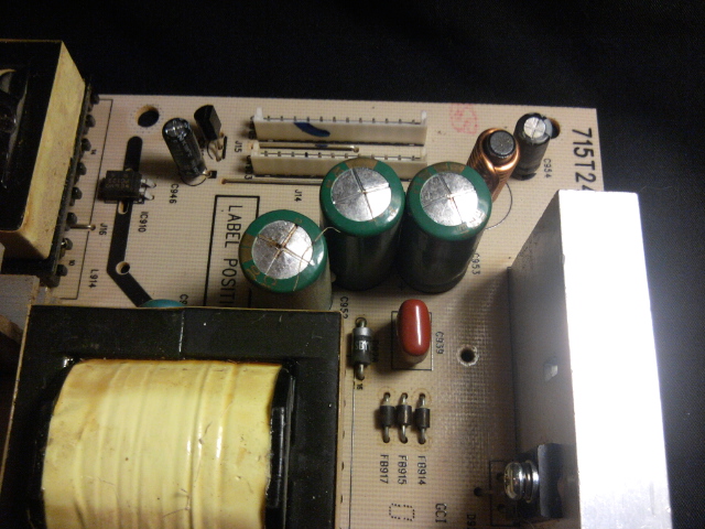

    Re: magnavox 37mf337b/37 parts advice
    These are suggested:-
    http://www.digikey.com/product-detai...445-ND/2433579
    + shipping about 3 bucks
    Panasonic FR - low ESR, high ripple current, very long lifespan.
    Just check the diameter (12.5mm x 20mm) will fit.
    The diodes - I believe UF4007 is tossed around here - http://www.digikey.com/product-detai...ICT-ND/3340246
                    Is there a chassis number on the model number sticker?
                    Pleas remove that zener diode, it should have number with PKEXXXX on it, it is Zener Diode for the snubber circuits, will be in 200V range.

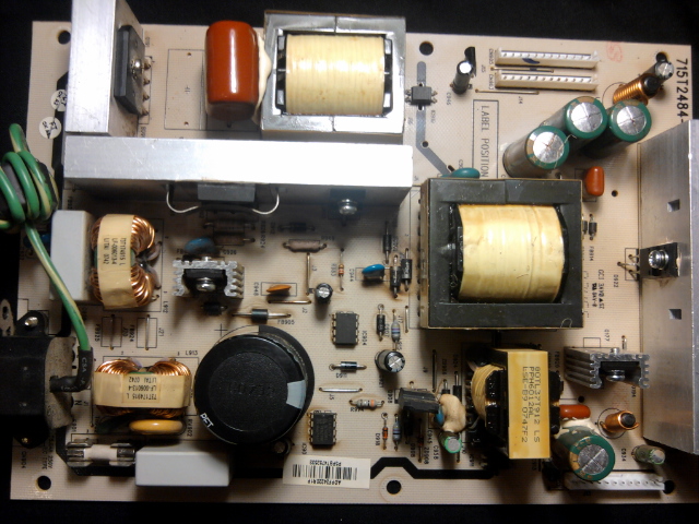

                      PSU # is 715T2484-4, there is a barcode also on PSU with ADPF24220R1P/P5PB74752533 as I am not sure what those numbers stand for. The back of the tv its self has model# and serial #.
                        Most PHILIPS/MANAVOX TV's have chassi number printed on the model number sticker to tell the service technician which chassis being used inside the TV since same model can have more than one version of the chassis. Any number on that PKE ZENER Diode?
                            From the picture, I can see KE2XXX. I do not see KE12XX. I expect it to be P6KE2XXX. I expect it to be 200v Zener.
                            His circuit may be similar to this one. I need to find the chassis number to look up the service manual.

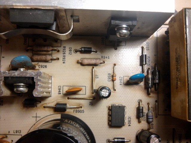

                              ZD902 is p6ke120a/744, now that i do see it. I am guessing i should replace with a P6ke120a? Thanks.
                              Diode tester reveals .019 and .019 out of PSU.
                                Digikey:
                                http://www.digikey.com/product-detai...ACT-ND/2770358
                                That is pretty low voltage rating for Snubber.
                                The other Diode D912 more likely to be UF4007, but take it out of the circuit to check and get the number off the body.

                                  I will definitely take D912 out,confirm the body numbers and diode test . I really appreciate all the input, I could not have done it without BADCAPS!! Thanks for the schematics as well VERY HANDY thing to have.
