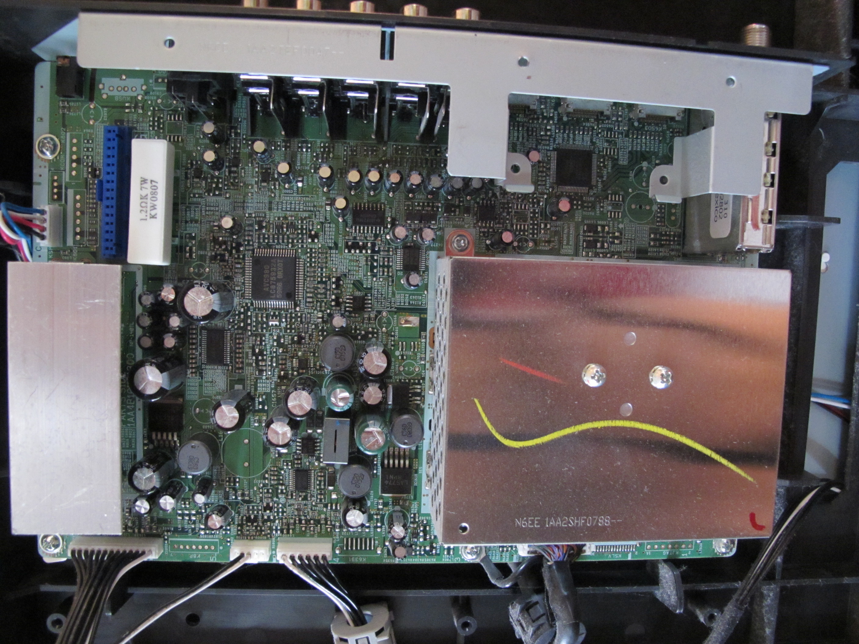

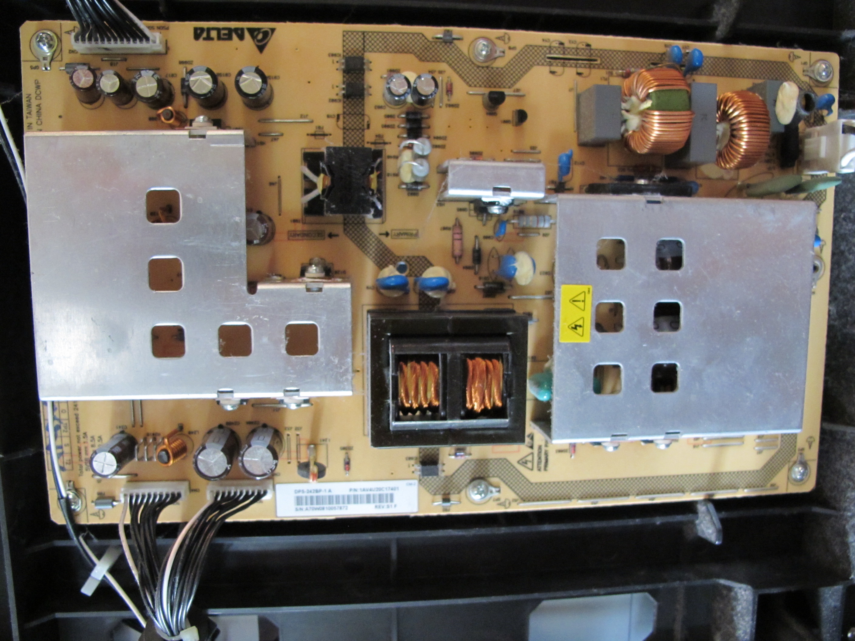

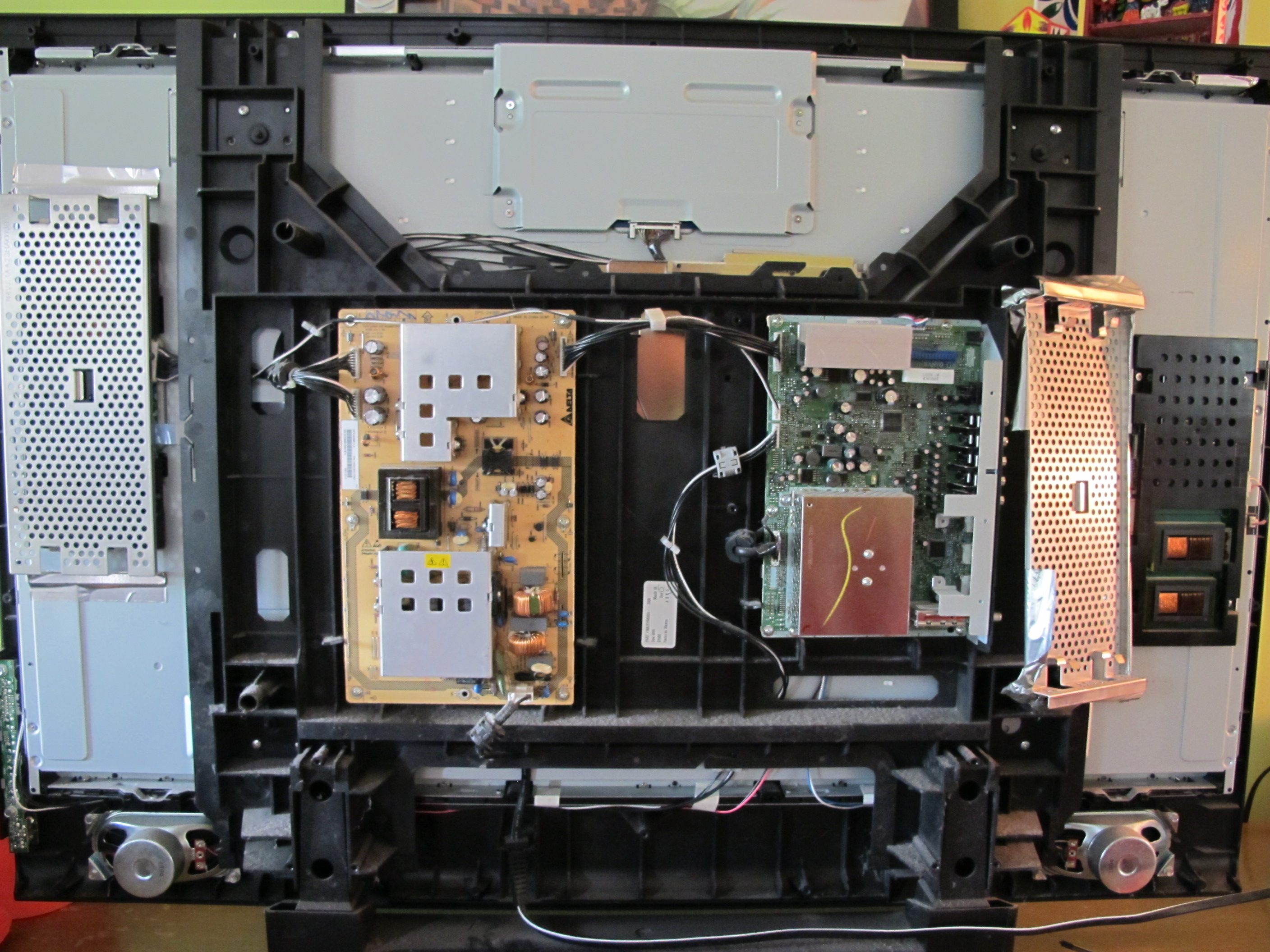

    Sanyo DP42848 Sound - No Picture
    Tv powers on. After 6 seconds, picture comes on w/ faint buzzing sound from each inverter board equally - for 1 second then goes away.
    Picture is visible in LCD with a flashlight.
    I've attached a couple of pictures, let me know where I should start!

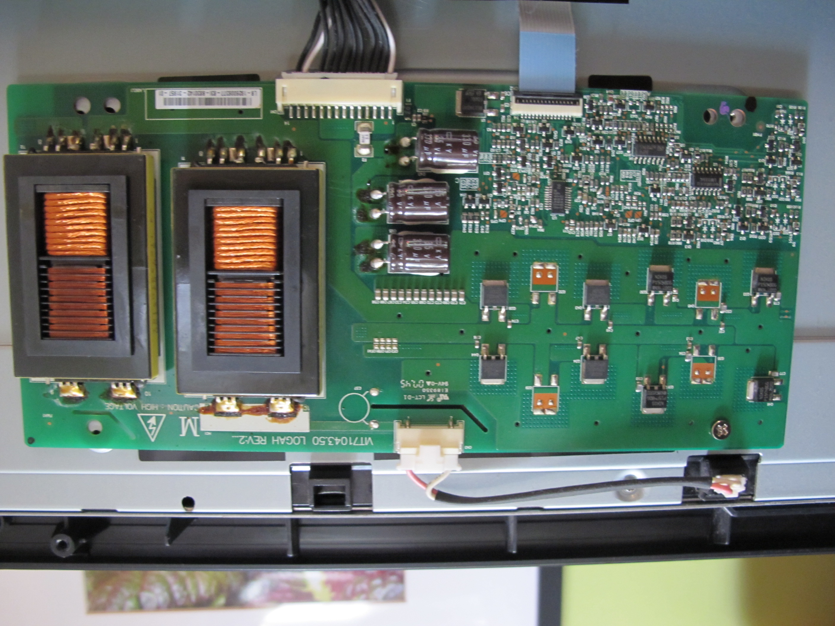

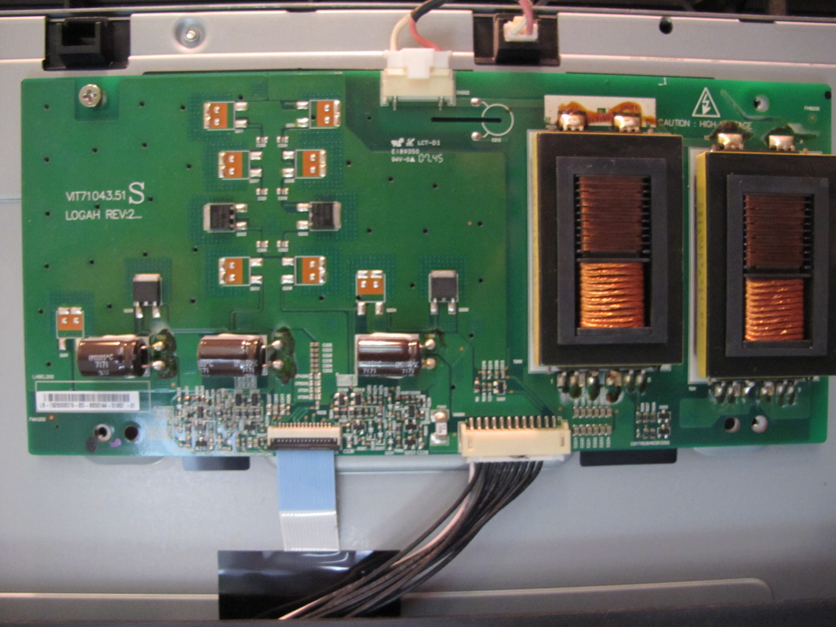

    Re: Sanyo DP42848 Sound - No Picture
    Here are pictures of the inverter boards, dark spots look to be Flux not Charred.

      I checked the Voltage to the two inverter boards and i'm getting 24V to both the master and the slave. If i unplug the slave inverter, and leave the master plugged in, i get the same behavior: turn on, 6 seconds later light comes on for 1 second, then off.
        I would Ohm out all four MOSFET's (the device with tab and 3 pin, the middle pin is connected internally to the tab), just label each pin with 1, 2, and 3. Then check the resistance between
        1&2
        1&3
        2&3.
        I would also replace those 3 caps on each inverter, it is cheap to do, need or not so you will not have problem later on.
        Also look real close at all the solder joints and for any burnt components.
        Set the Ohm meter to about 2K scale.
