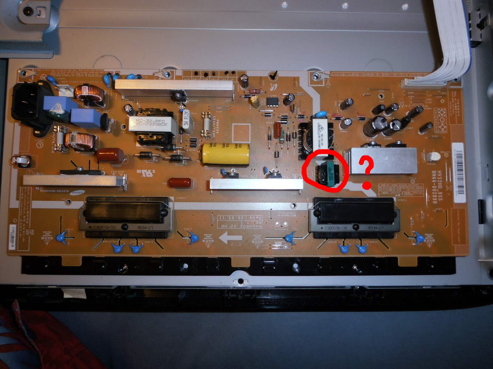

    Im thinking this is the 5/13vsb transformer.
    Try tracing it out, and see what components it connects to. I would check the mosfet that drives it, and the secondary rectifiers too. If some zeners blew, that could have made the mosfet blow too.
    Muh-soggy-knee
      Re: samsung 32 ln32b360c5d no power no indicator
      That's probably the gate drive transformer for the CCFL FETs, but I could be mistaken.

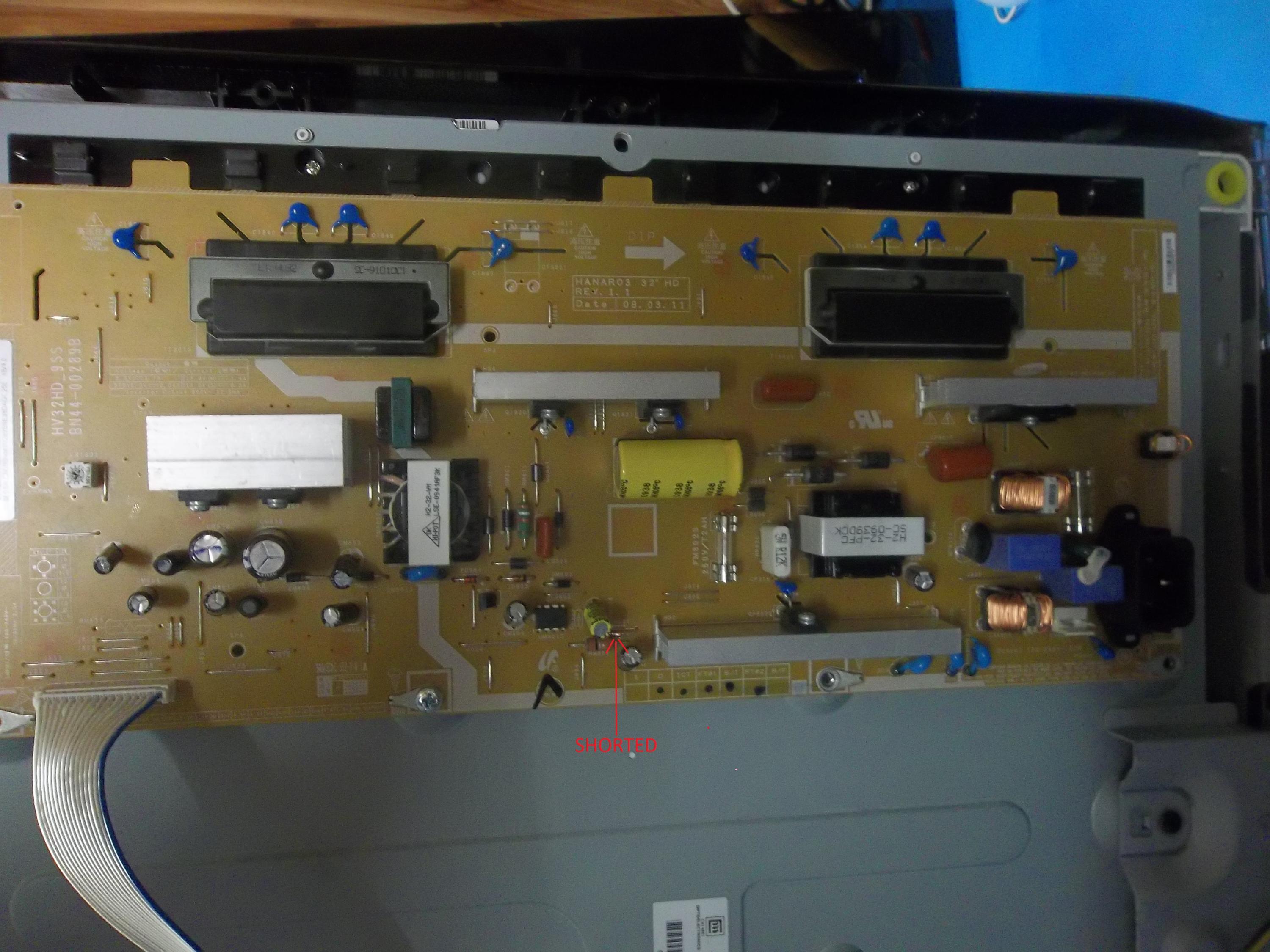

        Greetings everyone.
        I have this same problem on the same TV using the same board number BN44-00289B.The TV looks dead and unresponsive. The fuses, to my knowledge, didn't blow.
        In my case, the diodes ZM804, DM852, ZD804, ZD803, as indicated by other people with the same problem to have been the cause of their problems, are in good condition.
        I'm getting the right voltage (177v) at main filter cap, but no voltages at all at any of the outputs (not even stby voltage).
        The resistance I'm getting is 3.5 M ohm on TM 801s' primary without the fuse FM802s.
        Checking IC UM801s this is what I'm getting:
        Pin
        1-Varies from 0v to 0.9v.
        2-0.36
        3-0
        4-178v
        5-178v
        6-NC
        7-Varies from 11v to 17v
        8-GND
        To my understanding the behavior of the IC UM801s is that it's resetting itself due to problems in the circuits before it.
        I'll appreciate any ideas on where to look next.
        I'll continue looking around and update if I find anything.
        Regards,

          Update:
          I just found a shorted diode (ZM801) that's part of the feed back circuit.
            Also check Zener ZD803, 804 for cracked body and short. Also see the bulletin.

              Always appreciate your help @budm. Thanks for the service bulletin. Luckily that diode it references is ok, let's see once I get the tv to turn on.
              As per the zd803 and zd804, as I mentioned before, they're ok.
              So for now I've only found that shorted diode and I'll order it to see what happens.

                      After replacing the diode I got the primary section to somewhat work cause I started to get some output voltages.
                      Situation at the moment:
                      No power, flashing stby led.
                      Readings from CN802 (main output power connector)
                      Pin
                      1-gnd
                      2-sync 0v
                      3-Det-5v varies from below 0v to 3v then down and up to 4v
                      4-E-PWM varies from below 0v to 3v then down and up to 4v
                      5-Inverter on/off varies from around 2v to 3v
                      6-13v(m) around 6v on and off
                      7-13v(m) around 6v on and off
                      8-gnd
                      9-5.3v varies from around 2v up to 5v
                      10-5.3v varies from around 2v up to 5v
                      11-gnd
                      12-gnd
                      13-13v(s) varies around 6v
                      14-gnd
                      15-stby 5.3v varies from around 2v up to 5v
                      16-Pwr on/off varies around 0.7v
                      Checked all six electrolytic caps on the secondary side and they're all good for esr and capacitance.
                        #31
                        OK, so the standby power supply 5.3V and 13V are not stable after replacing the shorted out Zener diode ZM801 at the FB pin2 of IC UM801.
                        It looks like it is starting up and shutting cycle, one can be the startup caps CM804 47/50V, CM808 22/50V. Check or try replacing them

                            Ok, I found my problem. It was the PC802S opto isolator ic needing to sit better. In the beginning while fooling around I removed all three of them to check them out then this one had one of the legs rather lifted (good thing I have microscopes) and was not making good contact with the pad.
                            So to resume, in my case the only problem was the shorted diode ZM801.
