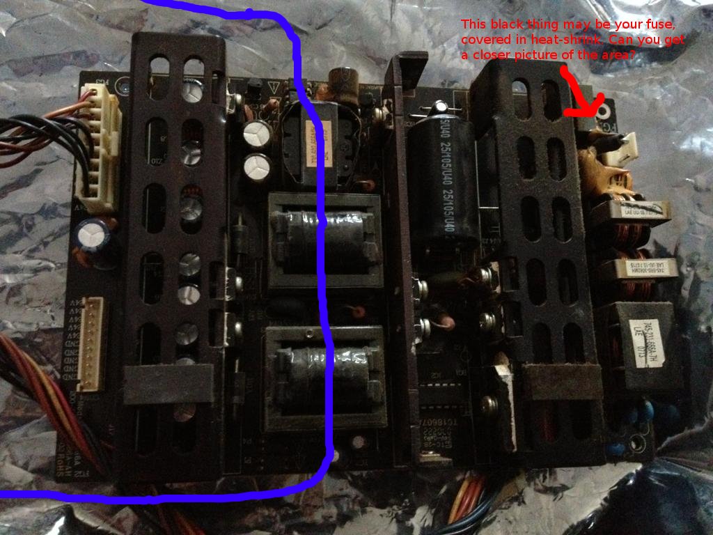

    I bought this yesterday to mess with. There's no lights, no buzzing, nothing when it's plugged in. I'm a little too amateur to use a multimeter when it's plugged into the mains so I've not tried.
    The PSU board looks burnt out. The metal shield above it was brown, as is the underside of the board. Some of it was dust, and some came off with electrical cleaner, but not all. A lot of the solder on the bottom looks discoloured too.
    The top of the board is here, and the bottom is here. That large capacitor on the top (labelled 25/105/U40) has both solder joints discoloured (the other bad joints looked to be from the heatsink?) so I was wondering if I should try to replace it. The top of it wasn't domed, but the plastic above the top was (chipping the plastic off shows the metal top to be flat).

    Re: Polaroid 32in LCD FLU-3232 no power
    It's fairly common for the plastic dome to bulge on those bigger caps, but unless the metal vent underneath is bulged, the cap is fine.
    There's little danger in testing the secondary side of the power supply. The secondary is the side which is plugged into the main board and other boards in the TV. The highest voltage you'll find there is about 24V, which isn't even enough to tingle. On the other hand, the primary side (mains side) has a large 400V or 450V capacitor which can be substantially charged, so this presents a potential shock hazard. In addition, be careful not to touch any heatsinks with power applied, as they are potentially live.
    My tips:
    - Unplug the TV
    - Test the main fuse using your DMM. Use the 200 ohm range; you should see close to zero ohms. If the reading doesn't change (stays at what it is with the probes not touching), then the fuse is blown.
    - If the fuse is blown your prime suspects are the bridge rectifier and power MOSFET, but the fuse can sometimes fail without due cause (simply thermal stress or by being underated.)
    - If the fuse is okay you need to look elsewhere and begin testing the secondary output voltages, for example the standby.
        These are genuinely rubbish TVs in my opinion. Was the main board and PSU in a metal cage? That will slowly but surely cook the power supply caps.
        Anyway, there are more fuses than the plug fuse. I think this might be a fuse, highlighted with the red arrow. Can you get a closer pic around here?
        The secondary/24V (safe) side is highlighted below in the image using the blue ring.
        For the secondary side you don't need to worry about the capacitors as they don't have a sufficient voltage to cause harm. Touching the 450V capacitor will hurt a lot though, so just keep away from it. Usually it will discharge in 30 seconds after power is unplugged but if there's a problem on the board somewhere it will sometimes not discharge. I have touched one before accidentally, it is just a sharp, short shock but it can make you throw the power supply out of your hands by reflex action!

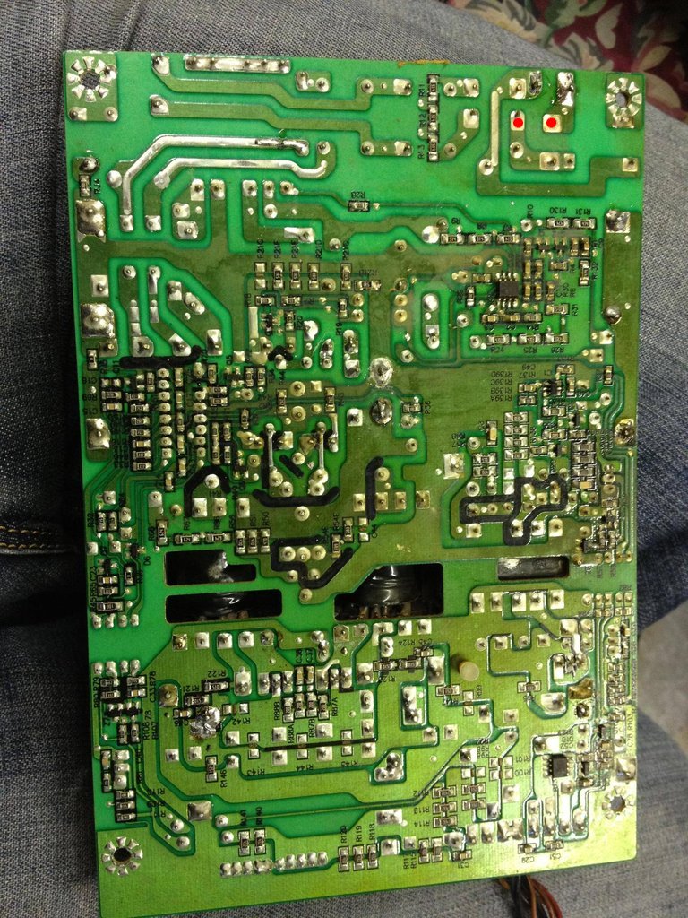

                One other thing I forgot to mention is that I used the multimeter on that labelled socket on the "safe" side of the PSU. It was labelled 24V so I used 40V DC on the multimeter and placed one pin on inside the plug where it was labelled 24V, and the other on the part labelled earth, and there was no response. I tried both ways round, and I also tried AC. It looks like it's completely dead at that side.
                      Ugh, this is one thing I hate about them, too cheap to afford a socket. You can test it with your digital multimeter.
                      Unplug the board, wait 30 seconds, set meter to 400 ohm scale,
                      Test across the marked position. (The upper two terminals, you can see the isolation gap. Not the lower two ones (admittedly my diagram is a little unclear.))
                      If the fuse is good, you will see close to zero ohms (0 to 2 ohms.)
                      If the fuse is bad, the meter reading will not change or it will be very high.
                      Also check if your meter is functioning correctly by touching the probes together. You should see close to 0 ohms as well.

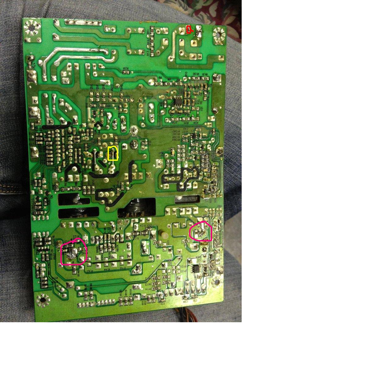

                        OK - I think this is going to be a learning experience for us all. Do you want to say which town you are in or would you rather not? (just for advising re parts)
                        Two easy rules Measuring resistance = Power off
                        Measuring Voltage = Power on
                        Have you tested the fuse? - power off meter on ohms 200 one probe on each fuse contact should read 1 ohm or less - same as touching the probes together.
                        I have marked up the back of the board - red joint needs resoldering
                        Cant tell what has happened on Pink sections - can you tell if they are ok or post close ups. Pink block again check this out is it touching - should it?
                            £20 ain't bad for a 32" actually.
                            Just to be sure were you testing across these two terminals? (clearer diagram this time.)
                              selldoor, thanks again. I'm in Rossendale, Lancashire. I don't mind waiting a few days for parts if they're reasonable off the Internet. I tried the multimeter (with 400ohms) for tom66 and reported it above.
                              Thanks for highlighting the solder joints. I'll redo the red one next time I heat the iron up. The left pink one is here - that one is actually my fault, I tried resoldering it with my shoddy cheap soldering iron (the tip doesn't get hot, only the side) and I couldn't get it all up. I don't think it bridged the gap there, but I'll heat it up again and take it further away. Sorry for the poor focus of this one, my phone just refused to do better.
                              The bottom right one is here, and the yellow one you highlighted is here.
                              Once again, sorry for the quality of these photos. For some reason, once I get close to the board the phone just drops focus completely. If you download the raw one of the board from imgur you might be able to zoom quite well.
                                  tom66 - I thought that's what you meant, thanks those two terminals aren't from the bottom of the fuse, is that okay? I tested those two last time, and I get:
                                  No connection - 0L.
                                  Touching two prongs together - 00.5 (but fluctuates 00.4 to 00.6 between tests)
                                  Touching across terminals - 00.6 (but fluctuations 00.5 to 00.7 between tests)
                                  Touching across the two solder joints from the fuse itself: 0L.
                                  So it looks to go up very slightly. Note though that I just removed one side of the fuse so it's not connected, and then retested and it did exactly the same thing. I assume this means the fuse is blown?
