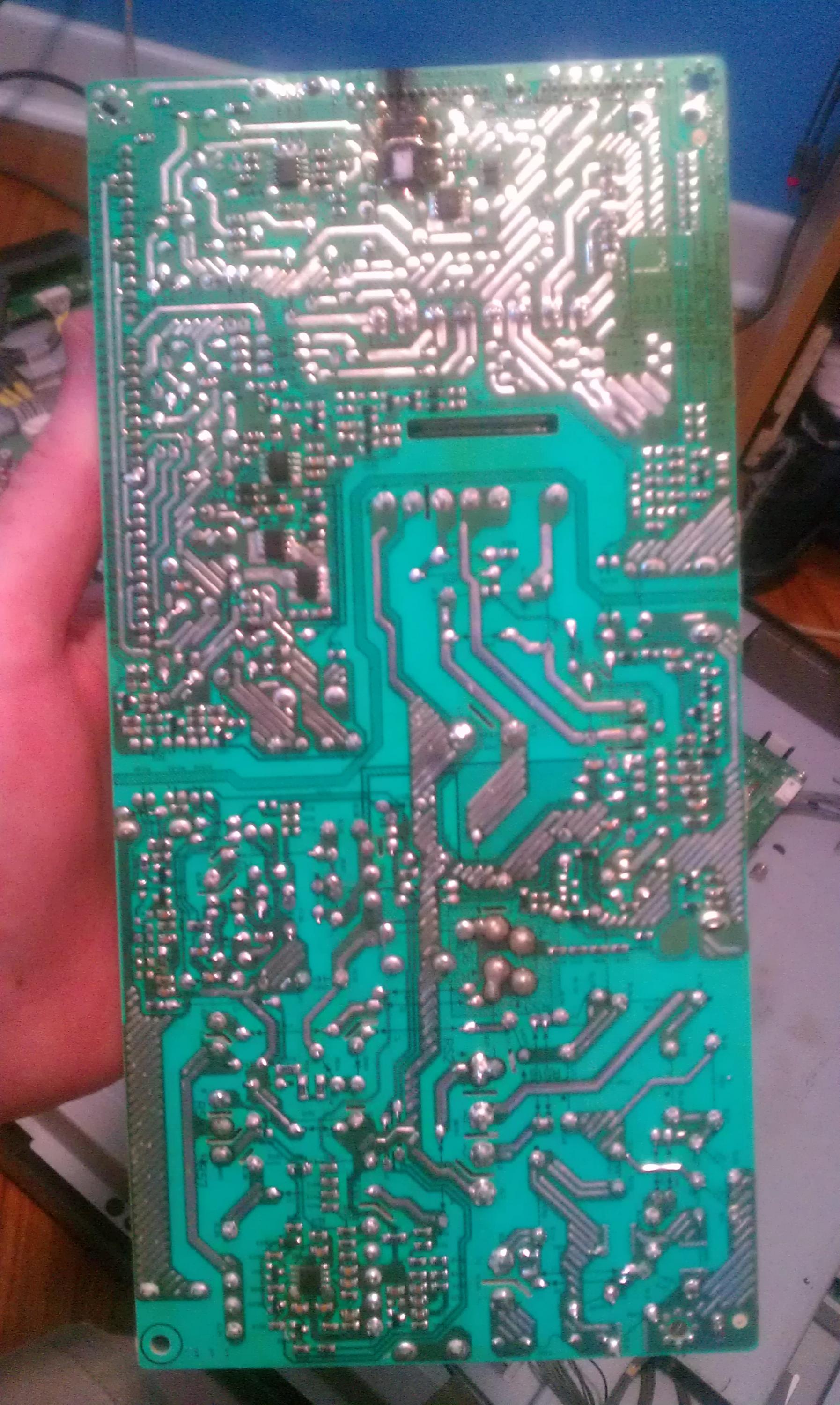

        Can you unplug the TV, wait 30 seconds, then remove the power board and take a clear photo of the under side (green side?) From memory there are MOSFETs providing 6V, which could short-circuit.

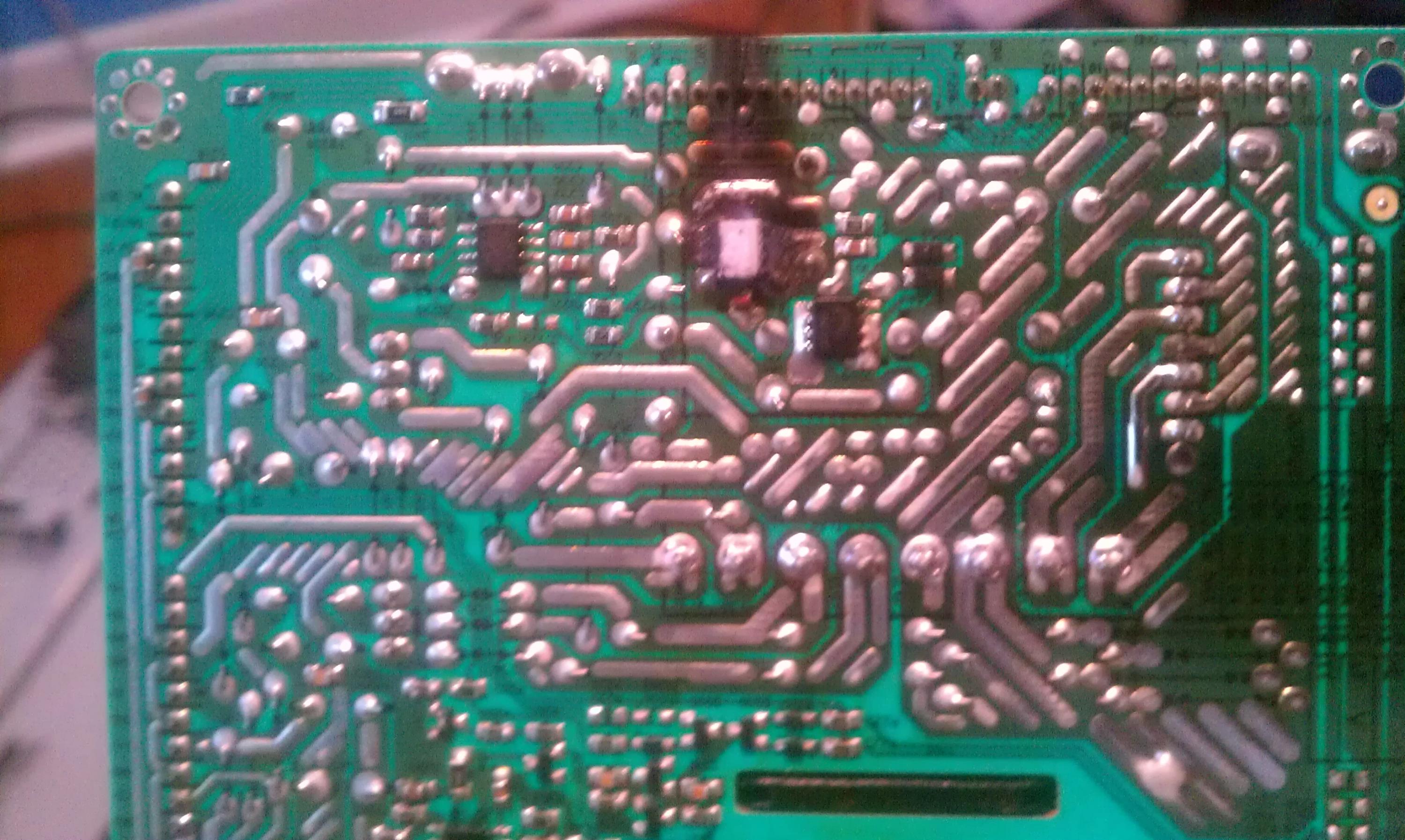

          Okay, well there is definitely a blow out! This must have been the problem the whole time.
            Re: LG 37LC2D No Sound, and No Channels
            There is also a rattle noise coming from the board when I shake it. Sounds like something is loose inside of something else.
              Yeah, these TVs have always amazed me - the power board can have a severe failure and the TV still mostly works. That right there is a MOSFET which has had a bad day.
              The damage is likely to extend further than that MOSFET, so I would say getting a new PSU would be the best option, unless you want to repair 20 other SMD components.

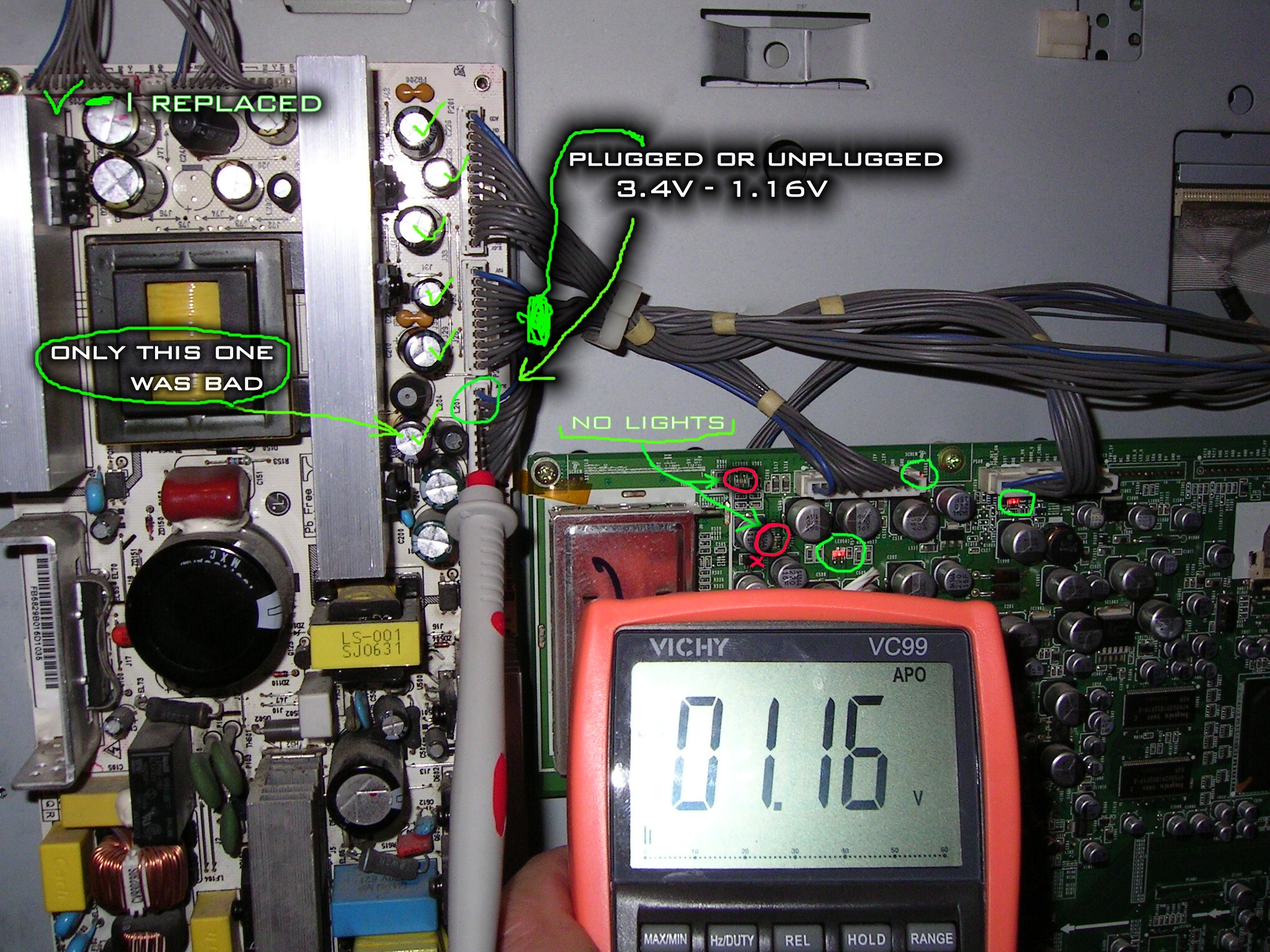

                      Hello, I have a similar problem, no sound.
                      Just voltage on 3.4V is incorrect
                      3.4V-1.16V
                      Middle connector unplugged 1.16V
                      I had 1 bad capacitor, after replacement most of them except 3800uF ( green V mark) beside connectors, no difference
                      When the TV is off few hours sometime the sound is back and the led beside 'x' is lighting. After a few minutes the sound is cracking and getting off then I see this LED gets dark and off
                      Any help is much appreciated !

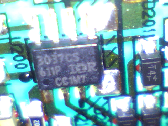

                        My personal theory is the buck converter IC is failing (8pin SMD on bottom of PSU board) but I've never been able to confirm such.

                            Yes, the one without the large copper areas connected to it, it is the controller chip.

                              3037CS
                              611P
                              CC1M7
                              On which number i should look to find one?
                              I found one, it is same or different? I looked at no. 3037cs
                              "8-PIN SYNCHRONOUS PWM CONTROLLER" http://www.datasheet-photos.com/ProI...tNumber=3037CS or here: http://www.aliexpress.com/wholesale?...20130813071852

                                  tom66 thank you for your time. So just the no. 3037sc is important? no matter which i will get just must be 3037sc because is see they have different numbers below
                                    #37
                                    The other numbers are production/lot codes, so not usually important.
                                      #38
                                      One thing to make sure is that you get the SO-8 or SOP-8 size which matches your board (compare the ratios), not the MSOP, or other sizes.

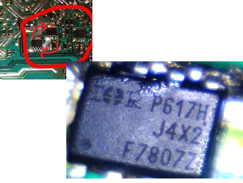

                                          I replaced 3037sc but no result
                                          After this I swapped this 2 smd beside 3037sc [ 2 are the same] they going there where was a bad capacitor and now 4th red led is on but I think not bright enough.
                                          You think it could be the problem?
                                          Look at the picture, I should look for ic smd IRF7807Z or other numers? http://www.ebay.ie/itm/IRF7807Z-INTE...item2ec7bba515
