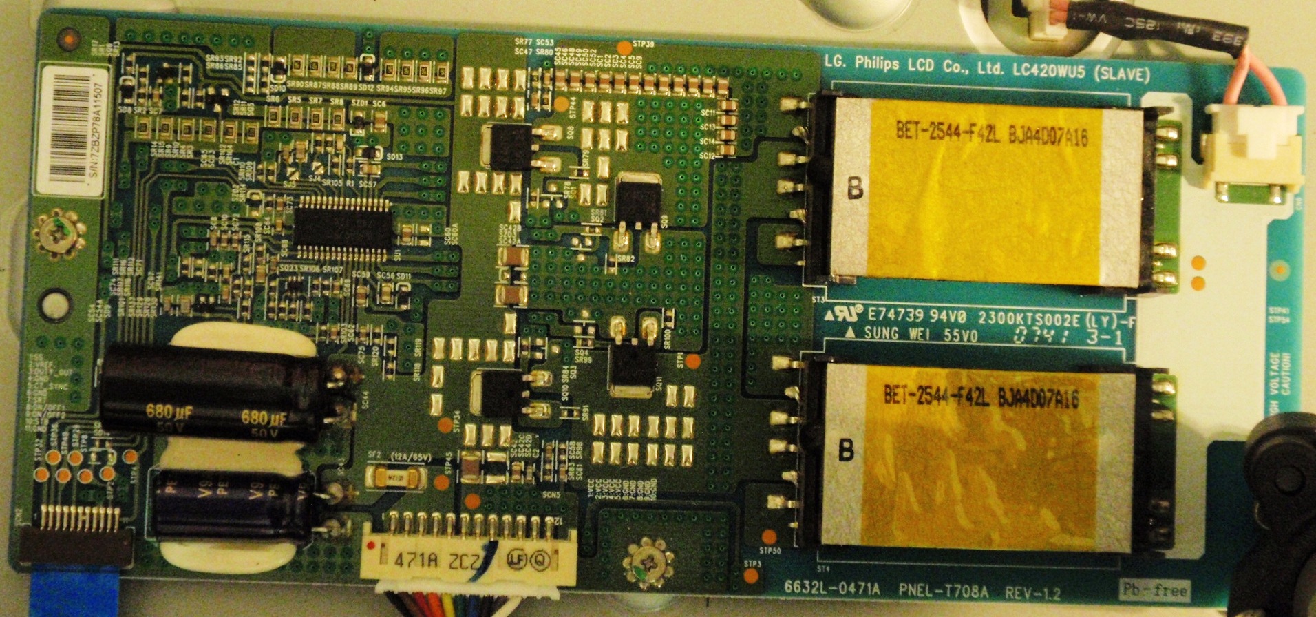

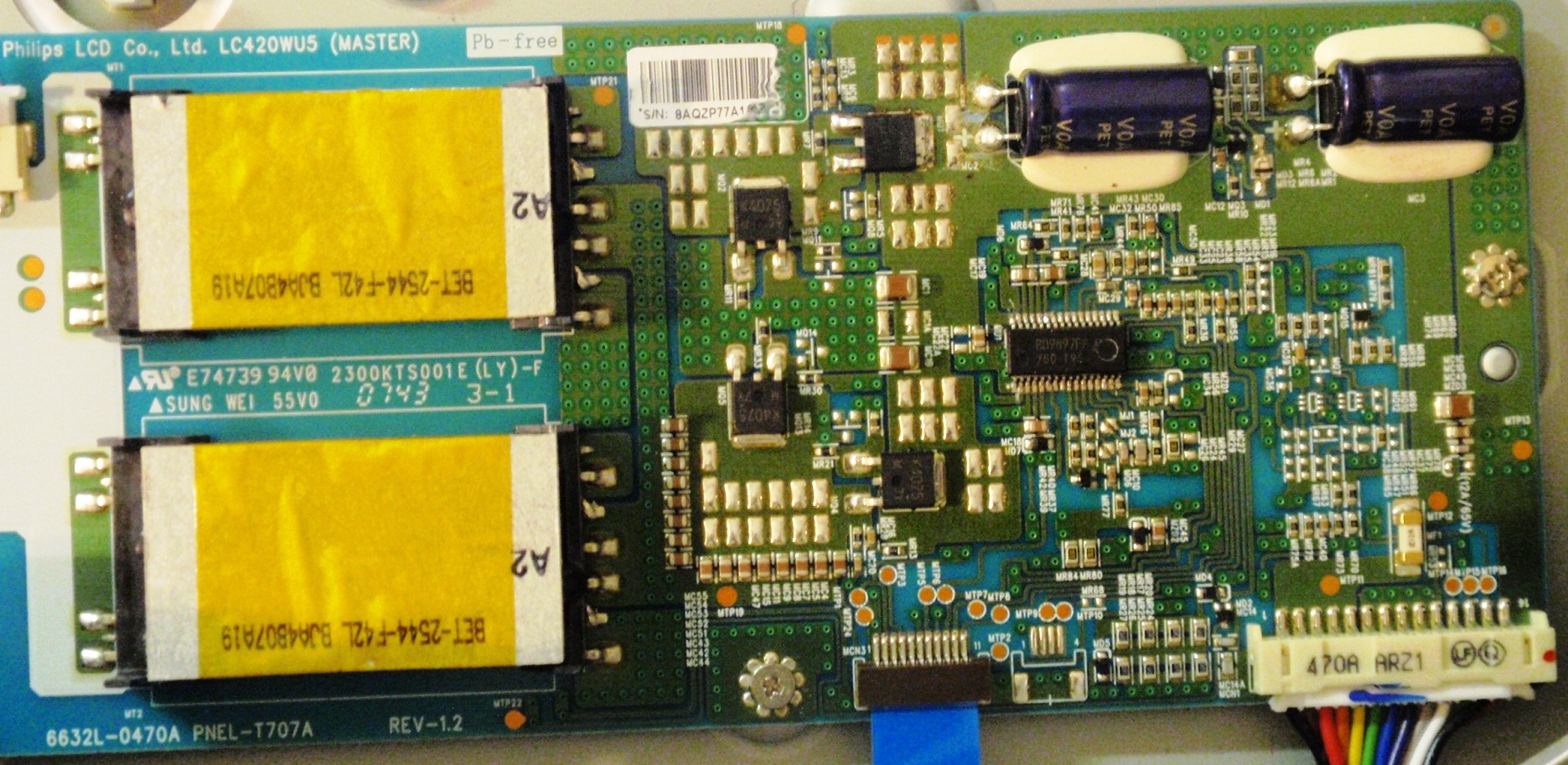

    I'm working on this Vizio and I'm puzzled that what it's wrong with it.
    Usually the slave inverter it's the problem, but this time the 8.5K values at the fet transistors were there and the chip looked OK. One of the caps was bulged, which I have replaced.
    I have found a low value on one of the fet transistors on the master inverter(even after removal).
    Replaced the fet and the value it was still low, it got a bit higher, but it was still very low(76 ohm), so I have replaced the chip and it became 8.5K.

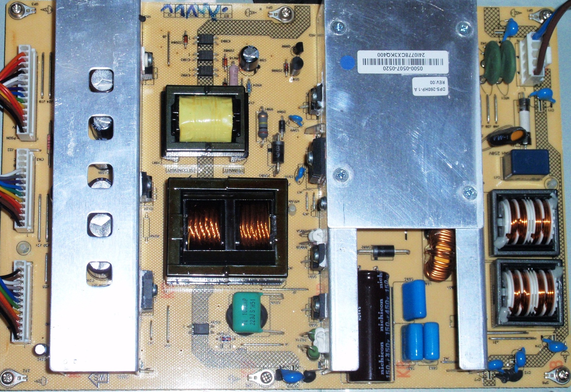

    I have done the bulb test on the power supply and check out OK.
    The voltages are there and still no sign of back light(at least).
    The blue LED comes on for like three seconds on the master inverter board, the Vizio logo works as it should, with the buttons.
    What else can I check?

          Re: Vizio VO42L question
          The 3.3V is there as all the other voltages on the power supply.
          The TV can be turned on and off, there is no problem there, in fact the TV acts as everything it's OK. But there is no sign of life from the panel.
          Vizio logo turns white or orange if I turn it off.
          The voltages are there, the blue LED turns on and then off on the master inverter.
          I'm trying to see a picture with a flash light, but I can't see any.
          Usually on these TVs the slave board has issues, but this time I had problem on the master inverter.
          How can I check if the BD ICs on the inverters are working?
          I have replaced the master IC since after replacing a shorted FET it was still reading very low.
          Now all the FETs on both boards are showing 8.49-8.51 KOHM.
          After checking with a lupe my soldering job, I have found a leg not soldered to the PCB tab. Do you think that it's possible that the IC it's not working properly because of this?
          Another question, how do I know if the slave IC it's working properly or not?
          Do you think that it's worth checking the regulators on the mainboard since the TV turns off properly?

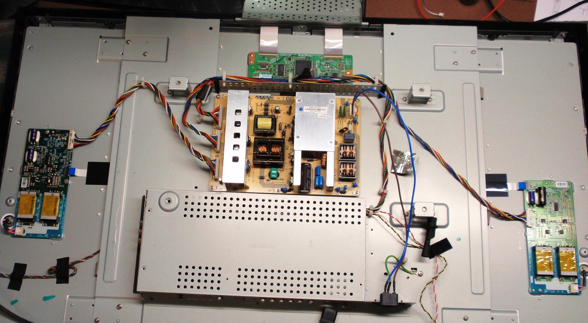

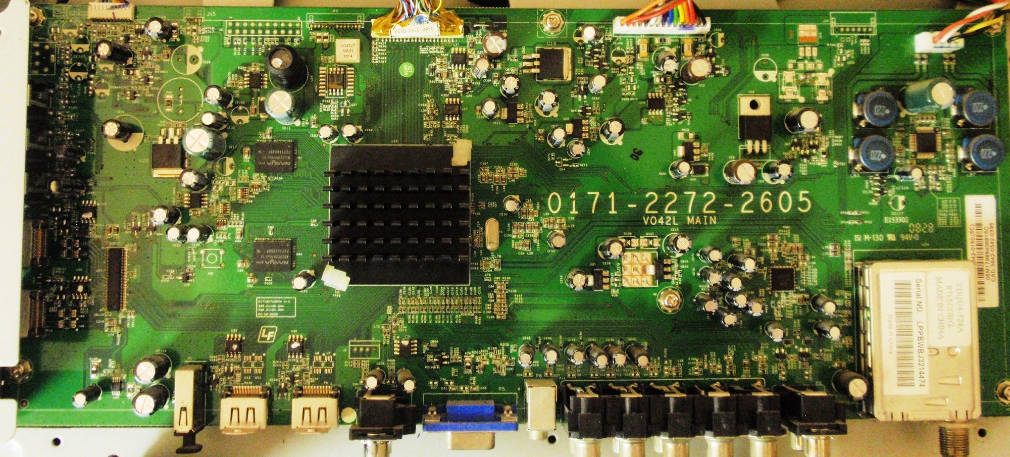

                  Not sure what happened, but it is back in the same stage as before, after removing the mainboard for taking pictures.
                  I have all the voltages at the PS connectors. The blue LED comes on on the master inverter board and the Vizio logo turns white or turns orange when turned off.
                  I have checked all the regulators and here are the voltages.
                  U16: 11.84V/0.00V/5.02V
                  U44: 11.84V/9.59V/8.35V
                  U22: 5.12V/3.35V/2.10V
                  U17: 5.07V/3.36V/2.10V
                  U21: 2.54V/1.16V/0.00V
                  U??: 5.07V/2.54V/1.27V
                  U20: 3.30V/1.81V/0.56V
                  STBY: 5.52V
                  PSON: 3.30V
                  A: 2.58V
                  B: 5.07V
                  12V: 11.88V
                  24V: 25.05V
                  Next I will be uploading the pictures.
                  I have a question until then, how do I know if the BD9897FS are OK?
                  If the FET transistors have the 8.5Kohm, then they should be OK?
                  I have received the shipment from Digikey, so I will be replacing the four capacitors on the inverter boards.

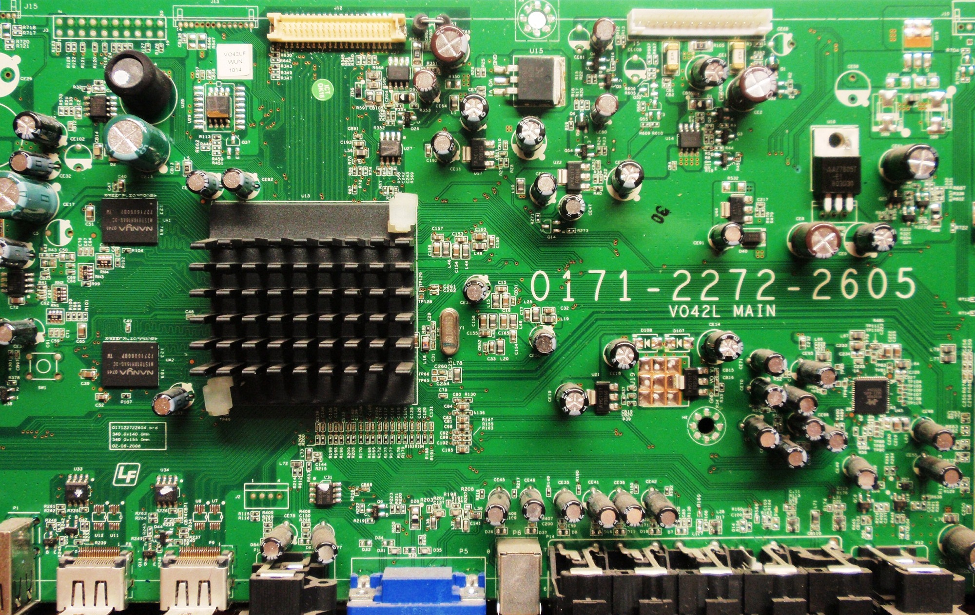

                    Here is the mainboard picture:
                      I think U21 is bad. If the top tab is "up" or north, it looks like you are numbering the pins right to left.
                      From your pic, it looks like the part number is AMC1117 which is an adjustable voltage regulator. I just wrote about this, again, 2 minutes ago, so I will cut & paste from
                      https://www.badcaps.net/forum/showpo...7&postcount=50
                      The correct output for pin 2 (middle) is based on this calculation:
                      DC V of pin 1 + 1.25V = output of pin 2.
                      So 0 + 1.25 should be the "correct" output. You have 1.16V. Most specifications for regulators are +/- 1%.
                      At 1.16, it is (1.25-1.16)/1.25 = 7.2% out of spec (see post #6 last paragraph).
                      The same above URL gives a replacement part number.
                            I'm an idiot, I have re-checked my notes and it's 1.26V, so it's OK.
                            How do I know if the inverter ICs are OK or not? The FET transistors have the right 8.5Kohm. But you are right that it's very possible to have something on the mainboard also. I should see something on the screen if only the inverters would be the problem.
                                      I have replaced the IC on the slave inverter and there is no change.
                                      Panel seems dead.
                                      How do I know that the inverters are working?
                                        I guess you can measure the voltage on the FETs and see if there is any voltage on the Gate, Drain and Source.
