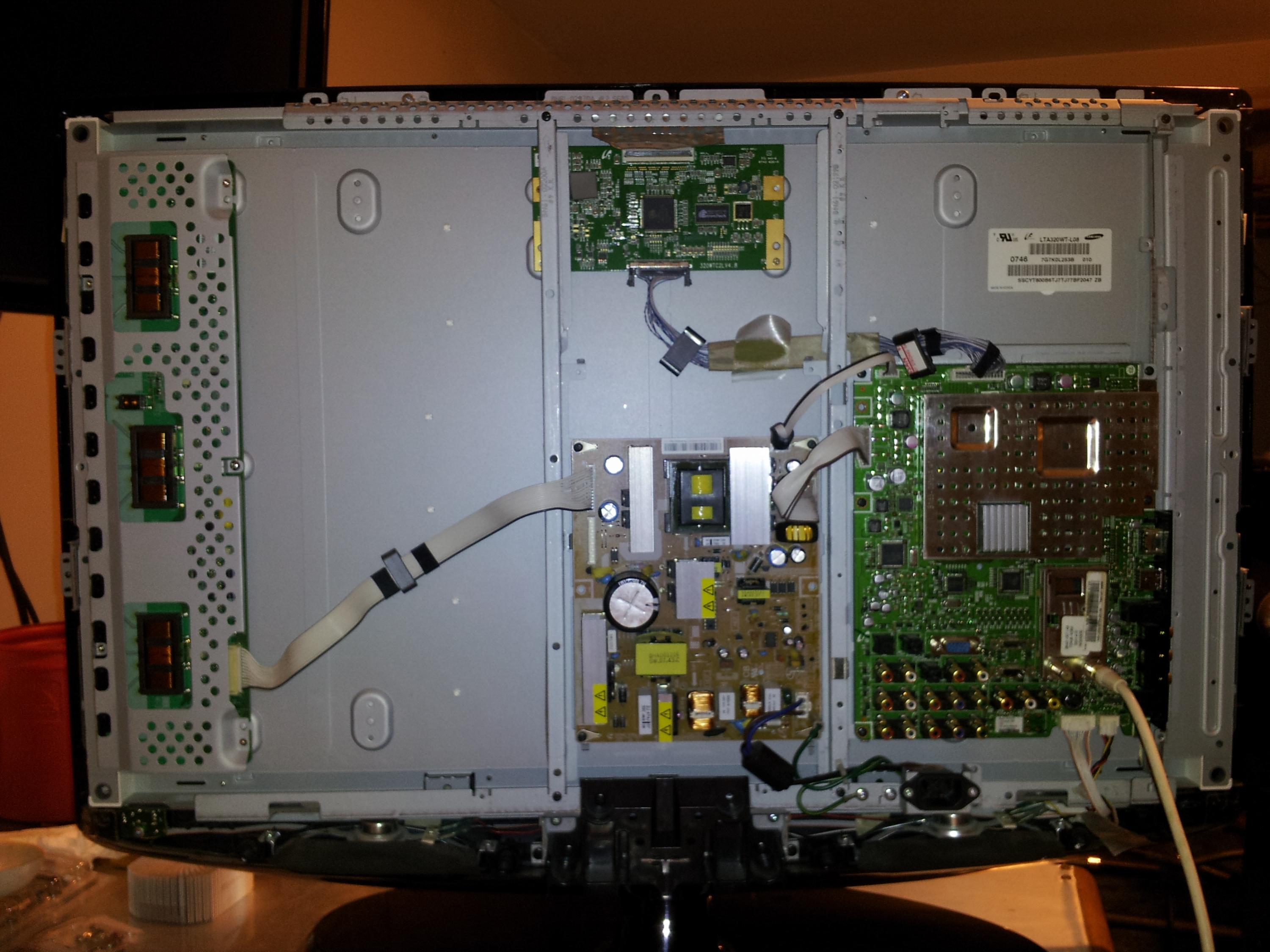

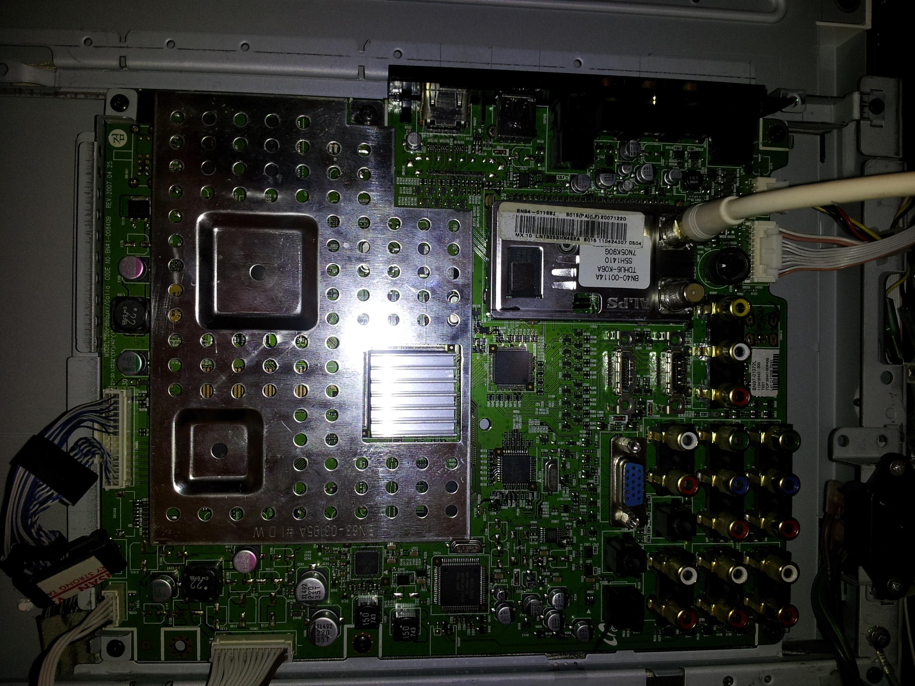

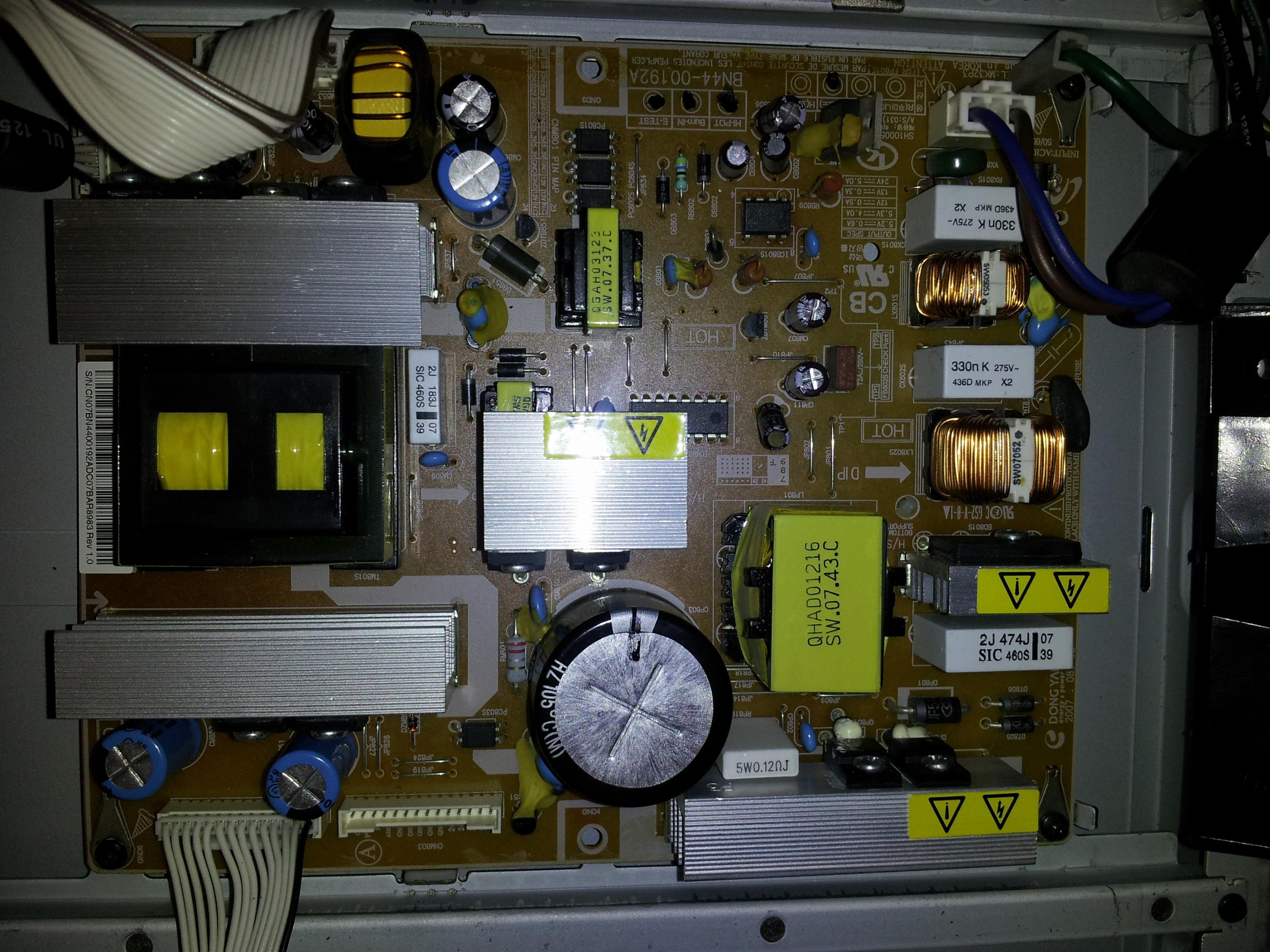

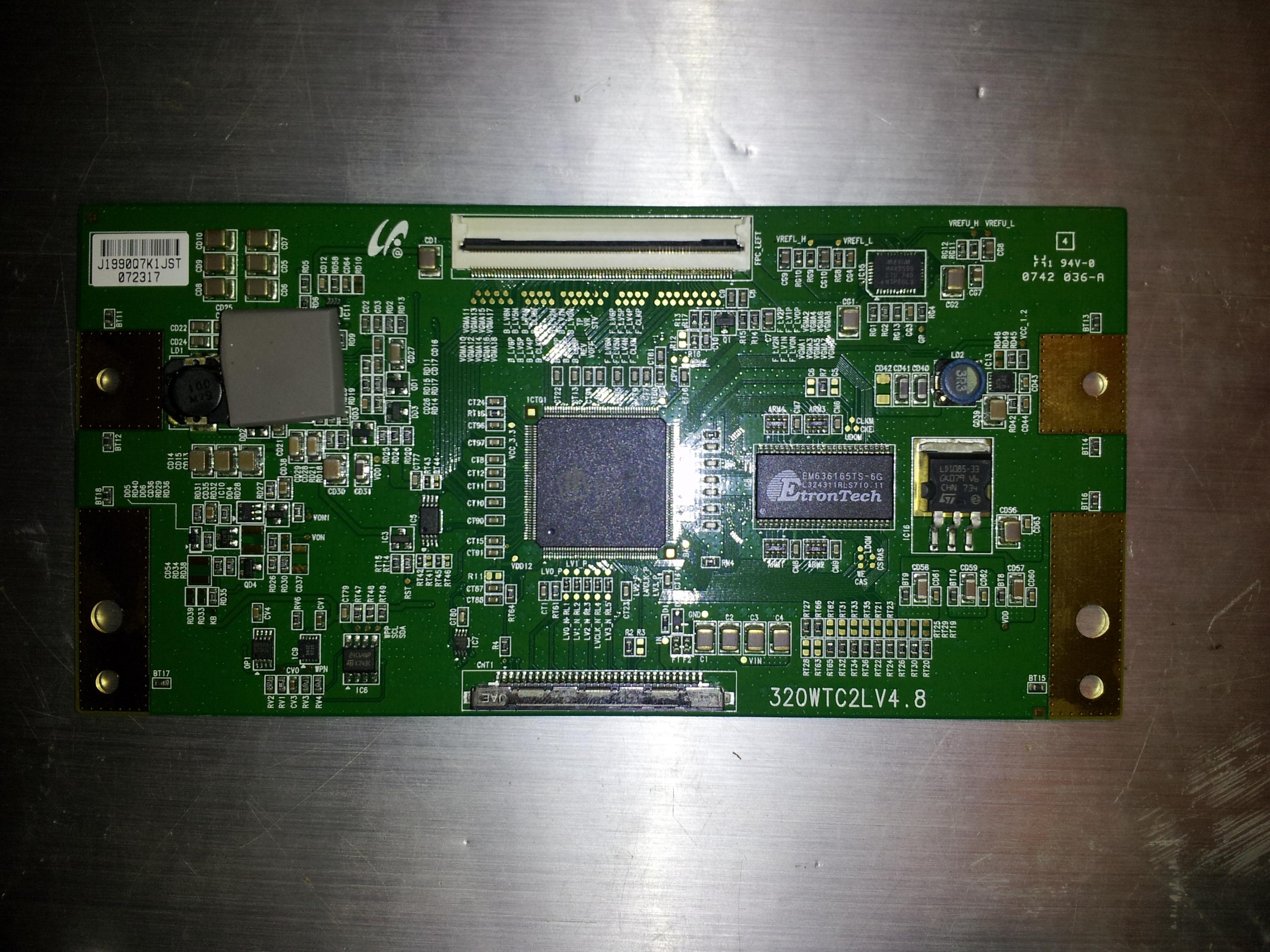

Samsung LNT3253FX/XAA no picture with sound
  • bullmastiff135
    • Jul 2012
    • 11
    Samsung LNT3253FX/XAA no picture with sound
    First of all Hello everyone and yes I am new to this forum, but not new to broken TVs and computers. I am a Asst Tech manager at a computer shop here in MO. I have been lucky and fixed 3 of these broken Samsung TVs. I just got this from a friend about a week ago he works at a recycling place and gave it to me. Well the good old TVs has sound dim back lights and no picture also has no blown caps on power board. I think i have a bad fuse on my t-con board not sure might be the main board. I see that there has been post of the same problems but never seen the fix. I need some help guys and thanks in advanced going to post some pics
    Re: Samsung LNT3253FX/XAA no picture with sound
    So the screen has a slight glow to it if you have darkened room, or you can see the backlights through the holes on the back of the LCD panel? If you do, then you backlights are OK, then it can be T-CON with blown fuse or not getting the 12 or 5V to it.
    • bullmastiff135
      • Jul 2012
      • 11
      Re: Samsung LNT3253FX/XAA no picture with sound
      Thanks for reply yes it has both slight glow and can see all the lights in the back of the tv and audio. Here is some pics and thanks again
        Re: Samsung LNT3253FX/XAA no picture with sound
        Check F1 and F2 (at the right of the bottom connector) and also use the Ohm meter to check C1, 2, 3, and 4.
        • bullmastiff135
          • Jul 2012
          • 11
          Re: Samsung LNT3253FX/XAA no picture with sound
          Hello I checked what you said with multimeter F1 fuse is broken no beep F2 beeps ok and C1, 2, 3, and 4 ok all same ohms. What should I do next jumper the fuse and test or replace it. Thanks again
            Re: Samsung LNT3253FX/XAA no picture with sound
            Check from both ends of the fuse F1 to the metal chassis. You should see a very high resistance if only the fuse is at fault, but if you see a few ohms (<2 ohms) there may be a problem on the T-con.
            • bullmastiff135
              • Jul 2012
              • 11
              Re: Samsung LNT3253FX/XAA no picture with sound
              Thanks for all your help I am at work right now I had brought the T-Con board in with me but the TV is at home. I will try the ground test tomorrow and get back with you. One more question what if I just soldered one wire to both ends jumper and tried it???? Just wondering if it would do any other further damage to the Tv !!!
                Re: Samsung LNT3253FX/XAA no picture with sound
                Originally posted by bullmastiff135
                Thanks for all your help I am at work right now I had brought the T-Con board in with me but the TV is at home. I will try the ground test tomorrow and get back with you.
                You can test relative to the screw hole metal pads too.
                Originally posted by bullmastiff135
                One more question what if I just soldered one wire to both ends jumper and tried it???? Just wondering if it would do any other further damage to the Tv !!!
                In the worst case it would probably emit a little smoke. It's possible it could damage the main board but I'd call it unlikely. The best option is to use a 3 amp mains or automotive fuse.
                • bullmastiff135
                  • Jul 2012
                  • 11
                  Re: Samsung LNT3253FX/XAA no picture with sound
                  Thanks a million ran jumper on the broken fuse and the system has been working for two days now. MAN YOU ROCK thanks again
                    Re: Samsung LNT3253FX/XAA no picture with sound
                    That is good that it did not have any shorted out parts on the board.
                    You can get the new SMD fuse and just piggyback on top of the old blown fuse and solder both ends of the new fuse to the old fuse.
                    • TR103
                      by TR103
                      - it keeps rebooting
                      01-22-2025, 04:12 PM
                    • Mgiffune
                      by Mgiffune
                      06-09-2024, 10:28 AM
                    • Ierwin
                      by Ierwin
                      05-13-2025, 03:31 PM
                    • jchang
                      Samsung UN70NU6900F no picture and no sound
                      by jchang
                      Hi all
                      I was just given a Samsung TV with the issue. I read various threads and videos and attempted the ribbon tape method to gain an image, but no luck.
                      Symptom:
                      No picture no sound.
                      When I plug in the power cord, Backlight LED turns on for a half second and then turns off. The red LED next to the power button located center bottom flashes 2 or 3 times. When the power button is pressed after, it does the same thing.
                      No sound at all.
                      What I tried:
                      1. I tried unplugging the left or right ribbon...
                      01-09-2023, 06:28 PM
                    • Dodgethis
                      Samsung QN75Q6DRA, No Picture, Has BL, and Sound
                      by Dodgethis
                      Hello all,
                      This is my first post, but long term lurker on the form learning as much as possible about these TV's. I was given this TV as due to a power outage of constant On/off of power to TV. The TV originally would just click on and off (Typical Reboot Cycle). I opened the back of the TV, and troubleshooted by taking the 96 pin LVDS off one at a time to see if I had a picture on either side. I finally fixed the reboot cycle by finding the error on the left side of the screen off connector CN 1301, and the TV would stay on. Further troubleshooting led me to the driver boards where...
                      09-11-2024, 07:39 AM
