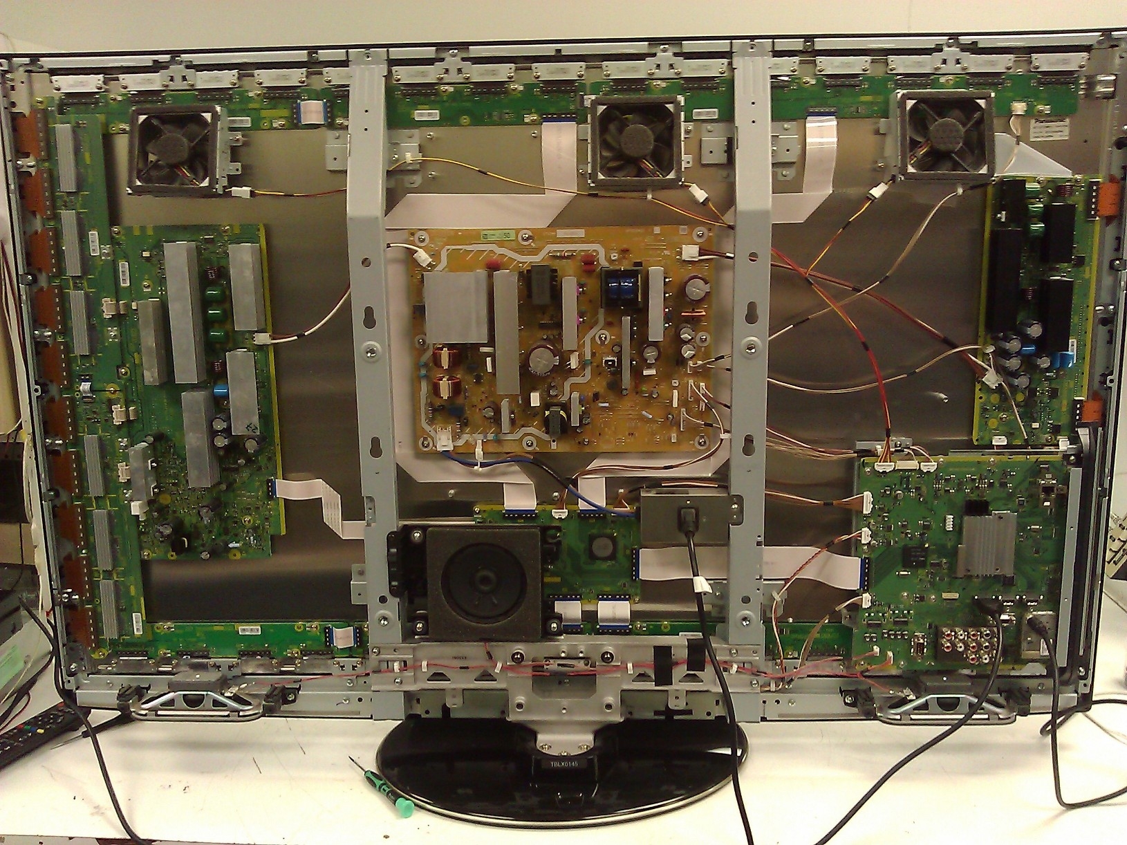

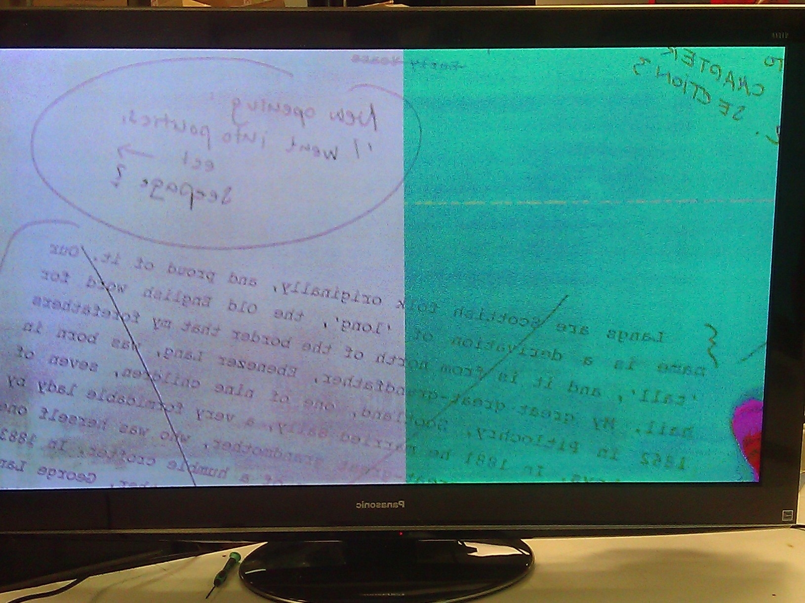

    Plasma Tv flashing when there is a white image
    I have a Panasonic Plasma Tv, model # TC-P50VT25 that is giving some flash of green and red when the image is mostly white or pale. Sometimes there is a line in the middle and from that line all the way to the left the image will flash. I put some photos to have visual on the problem. Took some voltage reading from the power baord to the Y-sustain board that reads 207v when the images is normal but when the image is white and flashing it goes down to 192v. Same on the Z sustain board.Took also some voltage on the buffer board beside the Y-sustain board and they go between 22v to 90v when the problem is there.
    Last edited by BoBGeorge7; 07-05-2012, 10:20 AM. Reason: the second picture is taken from a mirror

    Re: Plasma Tv flashing when there is a white image
    Looks like a D board (PDP Logic board) problem.
    Part# TXN/D1LTUUS
    • BoBGeorge7
      • Jun 2012
      • 5
      Thank you MT.Man i will check on this and order the part
