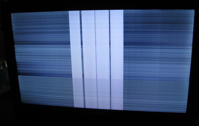

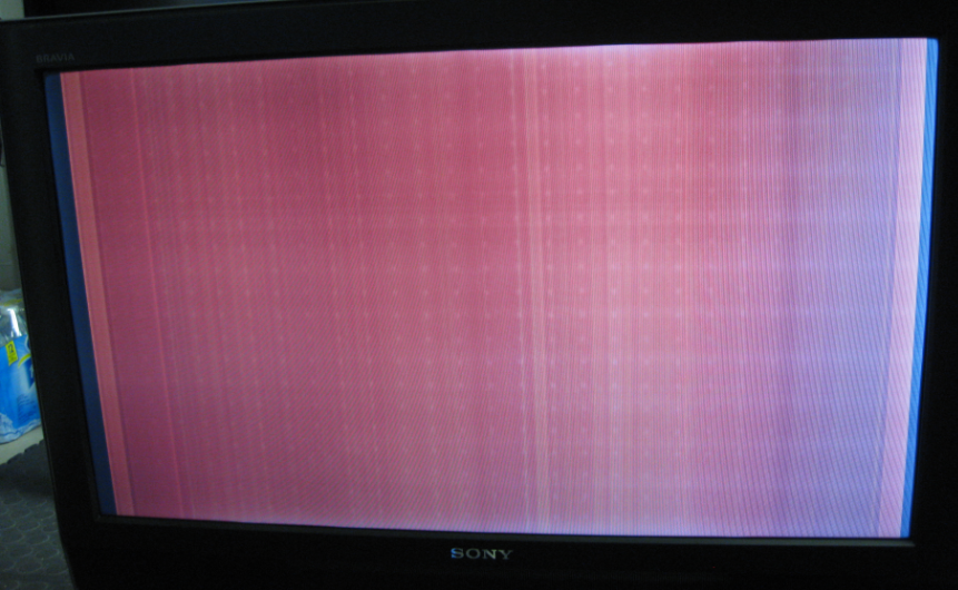

    Sony 32" LCD KDL-32M3000 no picture but sound
    Sony 32" LCD TV model KDL-32M3000 no picture but sound, I replaced the T-Con board (320wtc2lv3.9), but the same problem.
    The first picture is when power up, it's displaying the logo, I guess, then after a while the screen became the second picture.
    I checked the bond / cables, they all look good. Now don't know what to check next.

    Re: Sony 32" LCD KDL-32M3000 no picture but sound
    After replacing the T-con with no change the only two things left that could be causing this issue would be the LVDS cable and main board. I have not heard of these main boards giving problems, however theirs always a first. Sure reminds me of T-con failure. I've only seen two LVDS cable problems, making me pin point the main.
      Was the Tcon board EXACTLY the same model and revision number as the old one.
        Yes, same model and version #
          This set is somewhat known for panel failures. I had one and replaced the T-CON with the same problem. I am more than sure that this panel failed. The four lines is usually T-CON but the rest of the screen is why I am saying that....but hopefully someone can prove me wrong
