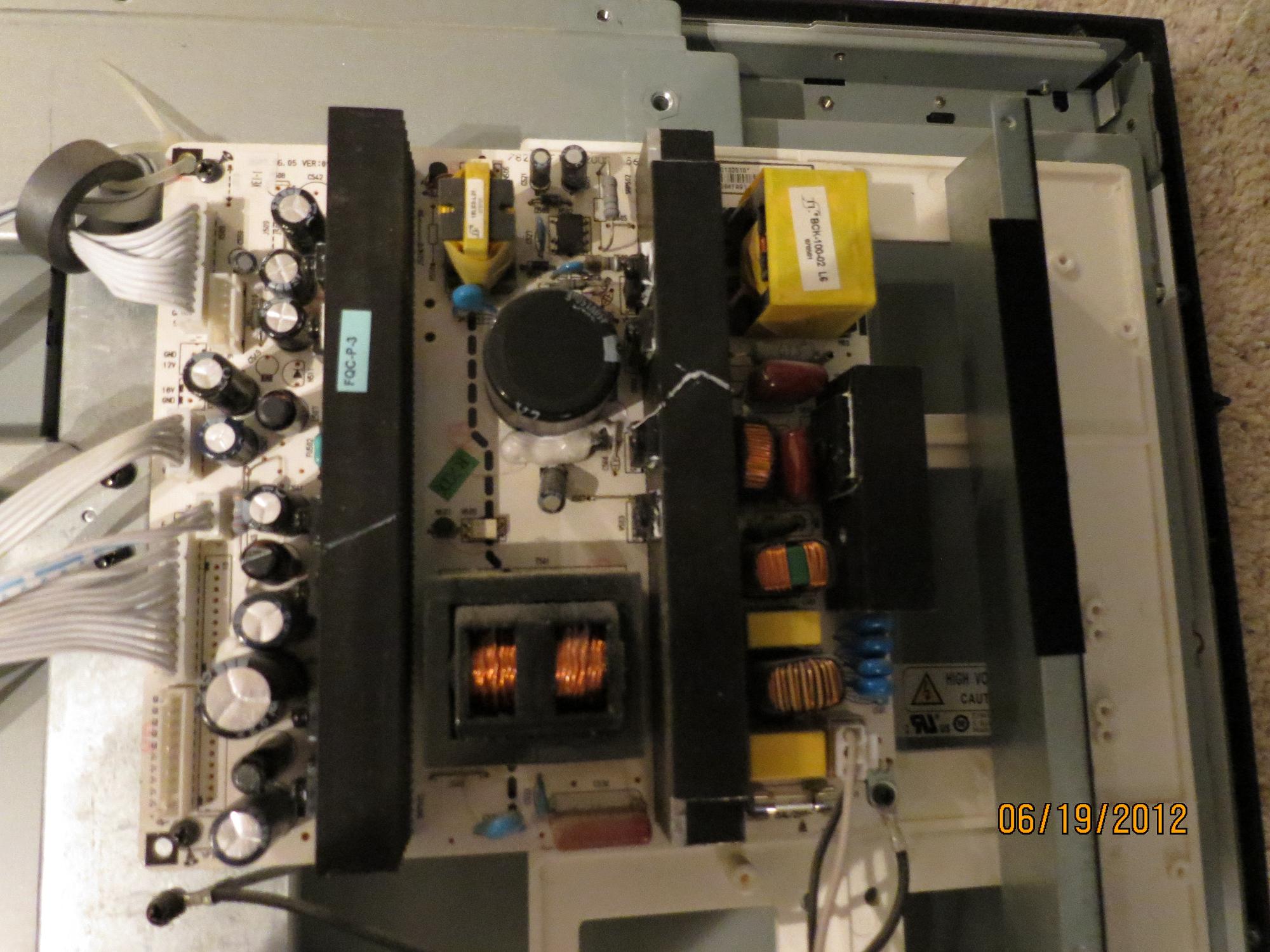

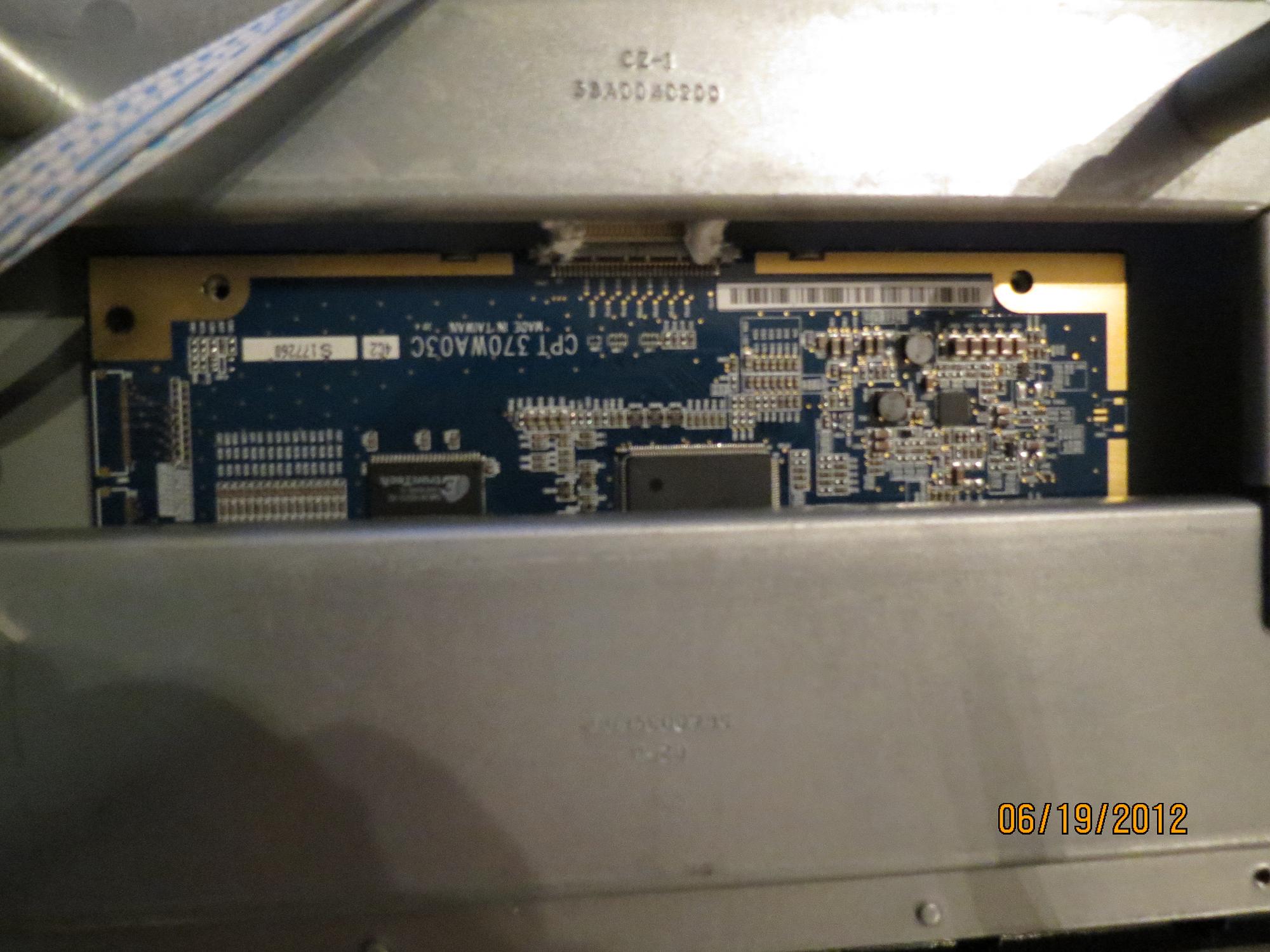

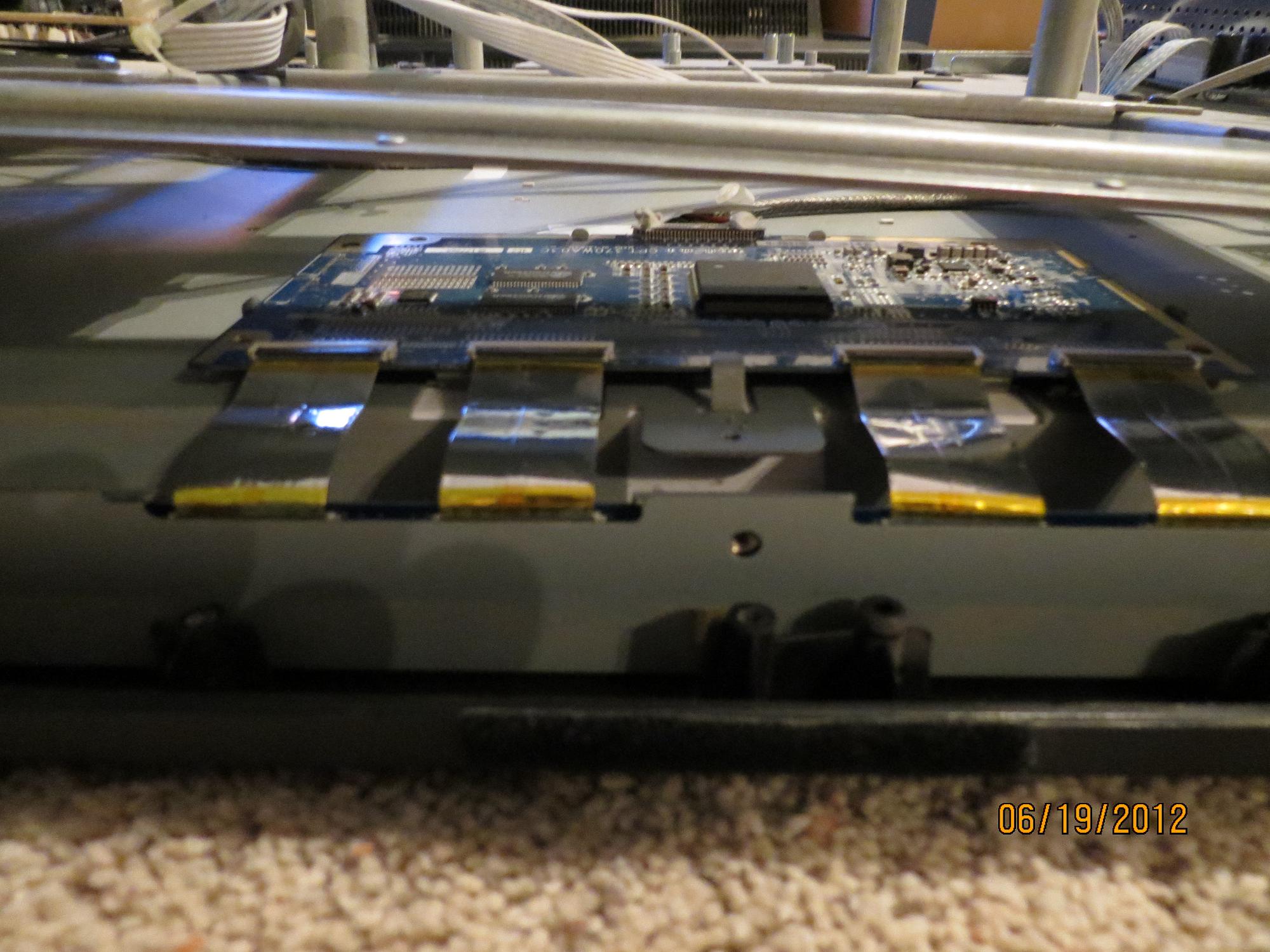

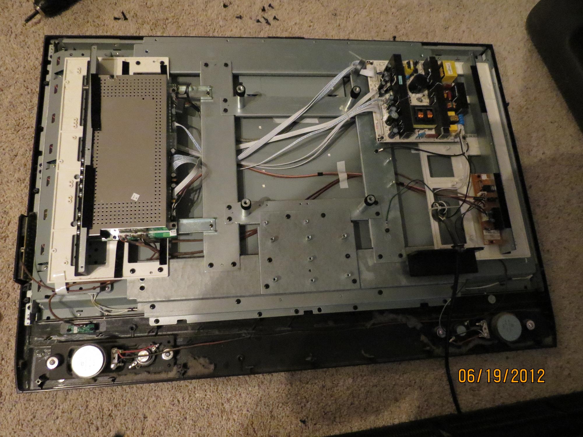

    Got a 37 inch Insiginia, model NS-LCD37. Wife called me the other day and said the tv wasn't working. After checking it out, it seemed the sound was working, but no video. The TV comes on normal looking for a second or 2, then kicks out to darkness.
    I did notice however in a completely dark room, I can make out outlines or very faint images on the screen.
    I opened it up and took pictures to post, but realized I didn't bring the cable with me to hook it up, so I cannot post any pics till tomorrow.
    I didn't see anything that stood out as bad. However, I didn't take everything off. But did look around some.
    My soldering skills are ok, not the greatest. But I have replaced a couple transistors and chips on some crane machines and arcade games I use to collect. So I know enough to probably hurt myself, lol

              Re: Insignia 37 inch LCD, has sound, but no video. What to do?
              Looking at all the boards I could see, I dont see any damage.
              I did pull the inverter board all the way out. Looking online, I couldnt find an exact match on the part #. The part # is VK8A183I0207. Looking online, I can find something close, but not exact. I found a VK8A183I07.

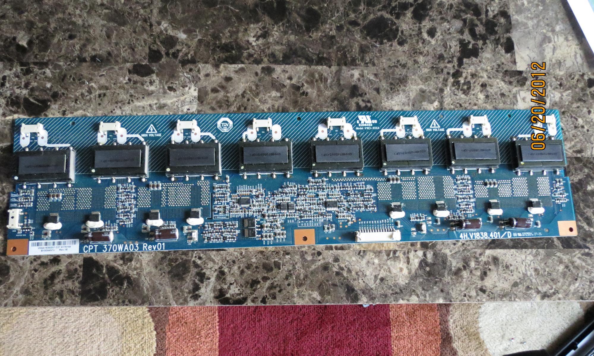

                    Here are some pics
                    • selldoor
                      Slow Learner
                      • Dec 2010
                      • 7870

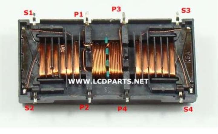

                      I would test the secondary windings on each inverter transformer
                      No power to the board meter on 2000 ohms when you find it check
                      as per pic S1>S2 and S3> S4 No need to remove to check.
                      Post results as follows
                      T1 S1>S2 = xxx ohms S3>S4 = xxx ohms
                      T2 S1>S2 = xxx ohms and so on.
                      SORRY - Set meter on 20,000 ohms these should be just over 2000
                        Actually I cant make out all the part numbers on the transformers but they dont all look the same which is a bit odd perhaps you can list them I thought I saw 6007 and 6004
                        Its the first 5 digits that are important.
                          F1, F2, F3 are good? This board looks like one of those DARFON with bad transformers.
                              If one of the fuse on the inverter is open, you will see backlights on and then goes into shutdown since the PWM IC of the inverter will detect that not all the lamps fire up. It is also why when you have open winding on the secondary side of the inverter transfomer, the inverter will go into shutdown due to lamp did not fire up, the widows on most circuits is about 1.5 second of detection time, anything does not happen after 1.5 seconds, it goes into shutdown during the lamp fire up and stays conducts sequence. Hence you are seeing these 2 seconds shutdown.
                              Just to be sure.
