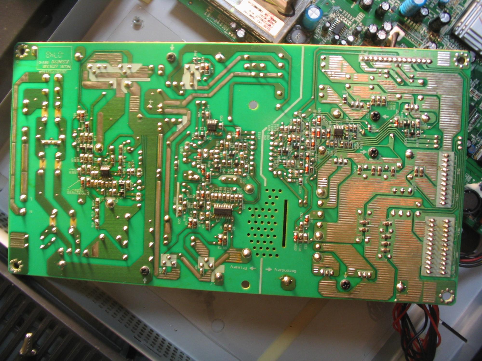

Re: Memorex MLT4221P stuck in standby
budm - the rectifier you suggest to change is an ON MBR2045CTG - is it possible that is the only problem? it's about $1 ..
http://www.mouser.com/Semiconductors...0A+45V&FS=True
got a decent pic of the 18v area on back of p/s.
retiredcaps - when i took readings, i used a jumper from the board's ground clip/screw hole to the ground strap screw the power cord plug is grounded to. i'll put it back in and try your suggestion. any ideas for creating leads for the bluepoint?
Memorex MLT4221P stuck in standby
Re: Memorex MLT4221P stuck in standby
I was thinking your fluctuatinig readings may be due to a lack of proper ground? If you have to turn your board upside down to take measurements, you may not have a ground?
Let's try this.
1) Put your power board back into the TV and secure it with all the screws in place.
2) Now measure the DC voltage of the large filter C1.
3) Put your red probe on the positive leg and black probe on the negative leg. Careful, this is high voltage as it should read about 165V DC.
4) What is your reading and is it stable?
5) Try this for your 2 multimeters plus the BluePoint. Before trying the BluePoint on the large cap, try it out measuring some AA batteries first to make sure it works.Last edited by retiredcaps; 06-18-2012, 01:27 PM.Leave a comment:
Re: Memorex MLT4221P stuck in standby
the 2 9v batts i have measure each other as 9.03v / 8.92v
have a couple MMs left by old roommate - no leads, no battery (9v) so don't know if they even work. if one might be useful, can you point me to some generic manual on how to use it? thanks.Leave a comment:
Re: Memorex MLT4221P stuck in standby
OK, it is a dual Op-amp: http://pdf1.alldatasheet.com/datashe...AS358M-E1.html
Probably used for comparator circuits of some sort.Leave a comment:
Re: Memorex MLT4221P stuck in standby
BTW, it is always best to reply directly to a question in a new post rather than edit an old previous post. Most of us usually NEVER re-read the old previous post even if it has been edited.Leave a comment:
Re: Memorex MLT4221P stuck in standby
What is the part number of that 8 pin IC in budm's marked up diagram where it says P/N?Leave a comment:
Re: Memorex MLT4221P stuck in standby
starting from pin1 (counterclockwise) the readings go up and down in the following ranges (don't know if my cheap multimeter is giving good readings or i'm doing it wrong, so treat me like a n00b, i don't mind the help)
Pin1: .39 to .44
Pin2: 3.81 to 3.88
Pin3: .01 to -.01
Pin4: -- with ground/black lead only connected :: .55 to .60
Pin5: .01 to -.01
Pin6: 8.56 to 9.22
Pin7: .28 to .36
Pin8: 160.9 to 163.3
Does your multimeter have a fresh new battery in it? An old tired battery might give bad readings.
i got a bunch of blurry pics - any suggestions for getting clear shots by hand?Leave a comment:
Re: Memorex MLT4221P stuck in standby
i checked thread 16434 & that looks the same as mine. IC2 is
230D6
PALS
so 2nd part of label is different. following that thread, using pin4 as ground/black, starting from pin1 (counterclockwise) the readings go up and down in the following ranges (don't know if my cheap multimeter is giving good readings or i'm doing it wrong, so treat me like a n00b, i don't mind the help)
Pin1: .39 to .44
Pin2: 3.81 to 3.88
Pin3: .01 to -.01
Pin4: -- with ground/black lead only connected :: .55 to .60
Pin5: .01 to -.01
Pin6: 8.56 to 9.22
Pin7: .28 to .36
Pin8: 160.9 to 163.3
removing the 18v load brings the readings up to 11.88 from 11.83
i got a bunch of blurry pics - any suggestions for getting clear shots by hand? the pic in that other thread is accurateLast edited by gb77; 06-17-2012, 11:58 PM.Leave a comment:
Re: Memorex MLT4221P stuck in standby
From what I can see, there 3 feedback signals in the 18/24VDC outputs that are used to regulated the output, since I do not have the diagram for this power supply, I would try replacing the rectifier for the 18V section, the whole thing does not clear yet why it is regulating the 24Vdc OK but not the 18Vdc, one possibility is that the 24Vdc is not loaded due to the backlights are not running, it may drop under load.
What happen if you remove the 18V connector so it will not have the load? Do you get 18v?Leave a comment:
Re: Memorex MLT4221P stuck in standby
Spec:
http://www.fspgroupusa.com/fsp2714f02/p/764.html
Looks like we are going to need good clear pictures of the bottom side of the board to look at the area of the 18Vdc section.Last edited by budm; 06-17-2012, 10:11 PM.Leave a comment:
Re: Memorex MLT4221P stuck in standby
Another TV as budm alluded to uses this same power supply. See
https://www.badcaps.net/forum/showthread.php?t=16434
Is IC2 the same part number as the Memorex?
If yes, measure the DC voltage IC2 for all pins wrt to its ground pin. I just want to verify some readings.Leave a comment:
Re: Memorex MLT4221P stuck in standby
the center lead of the dual diode also reads 11.8v - the outer leads vary when contacted but seem to settle on -.04v after a bit. the + leads from the caps (both 25v 680uF) are also 11.8v (measure from the back side of the board.Last edited by gb77; 06-17-2012, 10:15 PM.Leave a comment:
Re: Memorex MLT4221P stuck in standby
I don't have schematic for this power supply so I'm guessing based on your picture.
If CN2 is the middle connector, then I'm guessing that the dual diode is mounted onto the heat sink just to the left.
If correct, try measuring the output from the diode and see if it is 18V. The two caps just to the right of the diode may be on the 18V rail. If yes, see if the voltage across those two caps (which might be 25V or 35V rated caps) are 18V or not.Leave a comment:
Re: Memorex MLT4221P stuck in standby
yes, cns1 labeled 5v @ yellow wire, the red wire is labeled 0/F. cns2 - 18v (got 11.8 3 times measured), cns3&4 24v - all the red and blue leads show the same 24v.Leave a comment:
Re: Memorex MLT4221P stuck in standby
Are the connectors labeled with voltages? this chassis is the same as used in Polaroid TV.
So the 18V output is reading 11.84V? That will be strange since the 24Vdc supply is generated by the same transformer as the 18Vdc supply section, so I expect the 24Vdc output will be low also.Last edited by budm; 06-17-2012, 12:51 AM.Leave a comment:
Re: Memorex MLT4221P stuck in standby
i found my other multimeter (both are cheap $15 models, but this one has new 9v battery, while other one has older battery, but no batt warning) - but nearly the same result - i used 20vDC scale for 3 of them.
readings this time were:
cns1 - yellow 5.06v - red 4.63v (0/F)
cns2 - brown 11.84v (18v)
cns3 - blue & red 24.1v
cns4 - red 24.1vLeave a comment:
by lepak06Hello
I have an TV Led 4K Selecline 65s18 with mainboard T.MS3458.U801
The TV is faulty with stuck in Standby RED LED. Can't power the TV.
Before this problem , the TV stuck the picture with artefact , i unplug the AC cable and since the tv is stuck in standby .
All voltage are OK on PSU and main board for regulator. I tried flash firmware 25Q64 with many dumps
But the voltage on power button is 0.6V not 3.3V. When i press power button the voltage up to 0V. I tried to add 5V with Power Supply on 5V_STB and 3.3V on Power... -
by toty79Hello to all friends of the forum and well found, here I am asking for your help and sorry for my translated English.
As per Hisense tv title LTDN50K220WSEU stuck in standby
PSU rsag.820.5687 HLL 4855WF
Main rsag 7.820.5842
I enclose the psu diagram, after the first routine checks I find myself with a regular standby voltage of 3.3v blue light on steady when the power button is pressed nothing happens, psu disassembled and bench checked ... forced ignition by sending a signal 3 , 3v on the SW and PWM2 pins the psu turns on and delivers all the voltages... -
by lego1234567Hi. I have the following problem with my TV. After connecting to mains, the standby led (red) turns on, but TV is not responding to remote control or buttons on TV. After some measurements, I found out that +5 V standby voltage is present, but I dont have ON/OFF signal coming in to turn PSU on. It stays at zero volts. After looking at the schematic of the mainboard, I should get ON/OFF signal coming in at the R1402 resistor, but it stays around +3,5 V. So I removed it and I was able to turn on TV with buttons on TV, but not with remote control.
What could be the problem ? Thanks...2 Photos01-21-2024, 03:39 AM -
by RusengaHi techs, I have a Samsung ua39eh5003r which switches on and then goes to standby. I have to wait for a day or two for the tv to switch on again, all the time it is stuck on standby. I have checked the voltages on the power supply board on both occasions when it is on and off and these are my findings:
Connector CNM803:
TV ON
Pin1,3,4,5(Vamp),7(Vamp)- 12.6V; Pin2(PWM_DIM)- 0.96v; Pin6(BLU_ON/OFF)- 4.41v; Pin8,9,10- grnd; Pin11,12,13- 5.16v; Pin14(Power ON/OFF)- 3.3v
TV OFF
Pin1,3,4,5(Vamp),7(Vamp)- 12.6V; Pin2(PWM_DIM)- 0.06v; Pin6(BLU_ON/OFF)-...09-18-2021, 11:51 AM -
by UkdiggerWhen the Main board is disconnected, the back lights are off but tapping on the chassis makes them light up and all voltages are then good. Connecting the main board up makes the TV work normally until moved. LED INERFACE STRIP BN41-01971A has a short on the first 2 pins on the left of the picture, the cable tests good. All the other pins and all LED strips test good. Is there an easy way to fix the short or do I need a new interface. Any help would welcome.
PSU number bn44-00610A L46SF_dpn
1 B13v 12.4
3 B13v 12.4
5 Vamp 12.4
7 Vamp 12.4
9 GND... - Loading...
- No more items.
Leave a comment:
