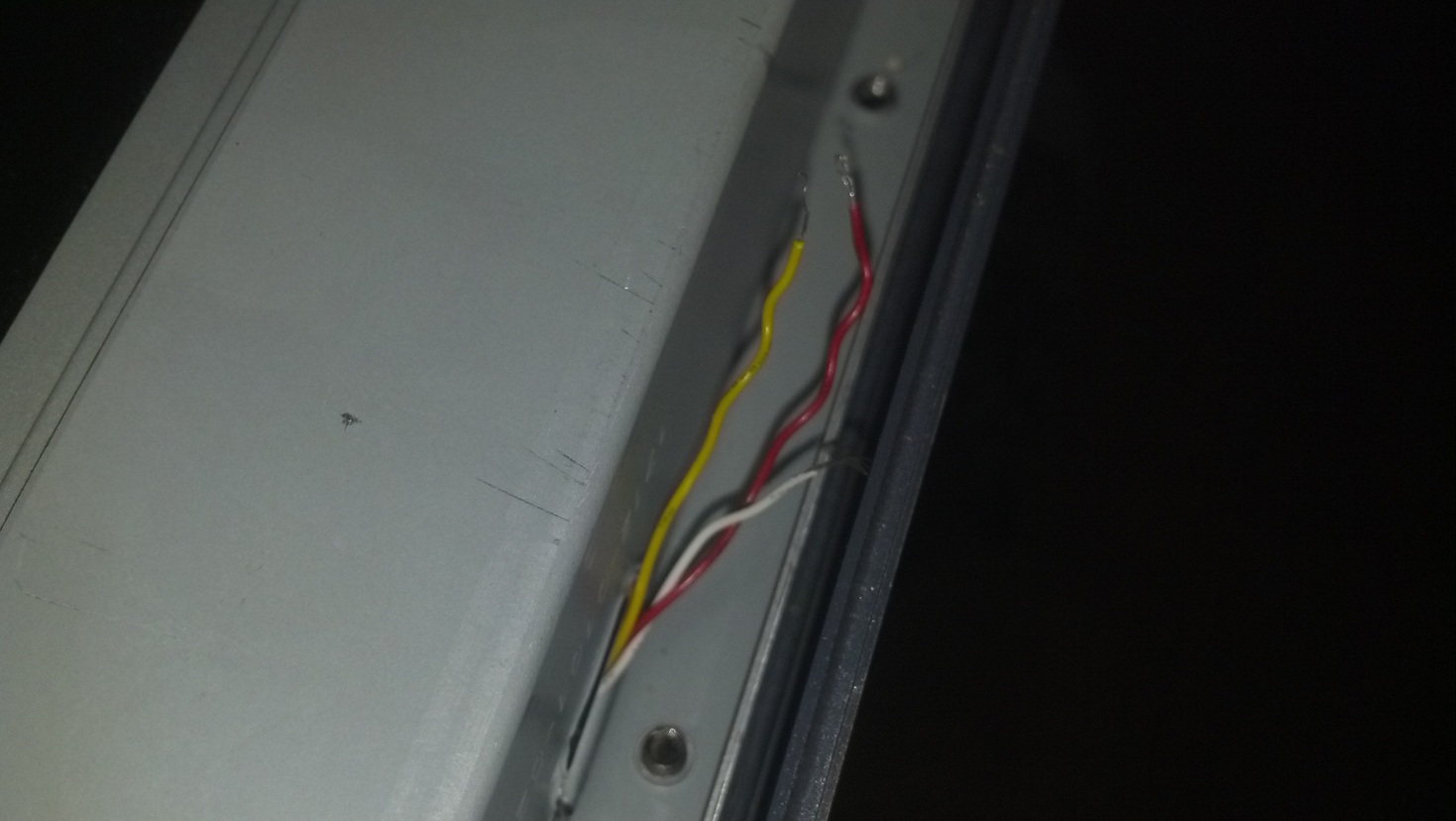

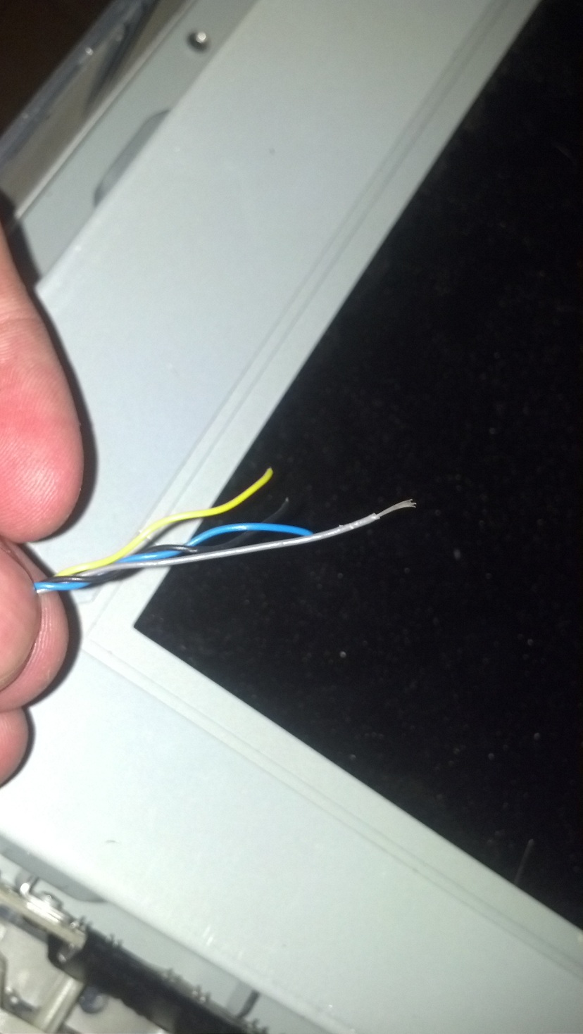

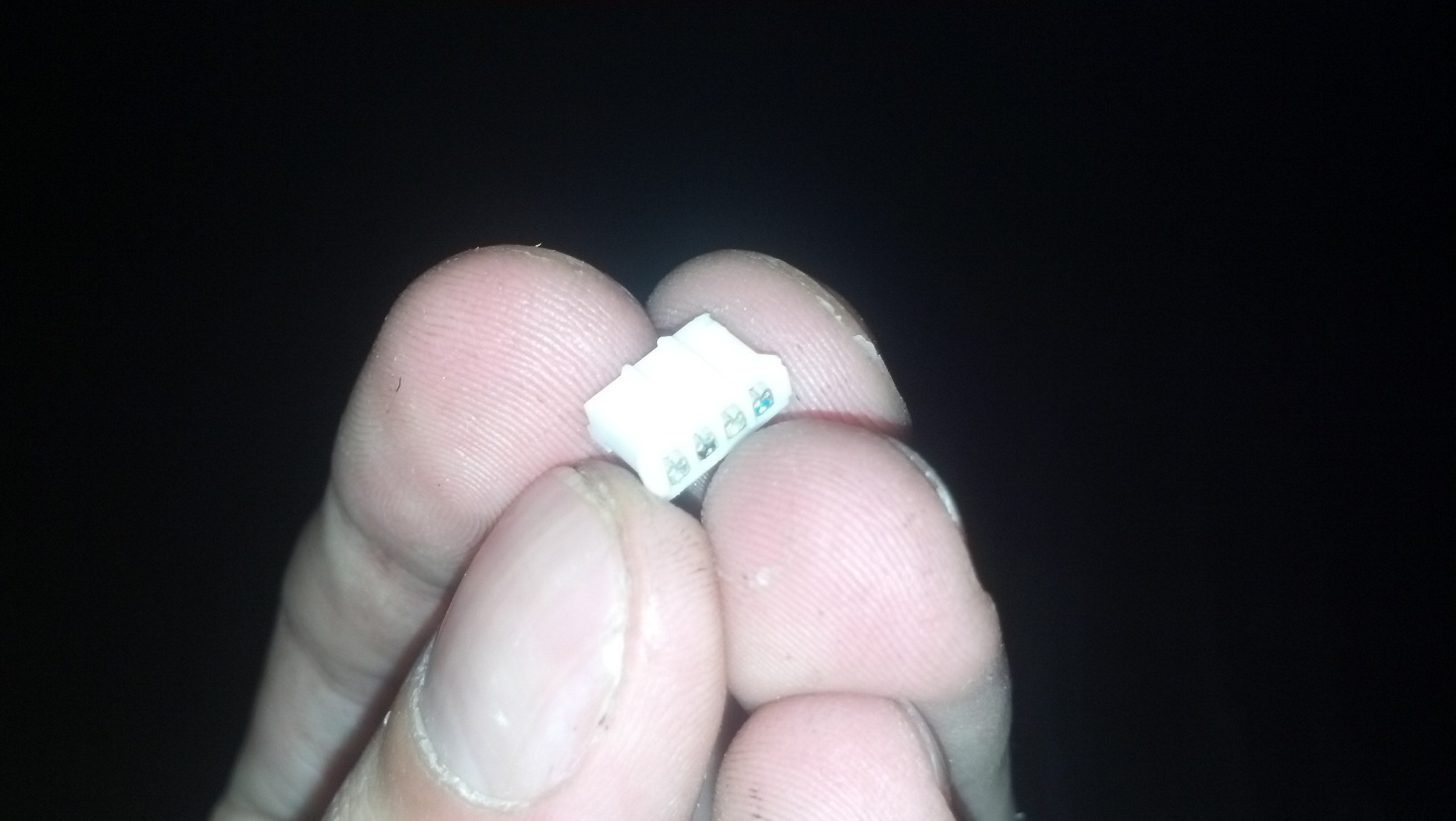

        here is some images. the led lights are repairable barley. the cable is quite short. as for the ir sensor i don't think so. its broken at the connector.

          The terminal may be removable if you can see the exposed locking pin on the other side of the body.

              FIXED sorry man. just rushed. and the wires are ripped directly from the connectors. is there a alternative cable i can buy to replace this?

                Not easily, I fixed them by removing the terminals, spread the crimped section and solder the wire to the terminal. Or you can solder the wires directly to the board.

                  Service manual has a Bill of Materials. Look through the drawings to see what the part number is and maybe you can order a replacement or find equivalent on ebay or digikey.com

                        Thank you guys so much. I've probably been a bit of a pain but after all this I've learned a lot. I even found replacement cables. All I had to do was think outside of the box and get proprietary cables from a vizio set. Ebay worked wonders. I'll probably buy more broken tvs and have a hand at it. Of this same model.
