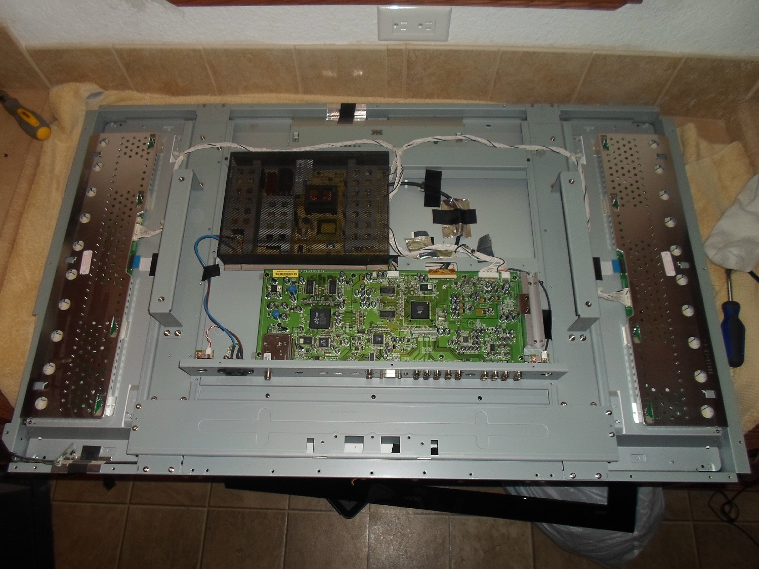

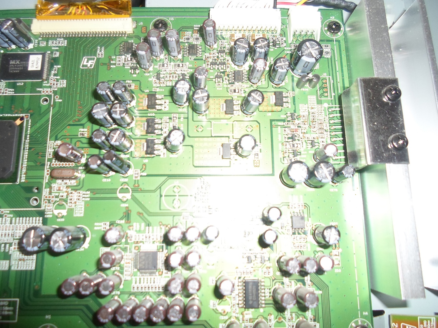

    Recently I've been "donated" a gv42l from my parents that has a issue. It wont turn on fully and once its on it won't turn off unless you pull the power cable. When I mean it turn on, I mean the screen doesn't come on. The white vizio light comes on and that is about it. I wanted to do some troubleshooting on it but I'm having some issues opening it up. I dont want to damage it so I'm being extra careful. Can anyone point me in the right direction? I have all the right tools:voltmeter, soldering iron, solder, some basic electrical background knowledge.
    Anyways give me a chance guys :P.
    Re: Taking apart a gv42l and troubleshooting
    Once you get it apart, take pictures of the insides. I suspect this model has the famous "U33" problem, which is an easy fix.

      ya haha. I am having the hardest time getting inside of it. anyone know where I can find a tutorial? To desemble it.

        The front of the tv is latched on to the back like a computer monitor unfortunatly. Use a popscicle stick or guitar pic, something that won't gouge the plastic to bad.

            Thanks bill the Popsicle sticks worked great. Cut my hand on the plastic and i think i broke the led visio light on the front. I'll have to fix those later. I finally got her open up and took some initial pics. My camera sucks so forgive me guys. I'm going to assume my problem is the mainboard. So I'll start there.

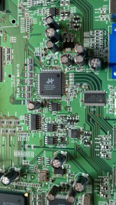

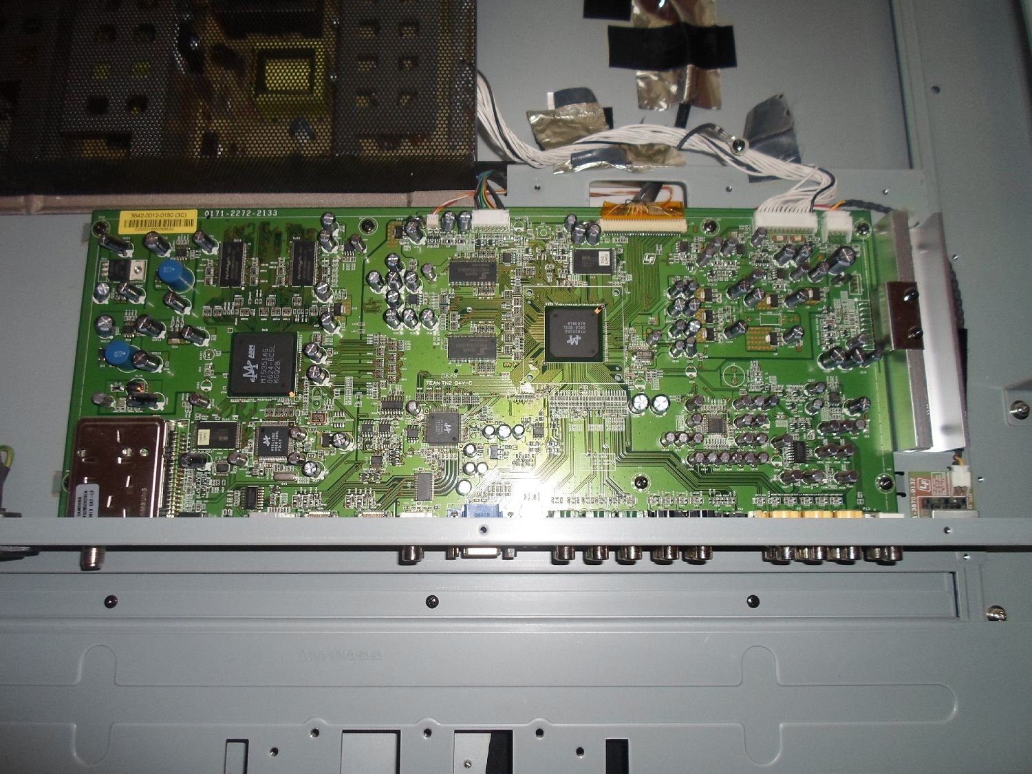

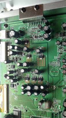

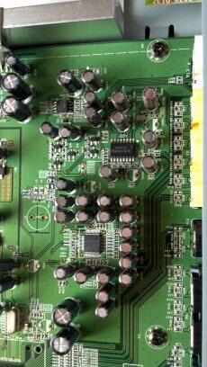

              Picture are of little use for troubleshooting - a third of the caps "look" to be leaked - stain on the ends but it might just be the picture.

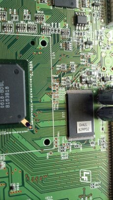

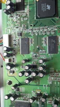

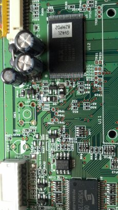

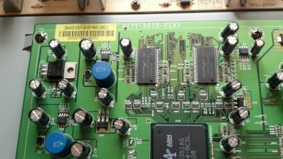

                Sorry about that crapy camera wouldn't focus any further. Here's my phone. I need some advice on a fix for the front light... Its a led but its not really a replaceable part... anyways. I don't really see any leaky caps or bloated on the mainboard or the powersupply.

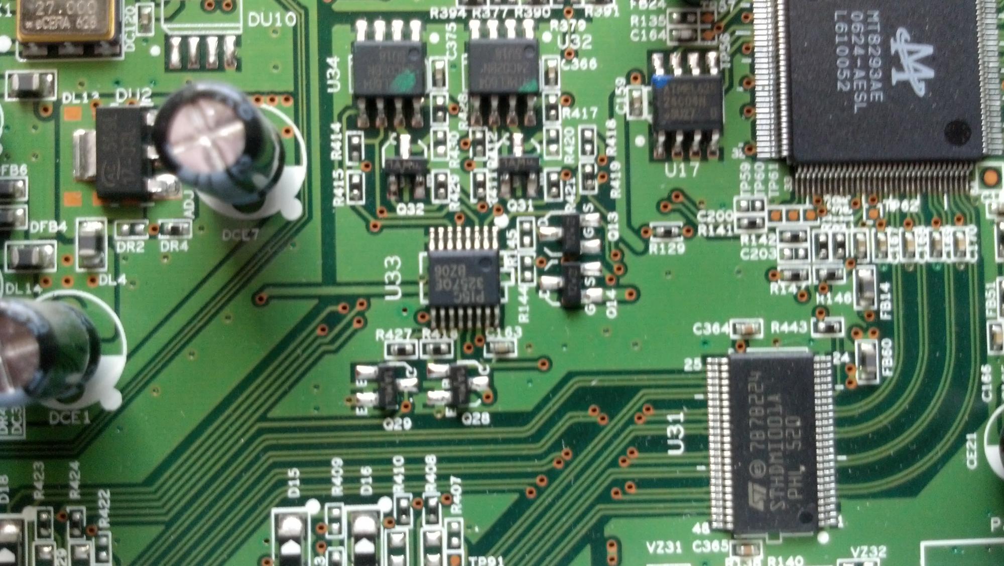

                  Does your TV have a U33 regulator?
                  • Silviyius
                    • Jun 2012
                    • 29
                    • US
                    well i have 3642-0012-0150 (gc) I hope thats what you mean in the pic haha. If not i need to be educated. XD

                                  Hello all, I am a NOOB and trying to understand how to check the U33 and, also, where to find a replacement
                                  I finally found the U33 which has 3 legs soldered onto the board and the top. Is there any replacement available for this part?
