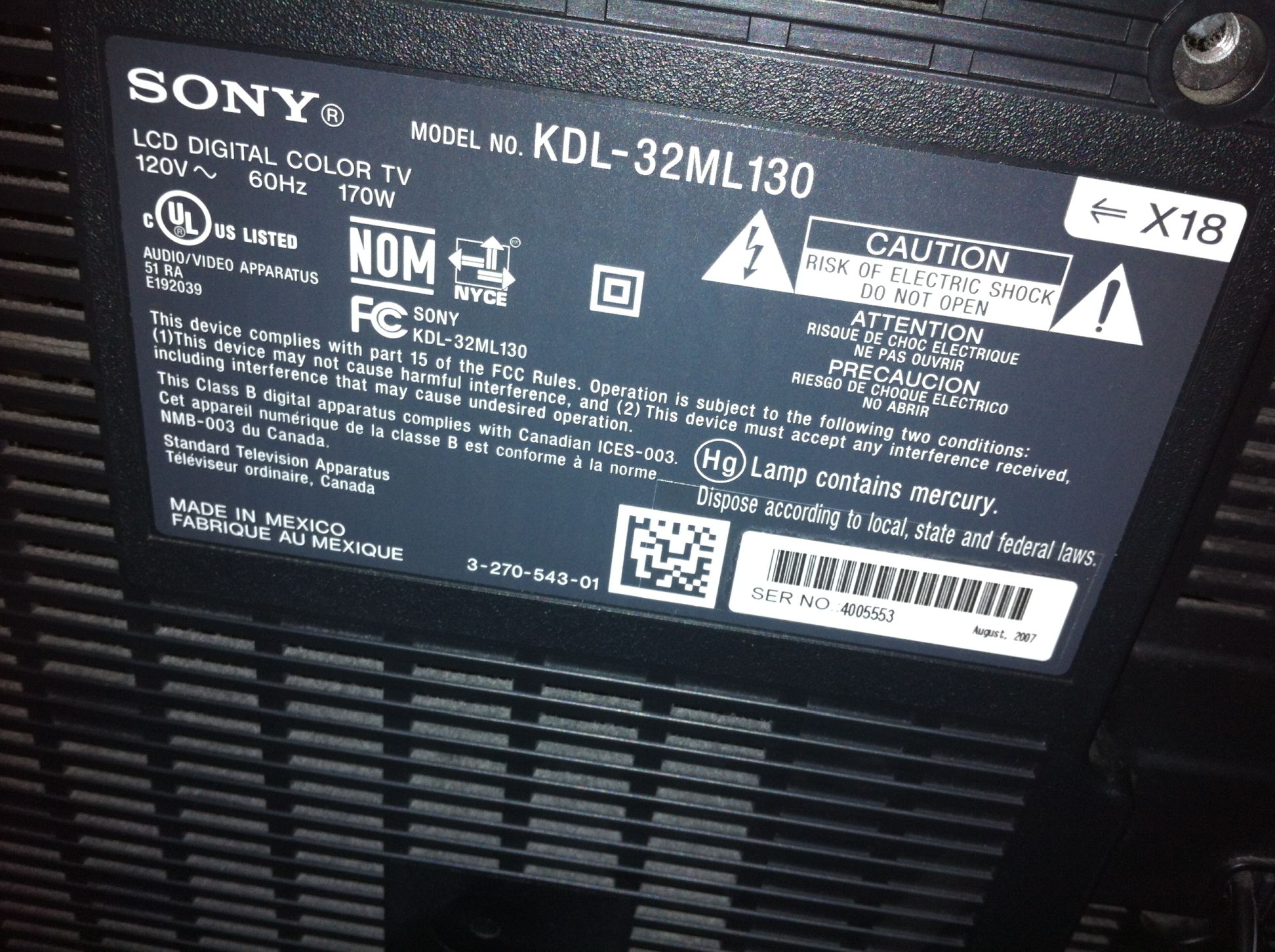

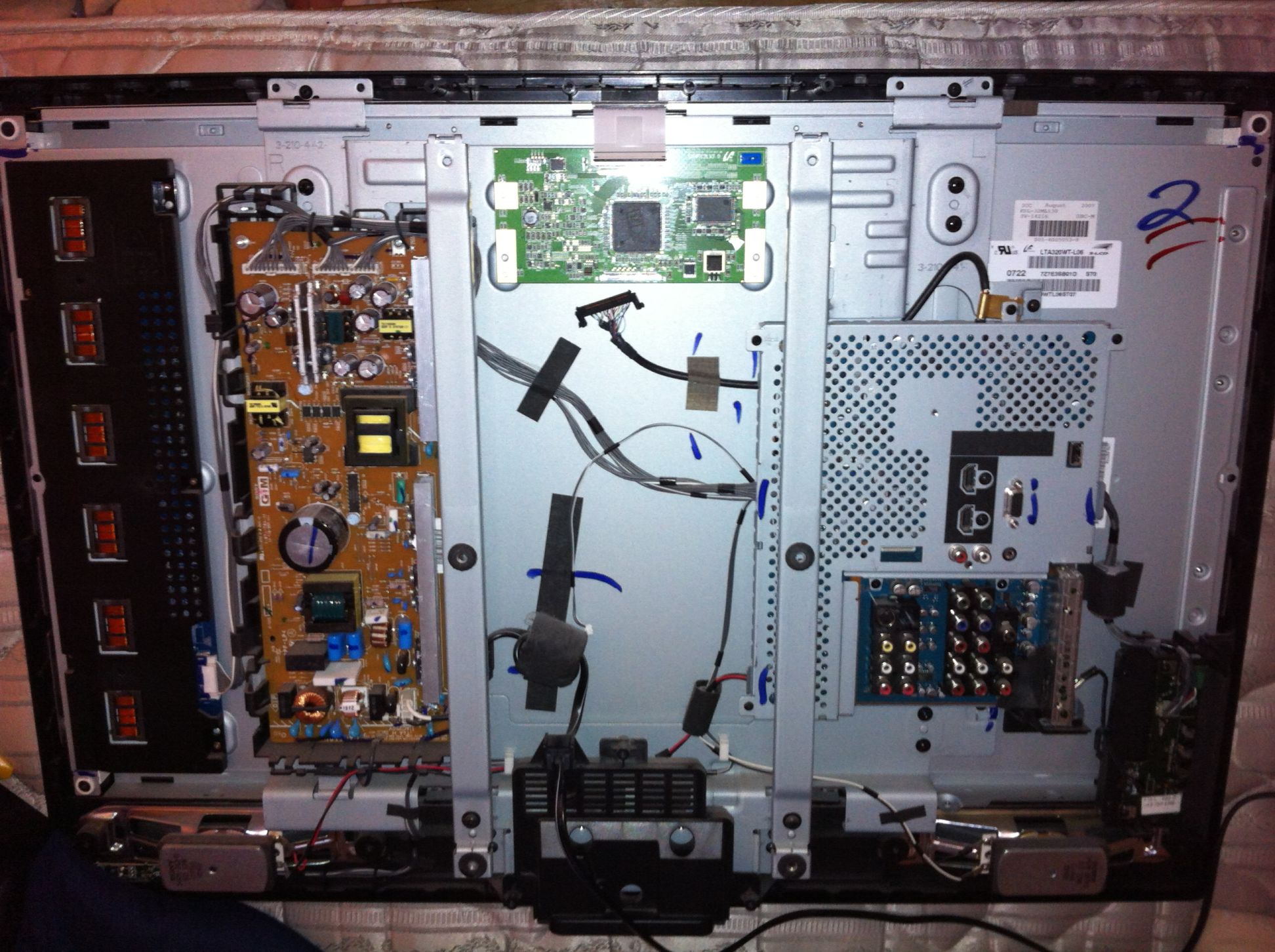

    Today I came into the possession of a Sony Bravia KDL-32ML130. My mother was doing some shopping at Good Will and picked up this unit for cheap. She dropped it off at my house earlier this afternoon after finding out that it does not work.
    I have a small background in repairing electronics as I've always had an aptitude for fixing my old game consoles, televisions, and arcade machines. However, I have never had any real experience in fixing anything too complex (meaning anything beyond replacing capacitors, fuses, and cleaning up solder).
    After reading some similar threads on this forum, I feel it's safe to assume the problem is probably a bad component on the T-CON. However, I have yet to see a picture of one on this forum that looks close enough to mine to start testing and changing components. I'd like to try to fix this unit before giving in and buying a new T-CON board. More/better pictures can be added as requested.
    Any help would be greatly appreciated.

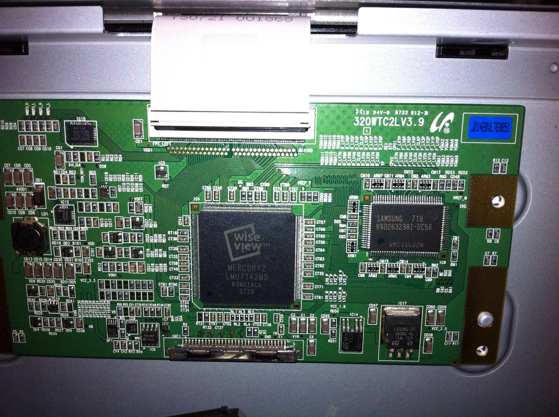

    A common failure is the device F1, which is a tiny fuse. It blows often without apparent cause. Do you have a digital multimeter? With the TV off (and unplugged), set your meter to 200 ohms, put the red probe in the Volt/Ohm jack and the black in the COM jack, and record the reading when probing across the fuse. If you read nearly zero, the fuse is okay. But if your meter reading doesn't change, it is likely the fault.

      I'm definitely not getting a reading from it. What is that type of fuse called and where could I find a replacement for it?
      It has a P or lower case d on the top if that matters.

        This is a Bourns 3A fuse but not sure which you need of these.
        Perhaps Tom will advise better
        http://www.digikey.com/product-searc...bourns&stock=1
        EDIT Sorry it might not be 3A I have read that a p = 3amp but looking at the bourns datasheet
        it is only 1.5 so I am a bit confused - will try and look elsewhere.

          If we can get the panel P/N as printed on the sticker, then we can look up the spec of the LCD panel assembly which will provide the current draw and voltages of the T-CON and the backlights inverter board.
            Re: Sony Bravia KDL-32ML130 - No Picture, Has Backlight & Audio
            It's a Samsung LTA320WT-L06; the datasheet is here: https://cdn.badcaps-static.com/pdfs/...fca4ded7ea.pdf.
            Page 10 says max draw is 2.2A from 5V. I would specify a fuse 2x that rating so about 5 amps to prevent nuscience blowing.
              I had that website on my Fav, it is great. 5A is about right, I use through hole Littlefuse PICO II fuse on my T-CON repair.

                Great! got it now - there is no standard marking one standard was that p =3A which would fit with Toms 2.2A finding. Bourns apparently used the same letters but for different values. I see that littlefuse has now adopted the rather sensible idea of putting the amps and voltage on the markings.

                      Here's a good fuse.
                      http://www.digikey.com/product-detai...32CT-ND/686745
                      It's tiny... Perhaps practice desoldering on another board first like an old motherboard or sound card.
                      Thinking about this, my dad probably has that T-con from the Crown TV I stripped for parts due to a broken LCD. If you have difficulty replacing the fuse I'll ask him about it.
                        To make it easy, you can just lay the new fuse right on top of the blown fuse and just solder both ends to the old fuse's end terminals, that way you do not have to remove the old blown fuse, that is how I do it. I would order more than one fuse just in case you mess up.

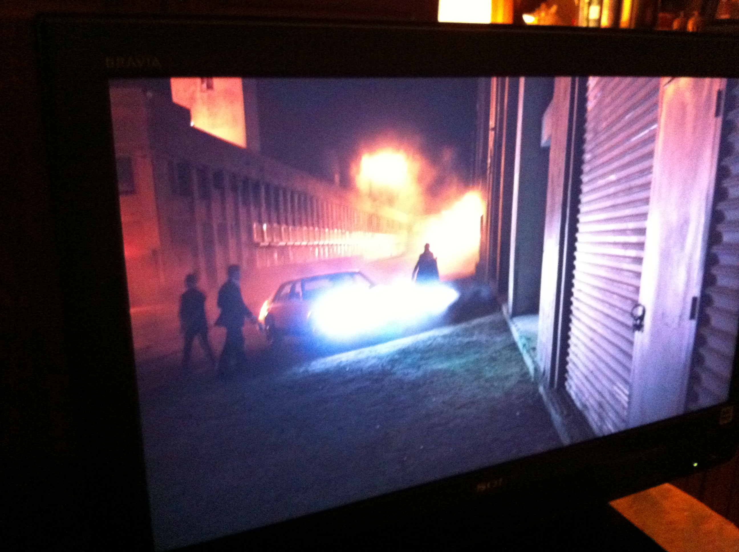

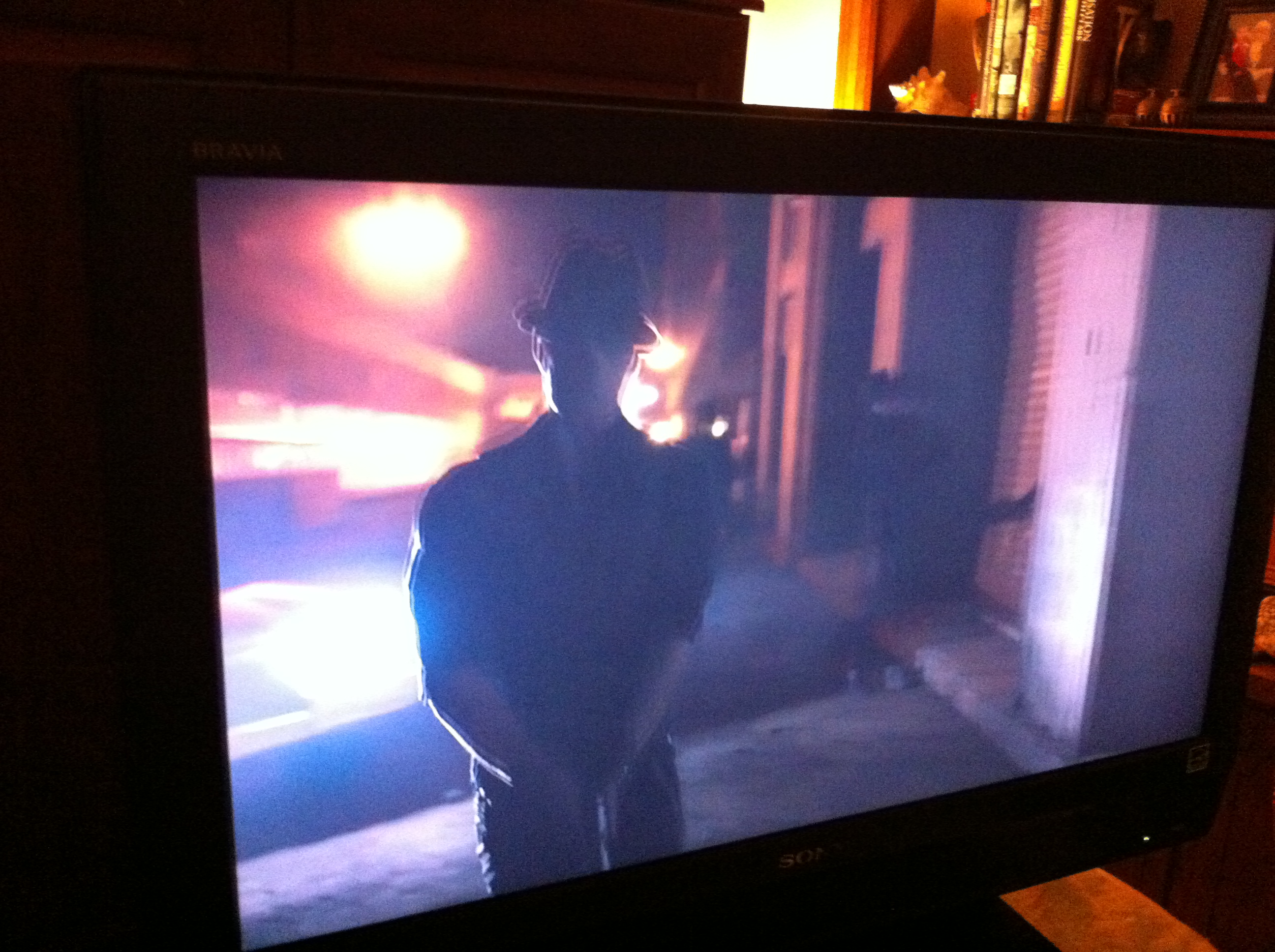

                                Sorry to necro a thread from 5 months ago, but I just wanted to say that it was indeed a bad fuse at F1. I just want to take a moment to thank tom66 as well as everyone else in this thread. It only took 2 of the 5 fuses I ordered to get it in place set properly.
                                I wish the pictures were of better quality, but they were taken in a low light situation with an older generation iPhone.
