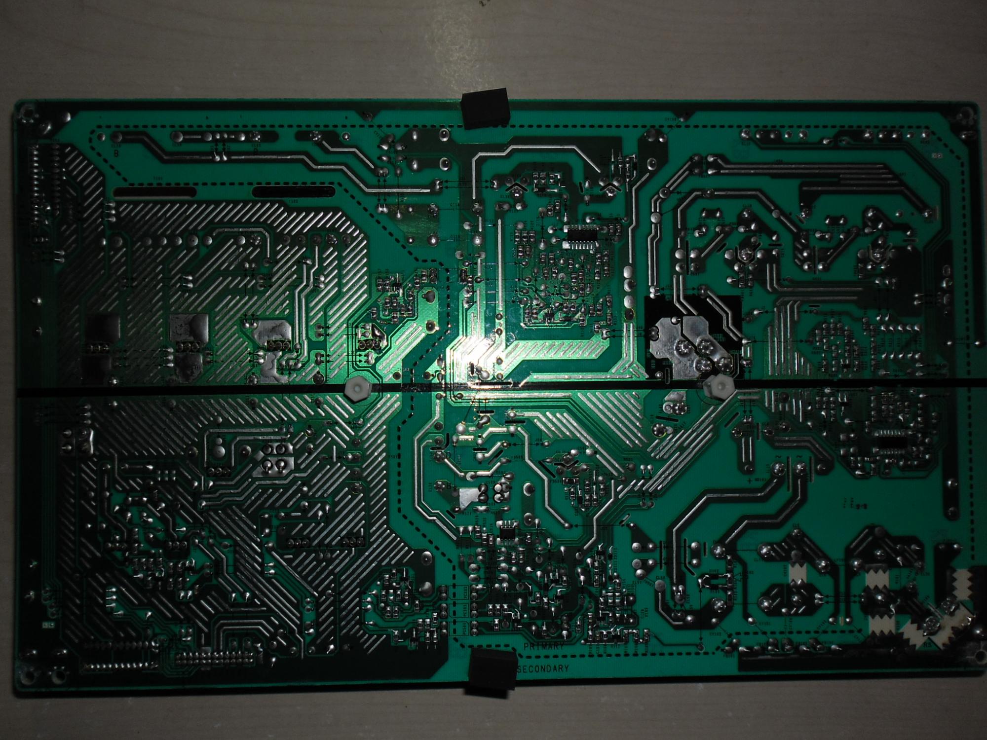

    Screen isn't lighting up - first conclusion is inverter, then main board - but that being said I know of some T-cons which synchronise the inverter and without the T-con they won't light up. Is there any cable going from the inverter to any board other than the PSU?

                            Wow what an improvement in the pics but still cant make out if the right hand cap on the slave board is ok. Can you test the resistance across the cap and see if there is conductivity to the next joint.
                            On the master the transformer looks a bit cooked - can you do pics of the backs of the boards.

                                  Re: 42lg3000-za No Picture but got sound
                                  Looking on the transformer legs is this correct cant get any clearer image.
                                  On master inverter T1 leg 3 just connects to a pin coming out of transformer, then leg 5 & 6 are bridged to a pin coming out of tranformer.
                                  On T2 leg 3 connected to pin coming out, then leg 5 & 6 looks like they aint touching but its a very very very tiny gap and looks like a blob of solder?
                                  On T200 leg 4 connected to pin coming out, leg 6 connected to pin coming out but not connected to 5 looks strange,
                                  T201 leg 3 & 4 bridged, leg 5 connected to pin coming out cant workout if it should be connected to leg 6 tho.
