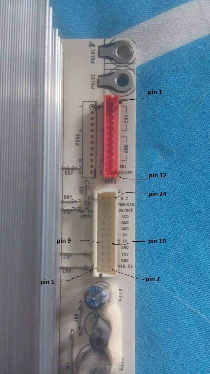

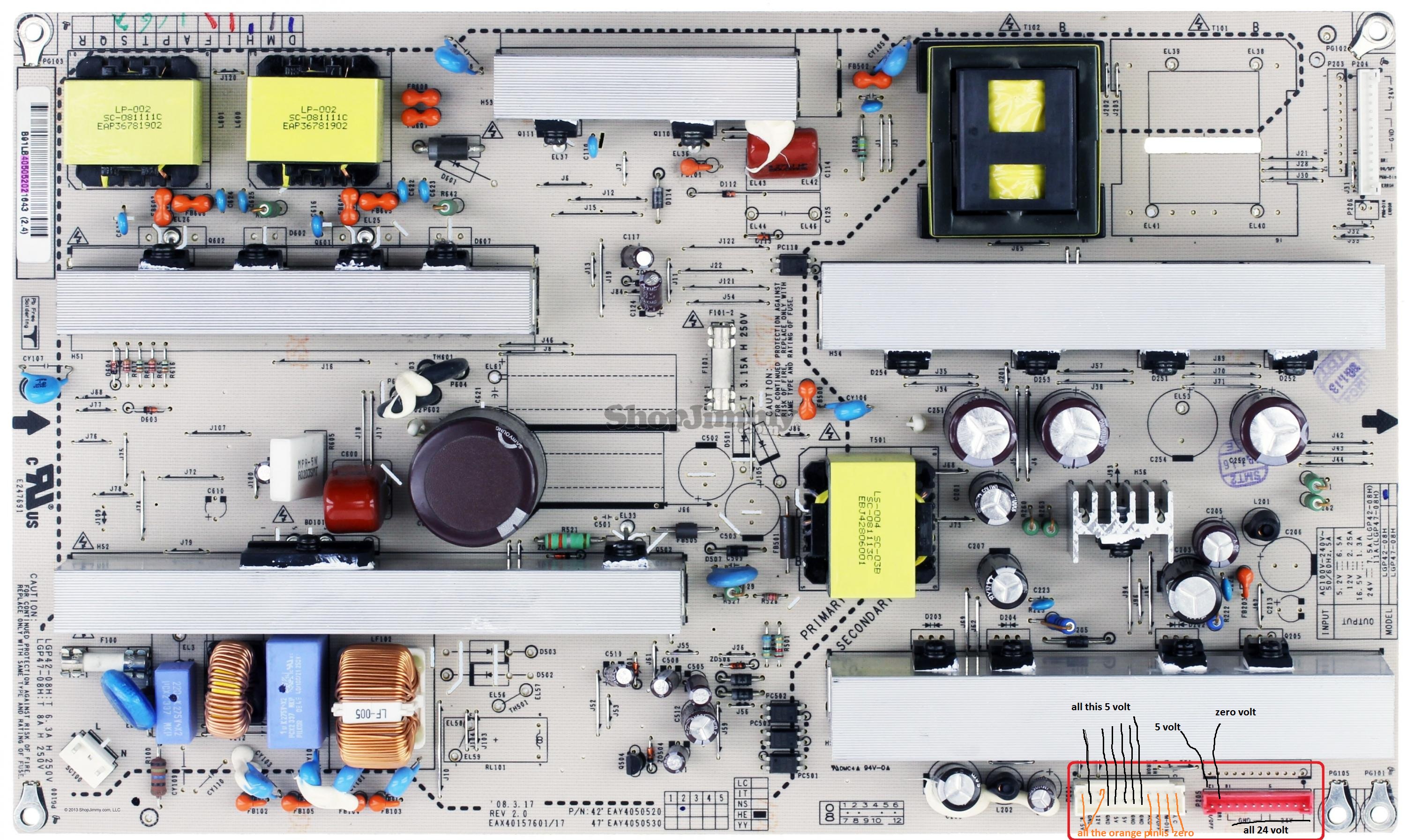

    Can you give the name and voltages on the two connectors shown.
    Photo courtesy of Shopjimmy
    where is the true way to take the volts? i measure from the red place only the negative to the other . if i pul out the white cable i make measured the red place and take zero volt..if i pull in the white cable i take 24 volt and five volt to the red place. now to take measure only the white place i have only the five volt not the 16 volt...if you wait i can sent a foto

        Re: 42lg3000-za No Picture but got sound
        Please give the name written alongside the pin and the voltage you read
        White connector
        Pin1----> Pin 12
        Red connector
        Pin1----> Pin 12
            Can you give the pin names because I cannot read all of them from the photo and they are needed to help you.

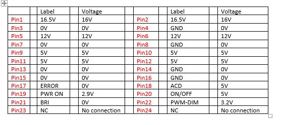

                                This is very difficult to read because you do not say what is Pin1, Pin2 etc.
                                Post #127
                                Do you have ALL the voltages when you carried this out?
                                5V, 12V, 24V, 16.5V etc
                                      You do not say if you still have 24V but it looks as though you have all the voltages.
                                      If that is the case then I believe the fault must be with one of the inverter boards (Master/Slave) or with one of the CCFL tubes.
