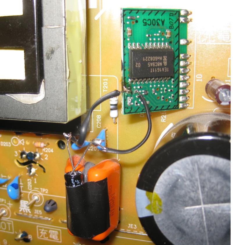

              Re: Panasonic Plasma TH-50PZ800U power supply light 2 blinks
              Finally I fixed it.

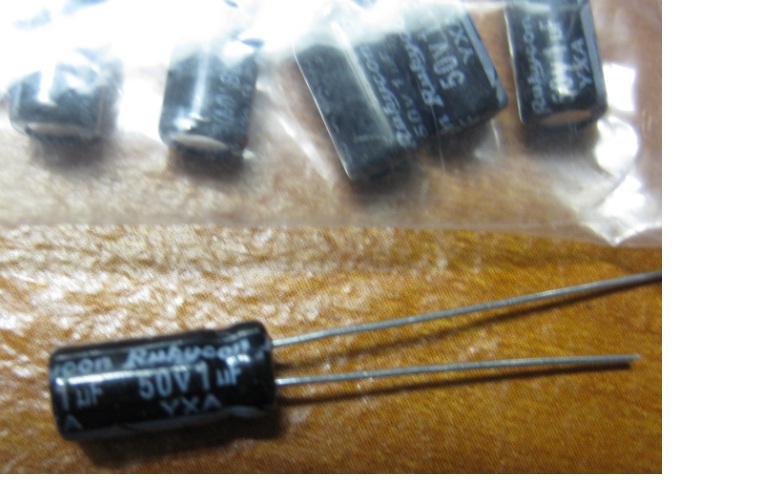

              I only cool the ceramic capacitor on the power supply boards MC201, it could power up, so that cap is bad cap.
              I bought 10 common 1uf 50v capacitors for 1 dollar, and use 1 to replace the bad cap. It's hard to sold because it's too small, I almost damaged the curcuit, so I use two soft / small wires to link to the new cap as show in the photo, and it works fine !

                  What is the consensus on what type of cap to use for this? Some are using a 1uf 'lytic. On the AVS thread one guy strongly advocates 50v Polyester film (of the Panasonic ECQ-V or ECQ-B series) These are non-stocking at DigiKey. The only 1uf Polyester caps they do stock are 250v which are ginormous. Can I just use a couple of generic 1uf 35v orange drop caps that I have in stock already? Or just use a 50v 105c 'lytic and be done with it?
                  • rsina
                    • Nov 2012
                    • 2
                    According to Norcal that made the youtube repair video, this cap only needs to be 15+ volts so I believe your 35v caps would be fine.

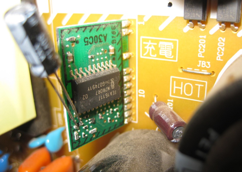

                      It's easier to fix if you take it off.

                          I got another model PANASONIC TH-50PZ85U, the same problem: when I press the power button, 2 blinks.
                          I didn't bother to take the power supply unit out, instead, I solded out the small cap and replaced with a 1uf 50v cap as shown in the pictures,
                          tv works perfect now.
                          SO it looks like these serious tv power ssupplies have this common issue, you only replace the cap, not the ic.
                            How are you replacing these with electrolytic caps? Won't polarity matter? Going by that ceramic caps have no polarity
                            • Sevenqi
                              • Jul 2011
                              • 292
                              This cap is in MC201, it should have polarity. I replaced this kind of caps for two TVs with the same issue, it works.
