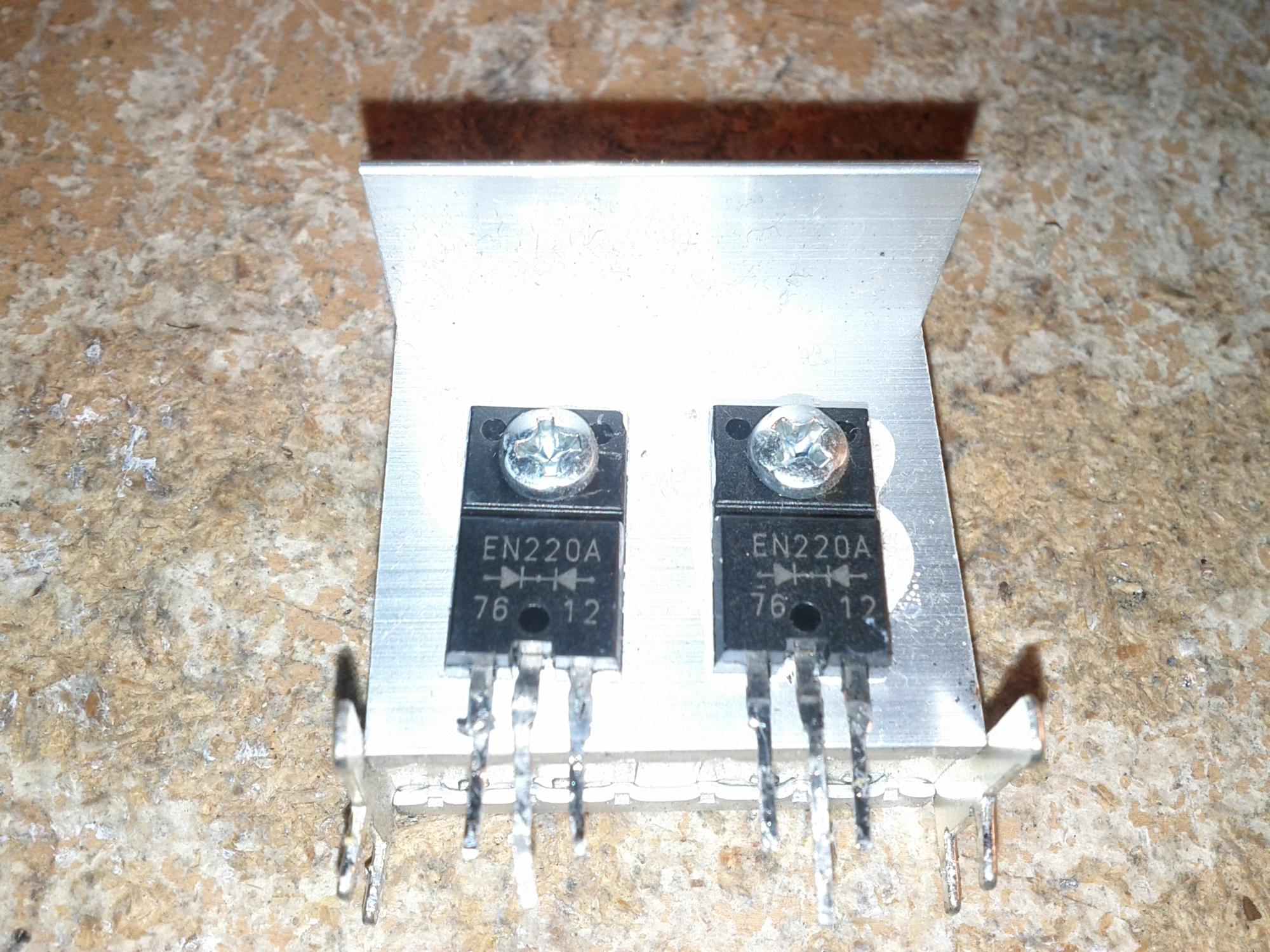

    im looking for the data sheet for this part. part name is en220a it is from a ps to power the inverter.
  • selldoor
    Slow Learner
    • Dec 2010
    • 7870
    Re: dual rectifier
    Did you try typing en220a into google - is it one of those parts. Sorry if you tried that
    already - can you post a pic of it.
    Please also can you update your profile with country and mains voltage.
      Re: dual rectifier
      Do you have a picture of the part, and the area of the PSU it comes from?
      If the device is failed (usually shorted), then it may be possible to use an alternative compatible device.

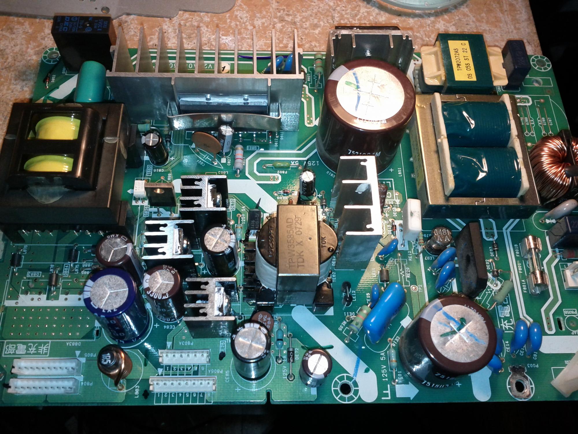

        Re: dual rectifier
        the part go right behind the yellow and black transformer. it traces back to the plugs for the inverter. it reads 1.83 in diode check. and 70k in ohms. which seems very low.

          are they not dual shottky diodes?
          fixed so far...376 lg lcd tv's,24 onn tv;s,24 panasonic lcd,16 jvc lcd,12 marshall jcm800 amps,refurb of various disco equipment lighting,old style disco decks ,and a flymo!
          please let us know if everything works ok if your tv gets fixed, as it will be and aid for anyone else having the same problem and wishing to fix it.it would save people clogging up this site with topics that are duplicated,and can be found easily using the search function.,and taking up valuable space.enjoy your fixed tv!,hopefully!
            Re: dual rectifier
            That sounds fine, but to confirm -
            Number pins 1-3 left to right.
            Labelled (pos/red) (neg/black) respectively (use diode test.)
            Test 1-2 should read ~150 - 700.
            Test 2-1 should read single "1" or "OL".
            Test 2-3 should read single "1" or "OL".
            Test 3-2 should read ~150 - 700.
            Test 1-3 should read single "1" or "OL".
            That looks a lot like a Toshiba PSU.
            The power module clamped to the heatsink (the one with lots of pins) can sometimes go faulty, though this usually blows the fuse.

              set your meter if dmm to 200 ohm,or 10k ohm anologue, pin 1 and 2 should show reading one way ,pins 2 and 3 should show reading one way

                "en220a rectifier" leads to

                    Common Cathode with Isolated tab, we ran into this problem before with the person did not order the Isolated tab version.
                      I remember that its here https://www.badcaps.net/forum/showth...987#post237987.
                      But the datasheet retiredcaps and I have given is for the TO-220F package
                      which is fully insulated, though it doesnt say so in the sheet other than by the package type.

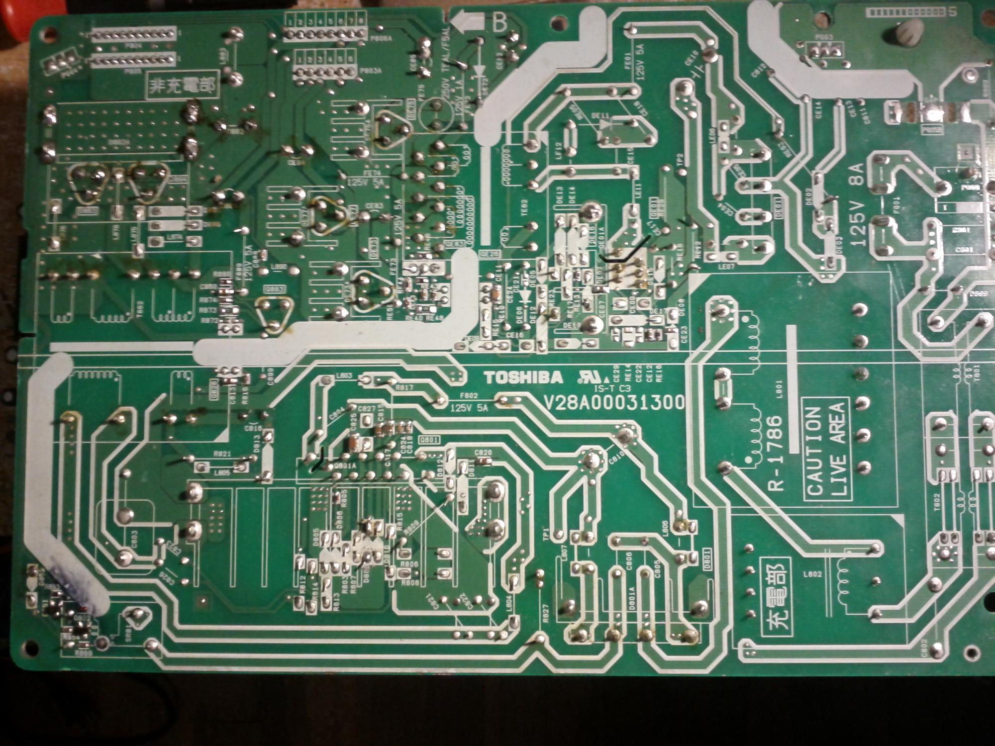

                                        Re: dual rectifier
                                        that dark spot must be from the factory. i seen it a few other power supplies online.
