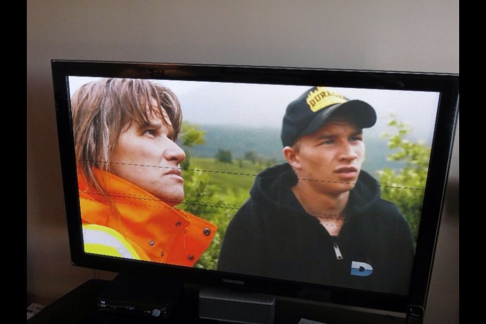

            Re: Samsung PN50C550G1F black horizontal lines
            I have a Samsung PN50C6400 which has at least two line issues (picture attached). There are horizontal black lines of different size (perhaps wider ones are just multiple lines appearing as one) banded across middle of screen (none on top or bottom 20%). These lines started some years back and have slowly increased in number/size. They can be annoying, but i guess i have gotten used to them and often don't even recognize them when watching, but would like to "fix" them if possible.
            There are also some vertical, colored lines right of center and near right side. They have appeared after the vertical lines and have not grown to the same extent as the vertical lines.
            What are the thoughts about this?
