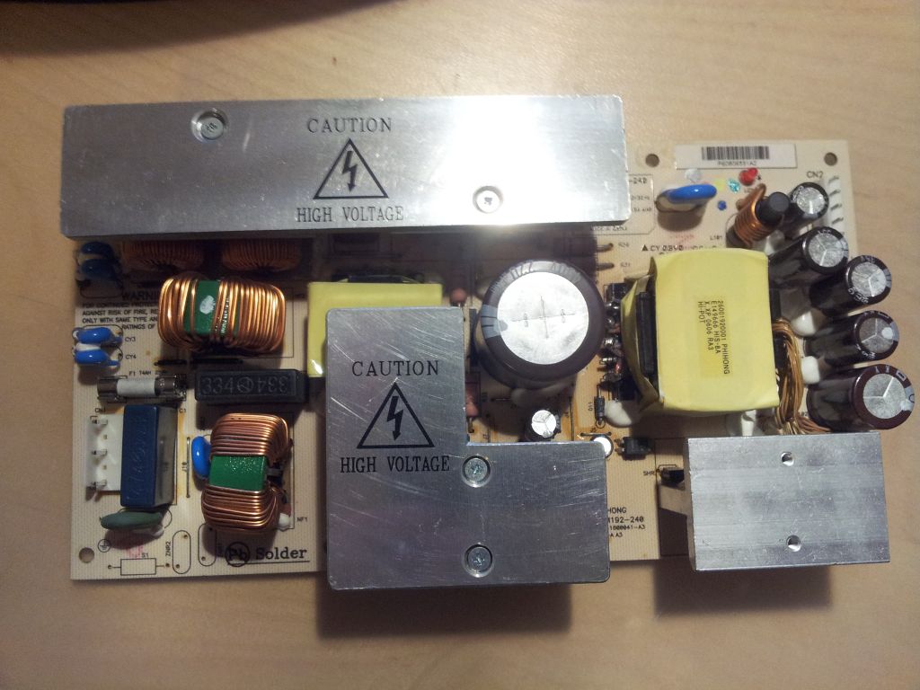

    Hi all!
    I just got this, presumably defunct TV for free - and it seems that the backlight works, and the TV turns on just fine. No image ever appears, and i can't seem to get it to work with either VGA, SCART or RCA video. (RCA+SCART seems to be connected to another board than VGA and DVI). I opened it up, and i can't find any obvious bulging caps.
    I found another thread describing what i think may be the same as my problem: https://www.badcaps.net/forum/showthread.php?t=17990

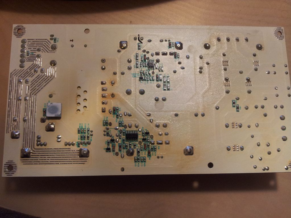

    So, I took out the power board, and it seems there is brown marks around both sides of one of the diodes - is this normal or do you think this is where the problem is? Look at the attached pictures.. :-)
    The power board is a PSM192-240, and i found a replacement @ ebay for about $50 incl. shipping. Should i buy that and hope that the power board is what needs replacing? (I'm in Norway and nowhere near a radioshack - so it's hard to just go out and buy the right components! :-( )
    Thanks a lot! :-)

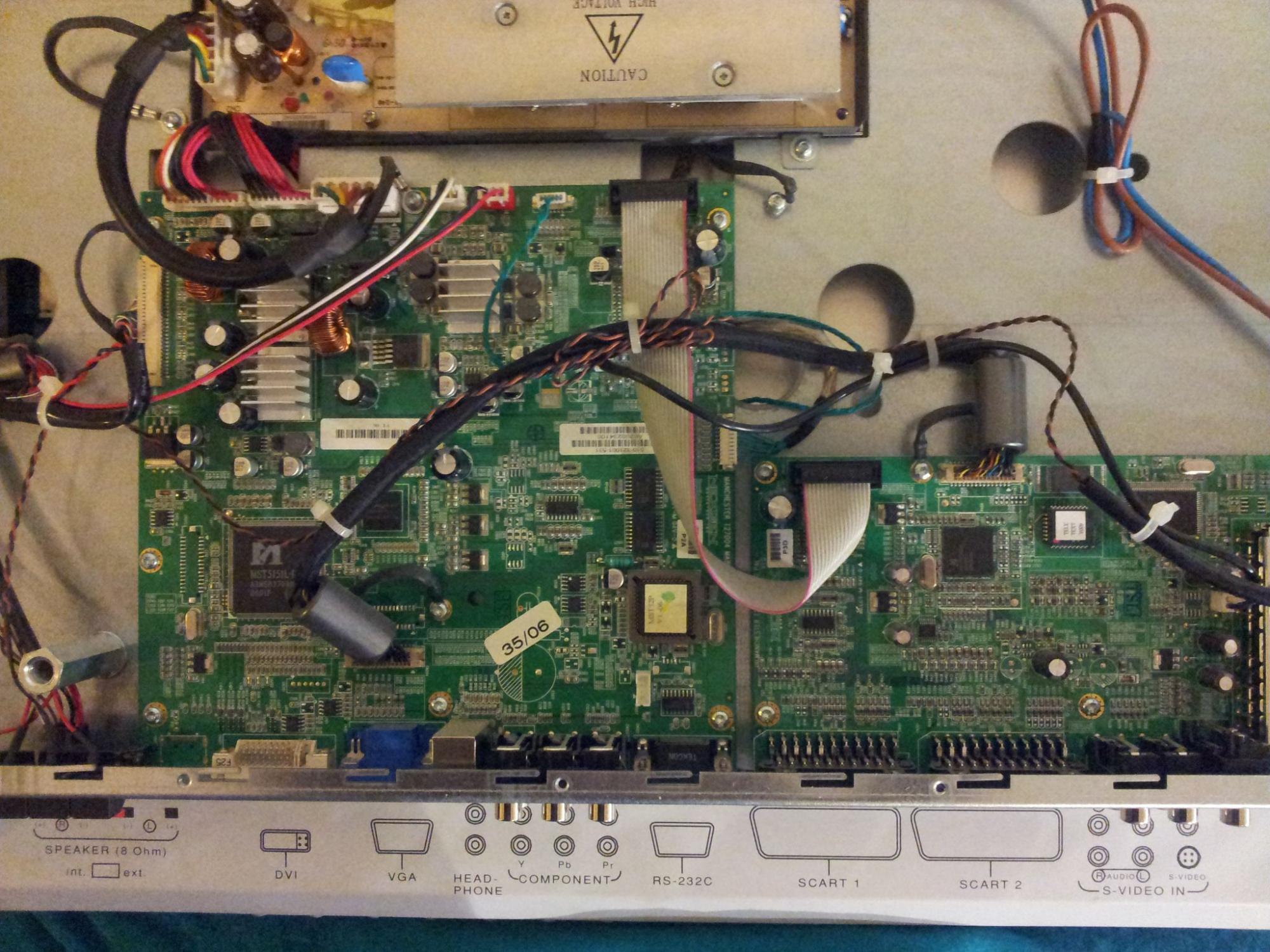

    Re: Fujitsu Siemens Myrica V32-1 - backlight, but no image
    The first two suspects are
    1) bad component on the logic board or bad logic board
    2) blown fuse on the t-con panel
    We need pictures of every board on your TV. The t-con board may be hidden behind a metal shield. The t-con is usually near the top of the tv.

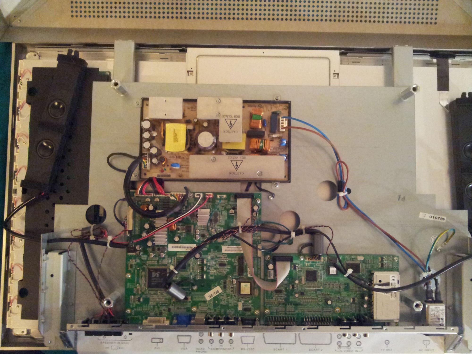

    • olemartinorg
      • Mar 2012
      • 5
      • Norway
      Thanks a lot for the reply! :-)
      I'm sorry if therse are the wrong boards, i don't know what a t-con panel is (yep, noob here!) but maybe it is the one on the left in the picture, under the plastic cover? Should i rip the plastic cover off and check? (I can't seem to figure out how to remove the large panel where most of the boards are mounted - it seems to be glued to the frame or something??)

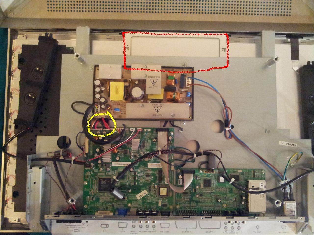

      • retiredcaps
        • Apr 2010
        • 9271
        1) Your t-con is likely in the area circled in red. Follow the cables circled in yellow. They likely are connected to the bottom of the t-con.
        2) Do you have a multimeter and are your familiar with how to measure DC voltage and resistance?
