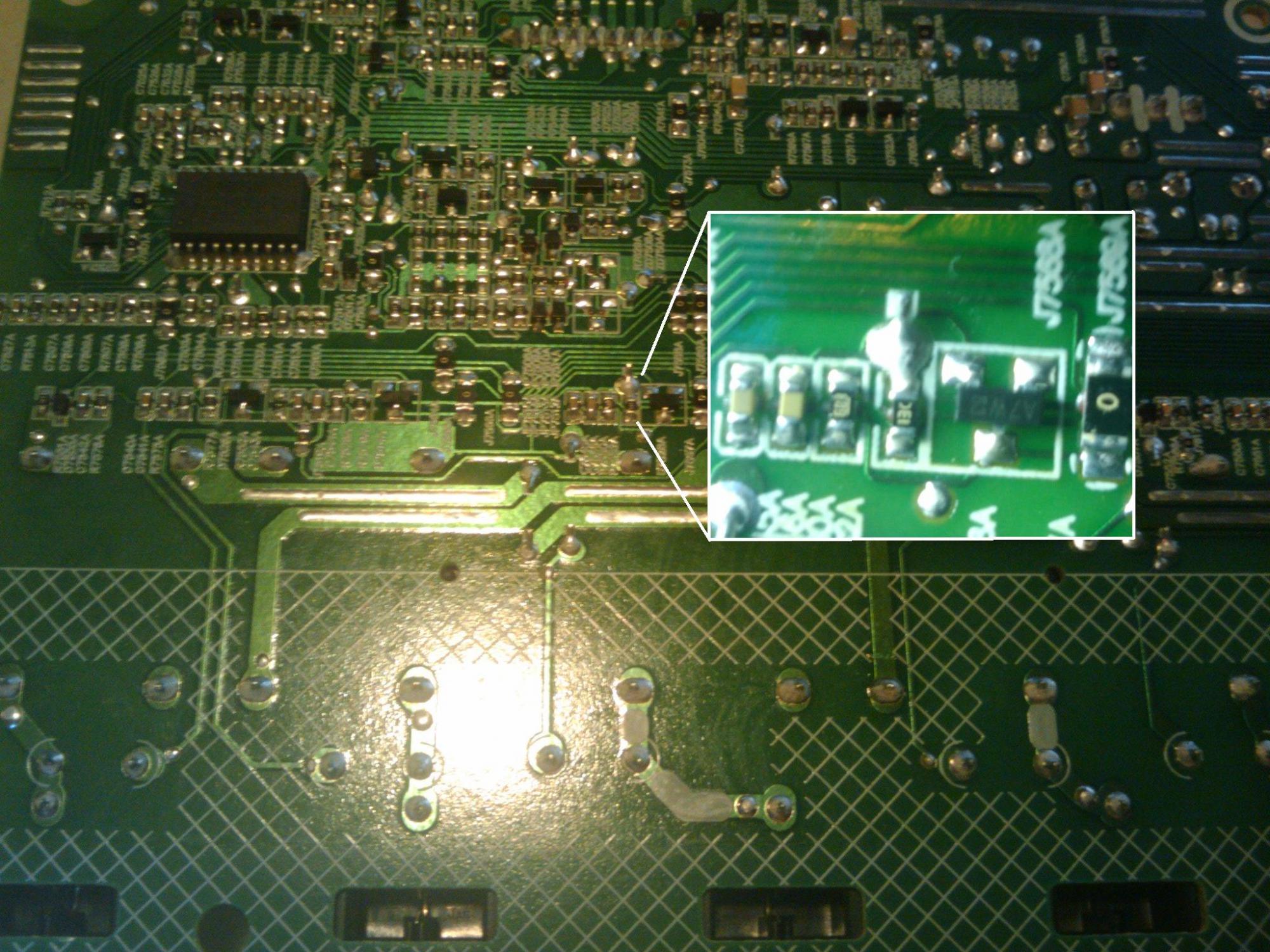

    1st hello everyone,
    I found this TV on the road hoping to fix it. I've fixed a 42" Samsung and a 32" Vizio that both had bad caps/overheating, but those are easy fixes (both plasmas).
    When I turn this TV on I can see a flash inside the tv where the panel starts to light up then goes off. You can see it light up in the front as well. after about 10 seconds the TV turns off, the screen is dim this whole time. After doing this twice, on the third time the screen will actually come on after about 10 seconds to show "Video 2," and if I hold the volume button it will show the volume increasing. I also hooked sound up that works only after the screen comes back on and goes away when the TV shuts off. This lasts for about 2 seconds then the entire TV shuts off until I unplug it unless I manually turn it off just before it would shut off. Sometimes I can prolong it slightly by constantly turning the power on and off until I let it load up. I never get video (I forgot to unhook HDMI from cable box so probably user error). When the screen comes on I don't notice any dim areas.
    I changed most of the caps on the power board that usually seem to go bad IE anything 10-16v that I had extras of, and had no change. I changed a few capacitors that were probably fine on the main board and no change. I also tested the fuse. I ordered a capacitor tester and have a voltmeter but have never tested a tv circuit with the TV on. No capacitors were visibly blown.
    I will post more/better pics tomorrow, hoping my info was enough to flag something.
    This is a diagram I made to make replacing caps easier. All the ones with blue circles I replaced.
    Thanks!

    Welcome to the forum-
    We can help a lot more if you please post good clear pictures of the whole chassis, and then pictures of each board, front and back and close up of connectors, (max resolution 2000x2000 and 2MB) using the manage attachments button, which is found by clicking "go advanced" under quick reply.
    Examples of what is needed
    https://www.badcaps.net/forum/attach...1&d=1290283049
    https://www.badcaps.net/forum/attach...7&d=1280167246
    If you unplug the lvds cable do the back lights stay on?

      This is probably a power supply or inverter issue.
      The best first step is to measure the voltage running to the inverter board (usually 12-24v) it should be marked clearly on the board next to each wire running to the inverter. To test these wires you set your multimeter to DC voltage in the 200v range (or higher) and then put the black probe on the metal frame of the tv, or on a screw holding one of the boards down. Then put the red probe against the wire your testing. This should be done with the tv on (during the 2 seconds it comes on) and while all the boards are still connected and in place. (you will have to probably jam the red probe in the back of the connector till you get good contact with the wire)
      Please post a picture closeup of the connector going to the inverter board, as well as a good picture of the inverter boards top and bottom.

        Until my wife gets home I'm limited to my phone for pictures. Sorry for quality. I was looking at the back of the inverter board and noticed this on the Master inverter board:
        It appears to my untrained eye that the solder wandered from the pin to the MLCC? I don't want to mess with the solder till I get a
        Would this be enough? I didn't see anything burned or missing but again, I will post pics when I can get wife's camera. (I haven't tested voltages yet, I should have done that first but I'm too deep atm)
