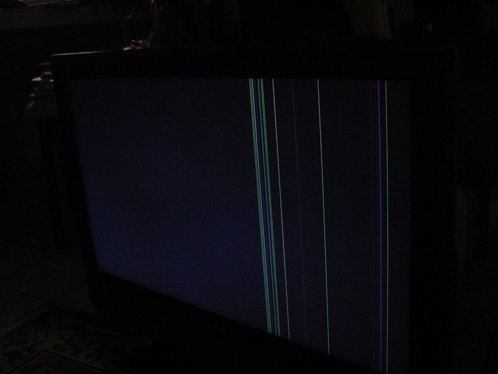

Insignia NS-LCD32 2007 lines on the right

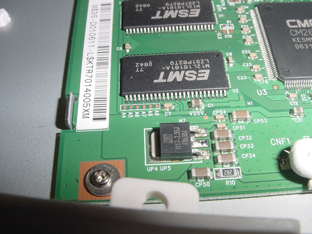

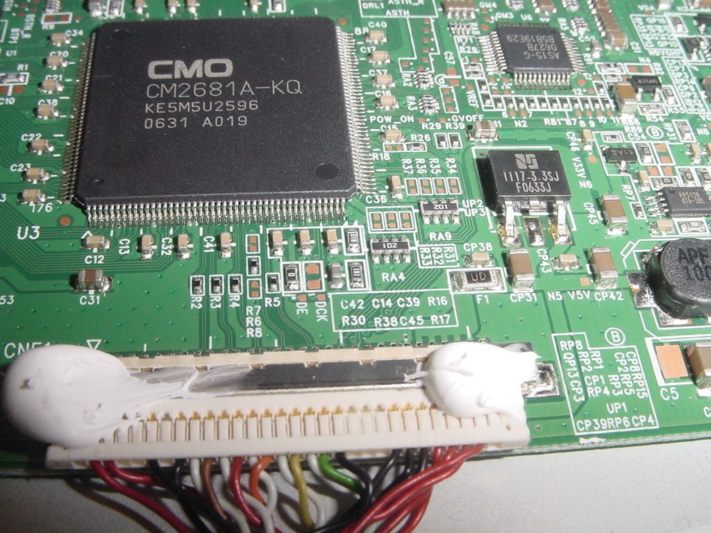

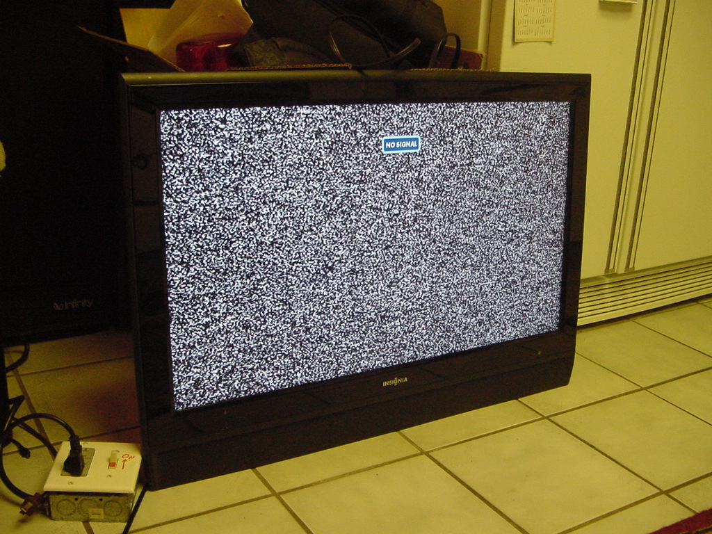

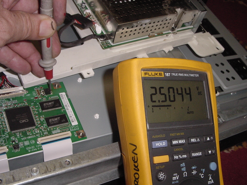

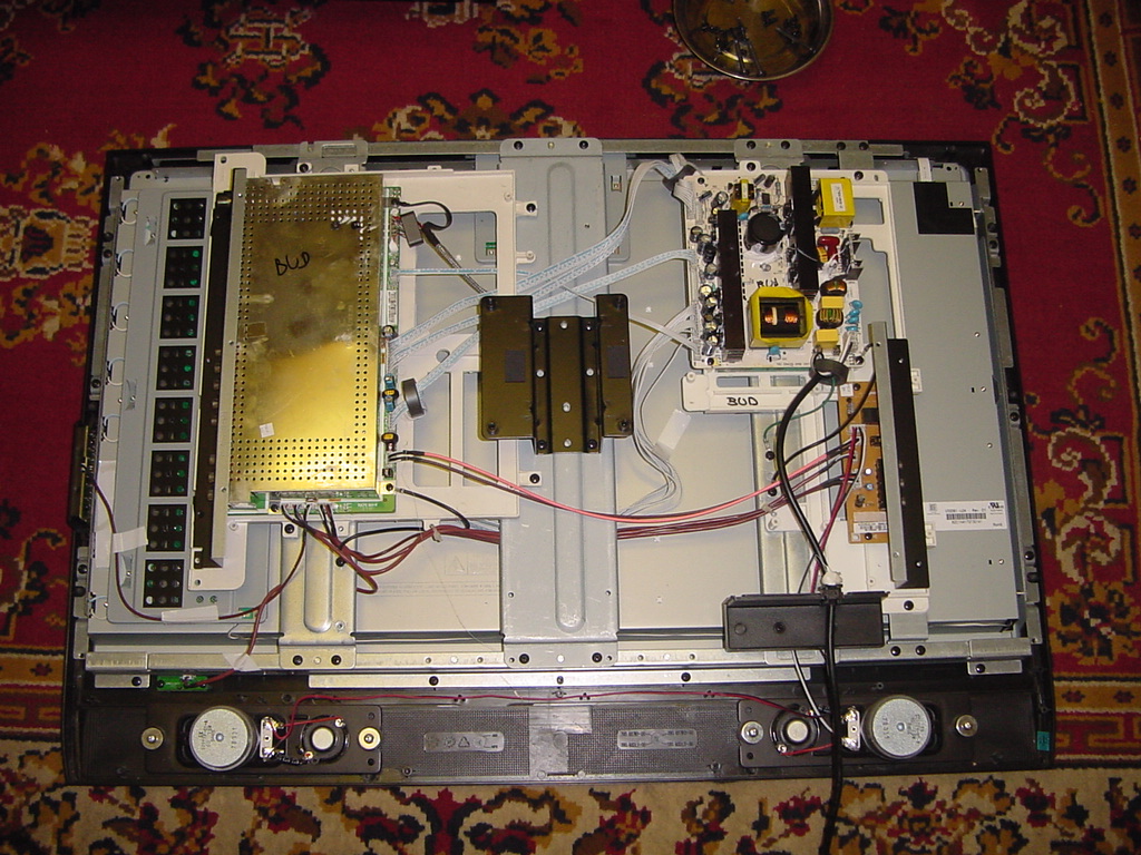

    Just fixed this TV. The symptom is it has backlights but no pictures or on screen menu, color lines on the right side of the screen.

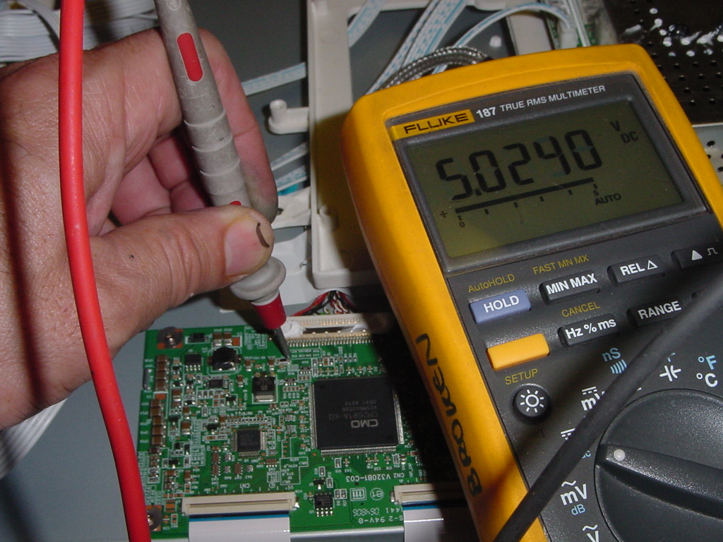

    I knew it has to be something on the T-CON, it is either not getting the VCC to the board or something on the board itself since it has no pictures or menu.

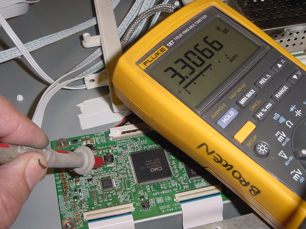

    Check fuse and 5V feeding the board are OK, checked the 1117-3.3 and 1117-2.5 (3.3 is good, but the 2.5 is only reading 0.6v), Ohm it out to see if ts feeding shorted circuits, the Ohm reading is about 350 Ohms (due to the network resistors for the 2.5v output setting), remove the IC, Ohm the output pad to ground, it shows 30K. Replaced the 2.5V IC, now it is working again, half hour job. Letting it burns in right now.
    More pictures here:

    Bonus points for a short of the Fluke 87!

      That is my new FLUKE 187!, I still have the Fluke 87.

              The Fluke187 was broken, all the voltage readings were 1/2 off what it should be. It was donated for recycle since Fluke wants almost as much to fix it to buy a new one, so I get to have it and I fixed it, it has one burnt up resistor on the board. I will need to calibrate it, right now all the readings are the same as my FLUKE87.
              These 1117-xx series must be bad design or something, I hardly see any LM 78XXX/79XXX/317 failed (you can put dead shorted on them and they just go into shutdown).
              It is strabge that you will see just some lines on the screen likethat when the Main chip on the T-CON does not get enough voltage.
                I think the thermal limits for the 1117's are too liberal, such as to allow for cheap designs. The lifetime of a semiconductor approximately halves for every 10C rise. Engineer, under pressure from manangement, runs the LDO at 130C junction-case - thinks they're really clever saving 50 cents over a low-temp efficient switcher or even a bigger LDO. Maybe device is 150C rated at a MTTF of 5,000 hours. So the chips on average fail after 20,000 hours -> ~2.3 years. Also, a 78xx needs a 2V in-out difference, so for any substantial current, it needs a heatsink, and once you get a heatsink, there's little cost to make it a better heatsink. Also remember that CMO, the LCD maker, doesn't care if the LCD lasts, as they aren't responsible for replacing it. In fact it's probably good to increase sales.

                I guess the 2.5V is used to power the main processing core (to allow for smaller transistors, hence more on same size die), and the 3.3V is used to control the output drivers. So any fault in core will cause it to send random signals turning on random lines.
                I still don't fully understand the operation of that IC. Does it directly drive the panel (driving positive and negative TFT ON/OFF voltages), or just control the drivers on the LCD?

                  I sure like to see the schematic of the T-CON board (any brand, since the basic operations are about the same) to get more details on how it works.
                  teh 2.5V regulator was for the Main IC on that T-CON board.

                                  Ok.. I just picked NS LCD32 lcd for repair.. the 1117 2.5 was reading 1.5v and 4.9v. I got one red line down the middle sometimes 2. So, my question is, which 1117 2.5 do i get for a replacement?
                                  There are many 1117 2.5 IC out there. thanks guys!
                                    Re: Insignia NS-LCD32 2007 lines on the right
                                    See PDF for SOT.
                                    To be sure, are you talking about the 2.5V SOT or the larger one as shown in my picture?
                                    Pictures will help.
                                    See footprint on the spec sheet to see which one match your regulator body size.

                                      Yes. My 1117 2.5sj is reading 1.5 and not 2.5 So I assume it's bad. The 3.3 tested fine.
                                      So, if you have a specific brand, I would like for you to share it with me.
