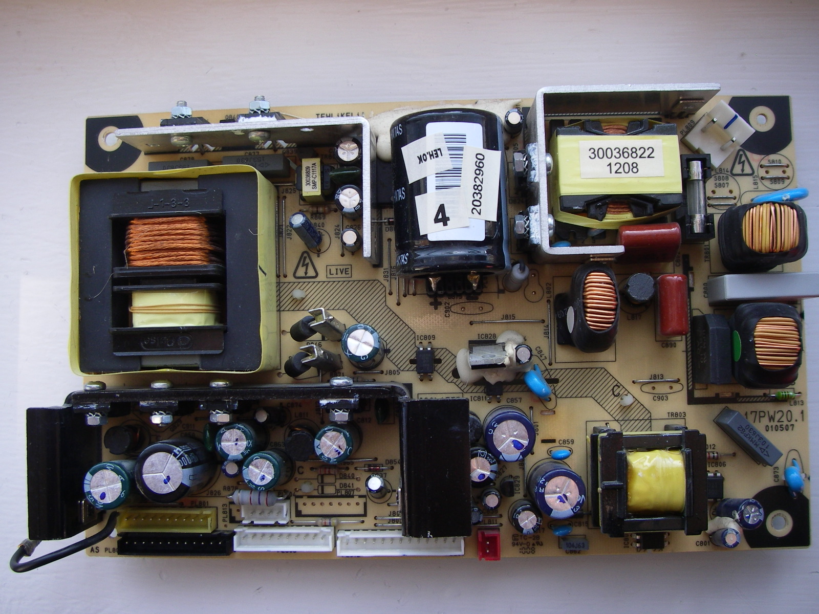

    this model suffers with bad caps,repaired one recently with same symptoms,heat up the capacitors with a hot hairdrier just to confirm,they dont fail bloated or leaky,panasonic fc are good for these ,the ones you have are gp caps

      If that doesn't fix, 17PW20 supplies are often fixed by replacing them outright - they are about 20 quid on ebay for 17PW15-9 (which is compatible.)

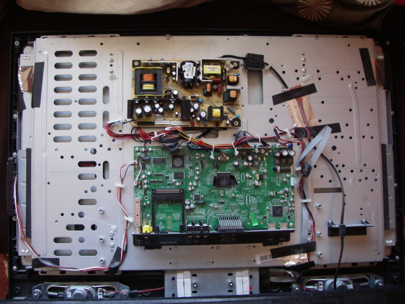

                    Hi - if you are going to try and fix this you will need a digital multimeter, if this is a one off venture into electronics you can probably get by with a one for a few pounds.
                    We can help a lot more if you post good clear pictures of the whole chassis, and then pictures of each board, front and back and close up of connectors, (max resolution 2000x2000 and 2MB) using the manage attachments button, which is found by clicking "go advanced" under quick reply.

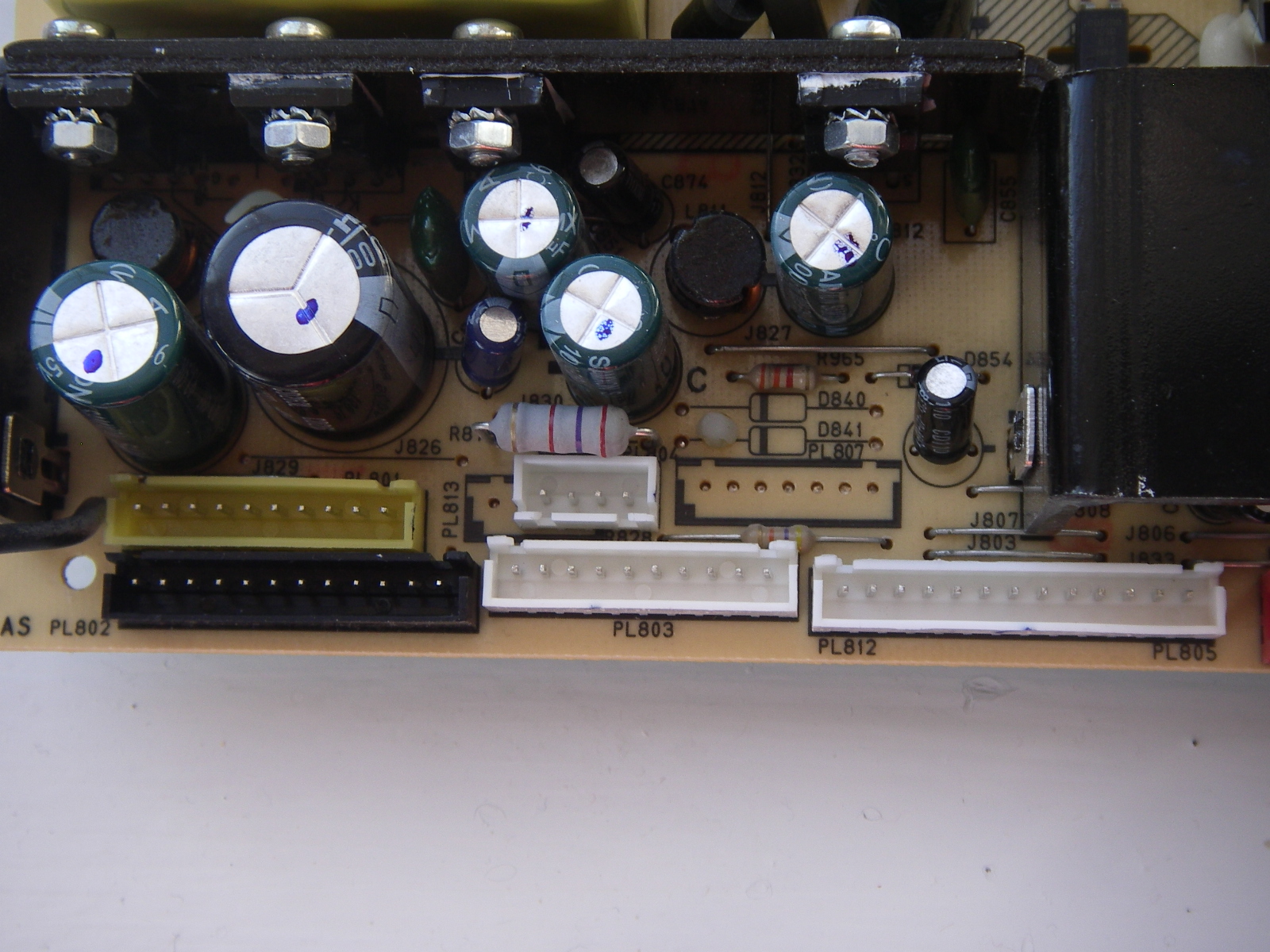

                          Are G-LUXON caps rubbish?
                          What make did you replace them with?
                          Darren
                            In a word yes (At least on a power suppy board)

                                    Hi Chandyman I used panasonic and rubycon from CPC and s for G-luxon caps I have seen a lot of these caps go bad so yes i would describe them as rubbish.

                                      Mine are G-LUXON and SAMXON (which i assume are just as bad)
                                      Do you replace them like for like, i.e same voltage and uf or can there be a little difference

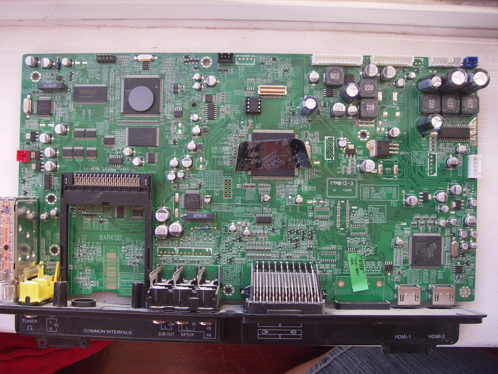

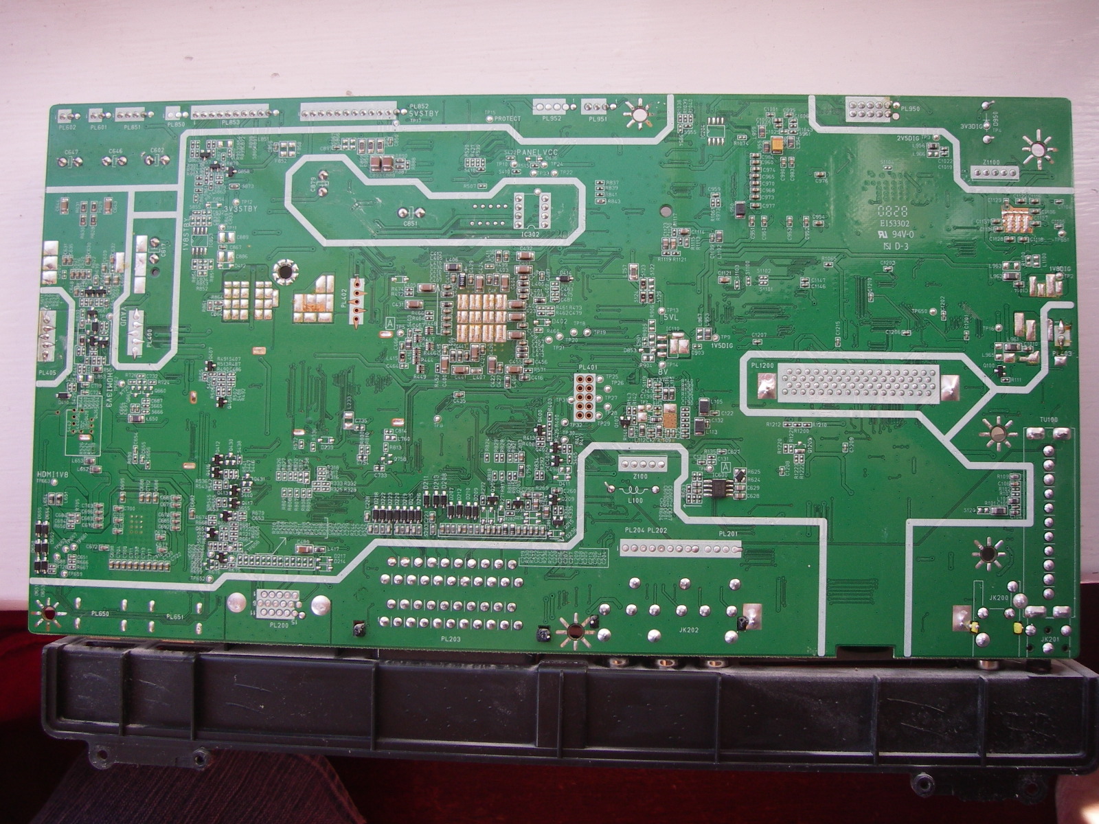

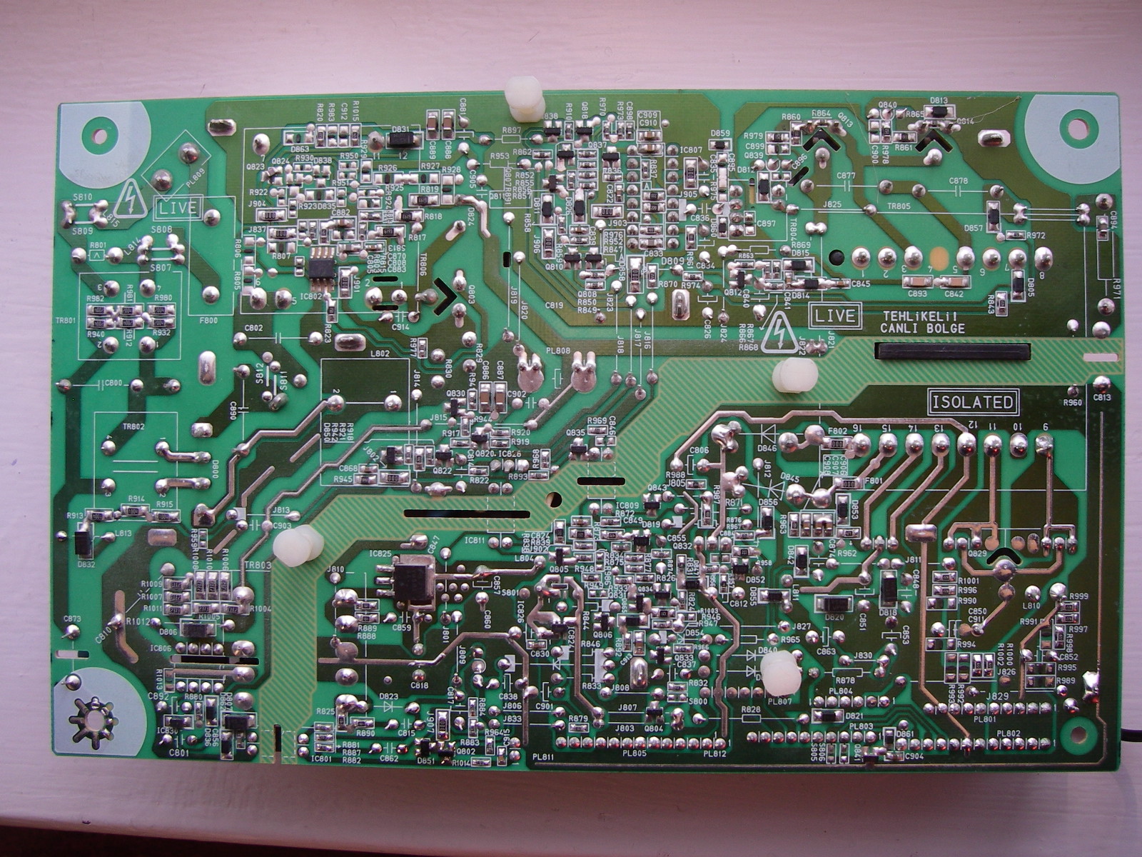

                                        Hi selldoor,
                                        Here are the pics of the chassis, front and back of the power unit with close up on the connectors and front and back of the main board.
                                        Darren
