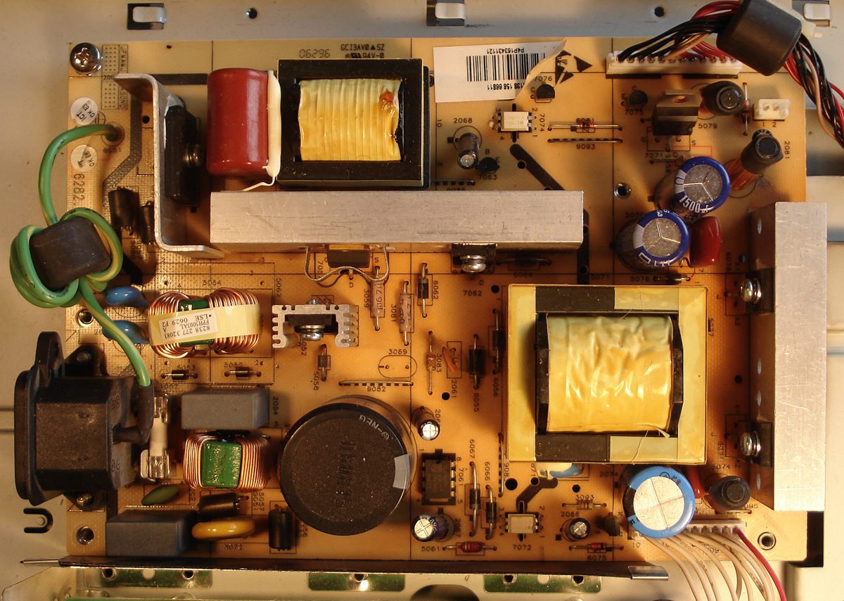

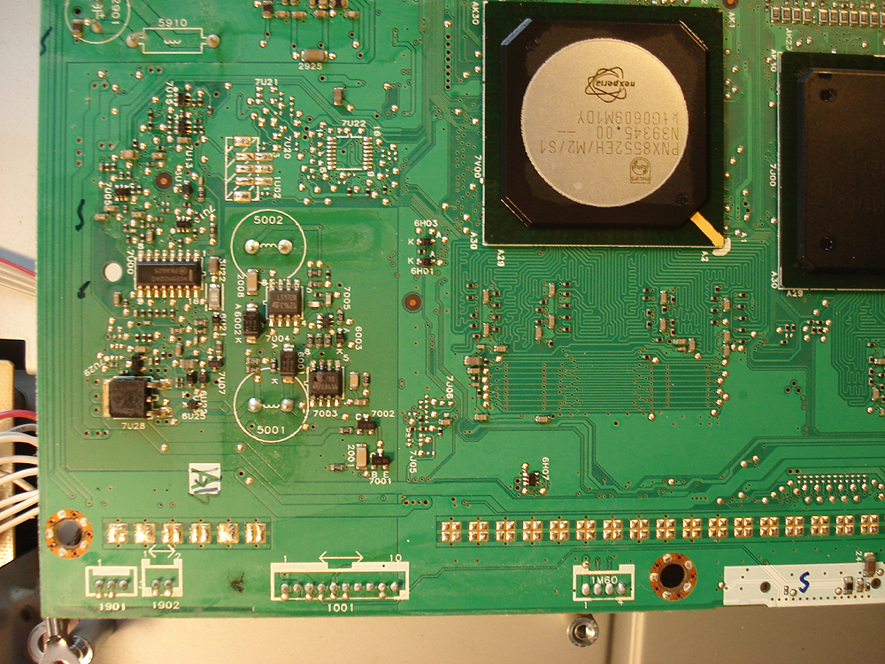

    The backlights come on and the green led lights and stays on. The power rail to the main board (bottom right near light blue cap) starting with red reads 16.3, 16.3, 24.1, 6.7, 4.2, 0, 0, 0, 1.2, 0.
    I've replaced the 3 larger caps (2 dark blue and 1 light blue) on the power board. They were swollen and commonly go on this board. Please help with what to try next. Cheers.....Ray

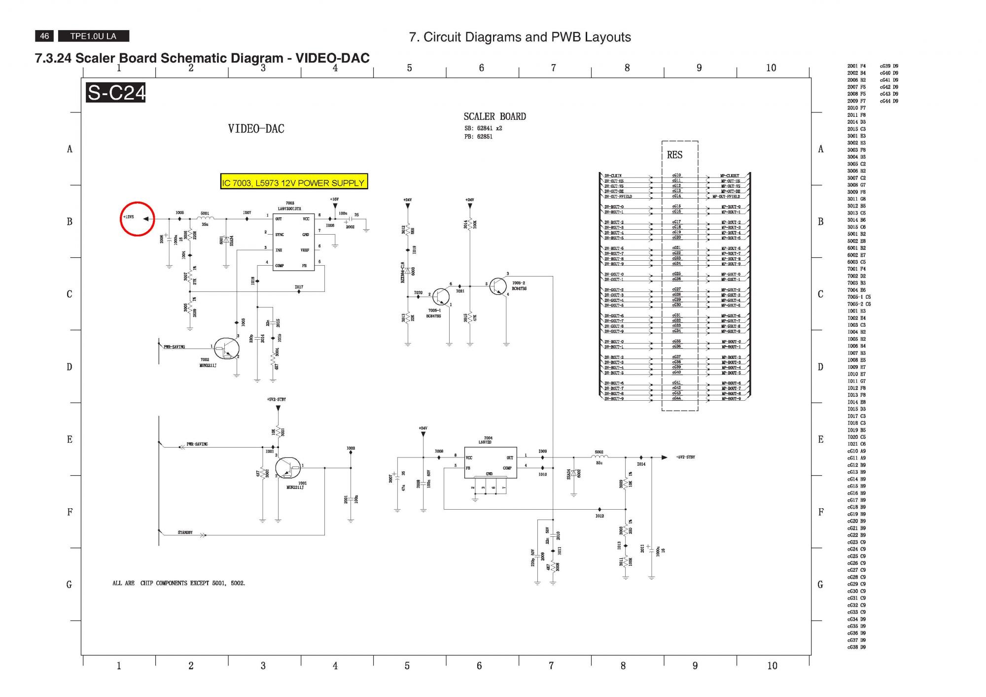

    Please see the PS diagram, see if it matches yours, and tell me what you see on the connectors on the left side of the diagram, it will a lot easier for me to troubleshoot the problem.
    It sounds like you have problem in the main board.

        Re: Magnavox 32mf231d no picture or sound
        Hi, I'm quite sure it's the same board, looking at the second diagram in the pdf. you've shown me. In referring to your second reply question ....If you're asking for the voltages on the 12 pin connector to the inverter....they are 24, 24, 24, 24, 24, 6.7, 4.1, 0, 0, 0, 0, 0.

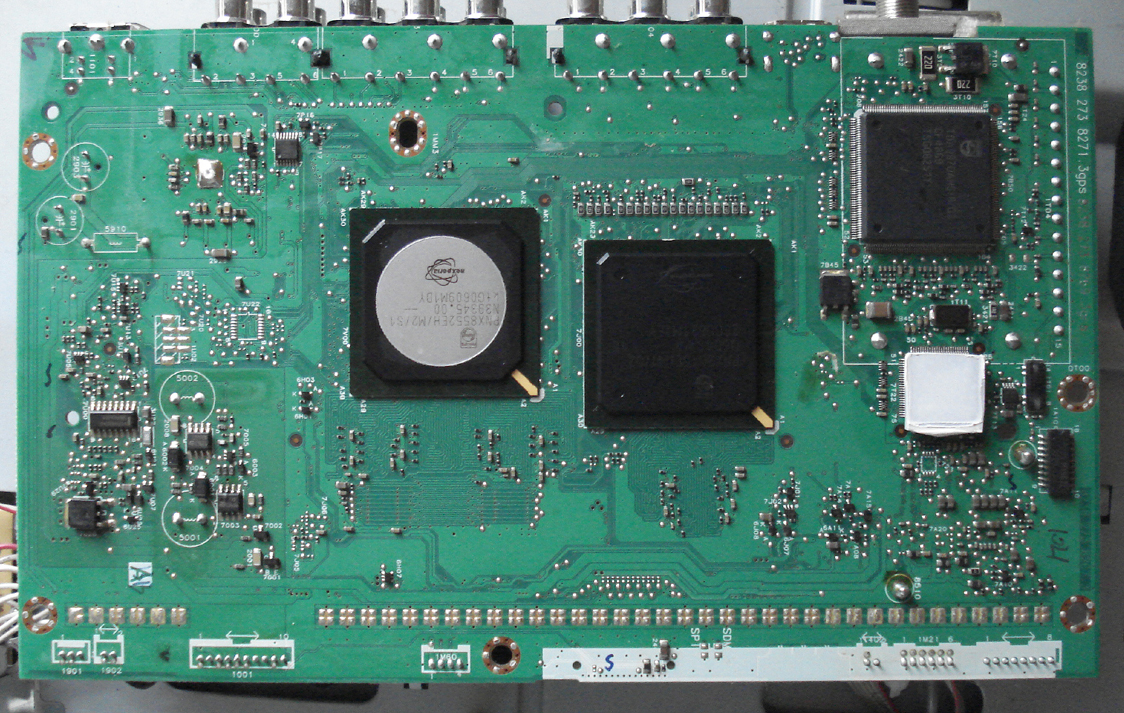

          OK, at least the power supply is OK and it does send the Inverter on to turn on the backligts, but some how there are other failed parts in the main board that cause the lost of the pictures and sound.
          We need to check voltages on the main board first, starting at the 3-pin regulator first.

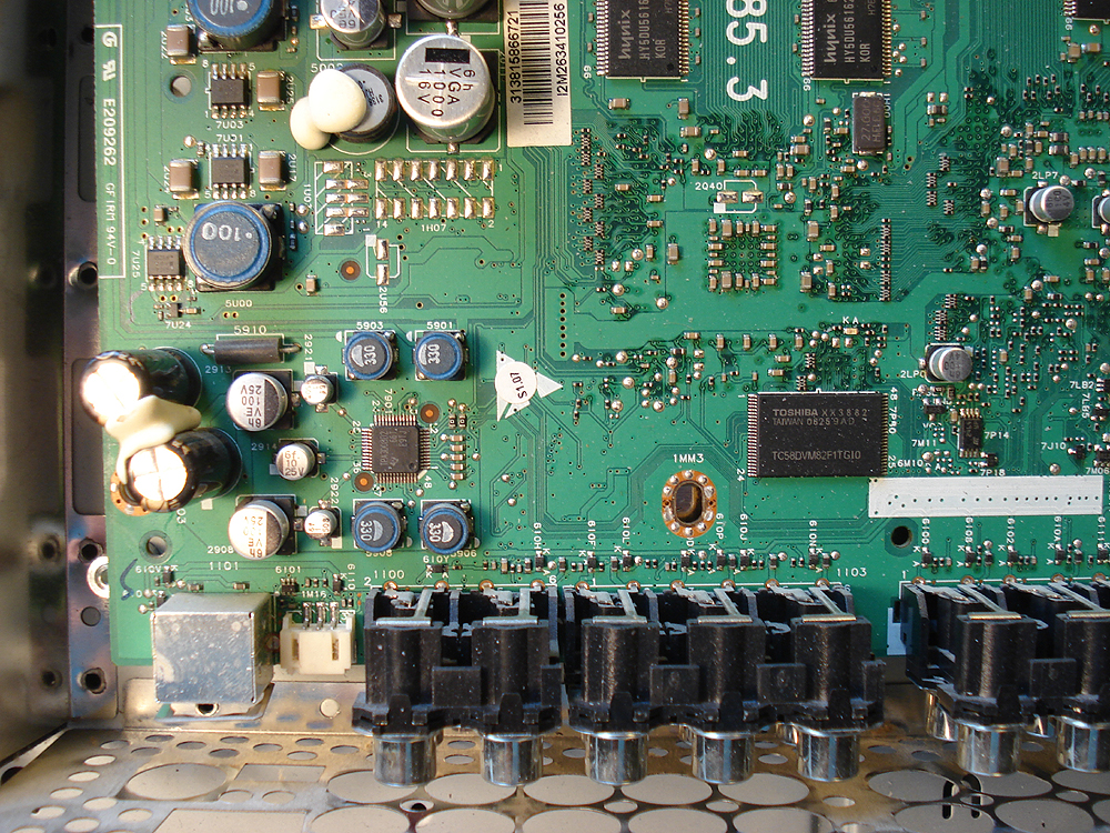

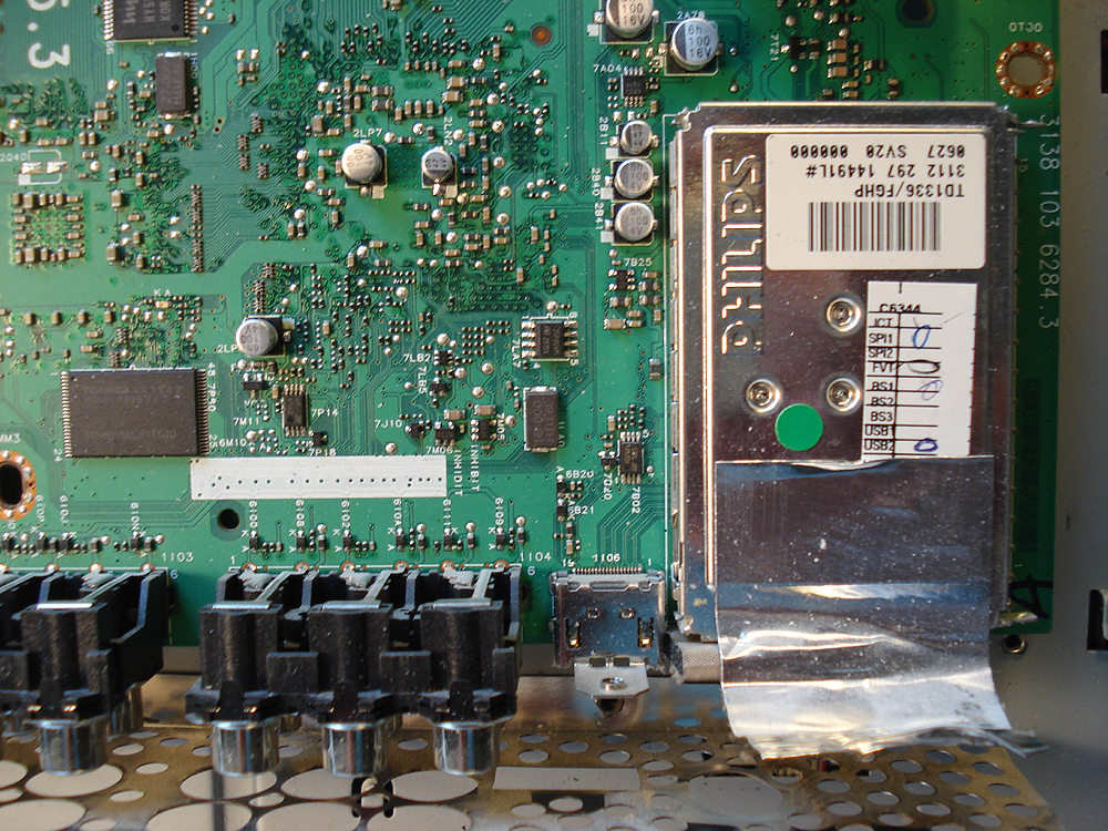

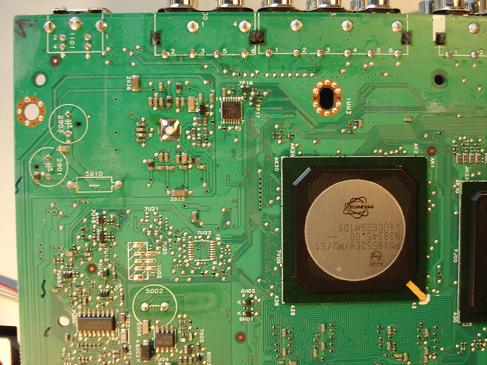

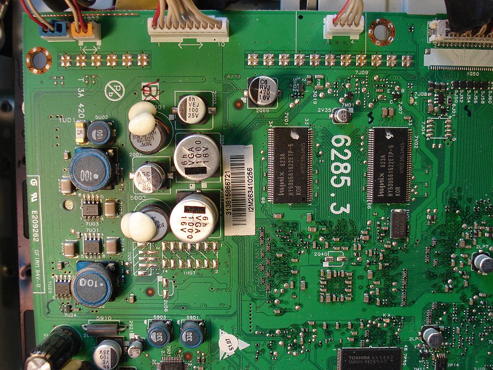

          Can you please take good clear pictures of the main board as a whole, and then 1/4 section pictures of board so we can see good closed up pictures? The service manual does not give good pictures.

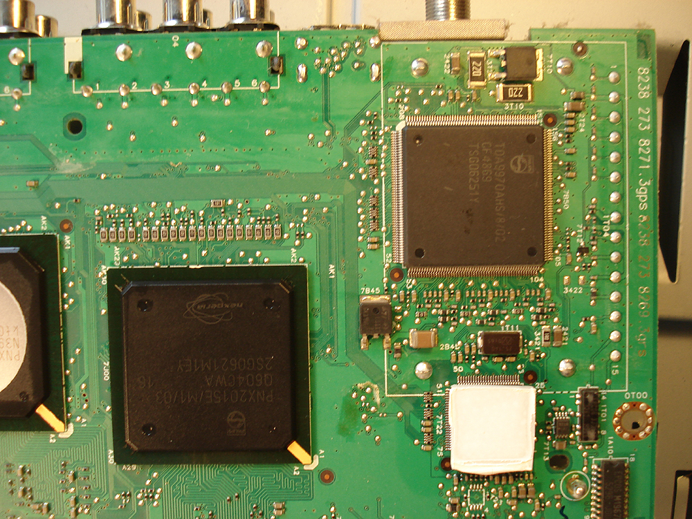

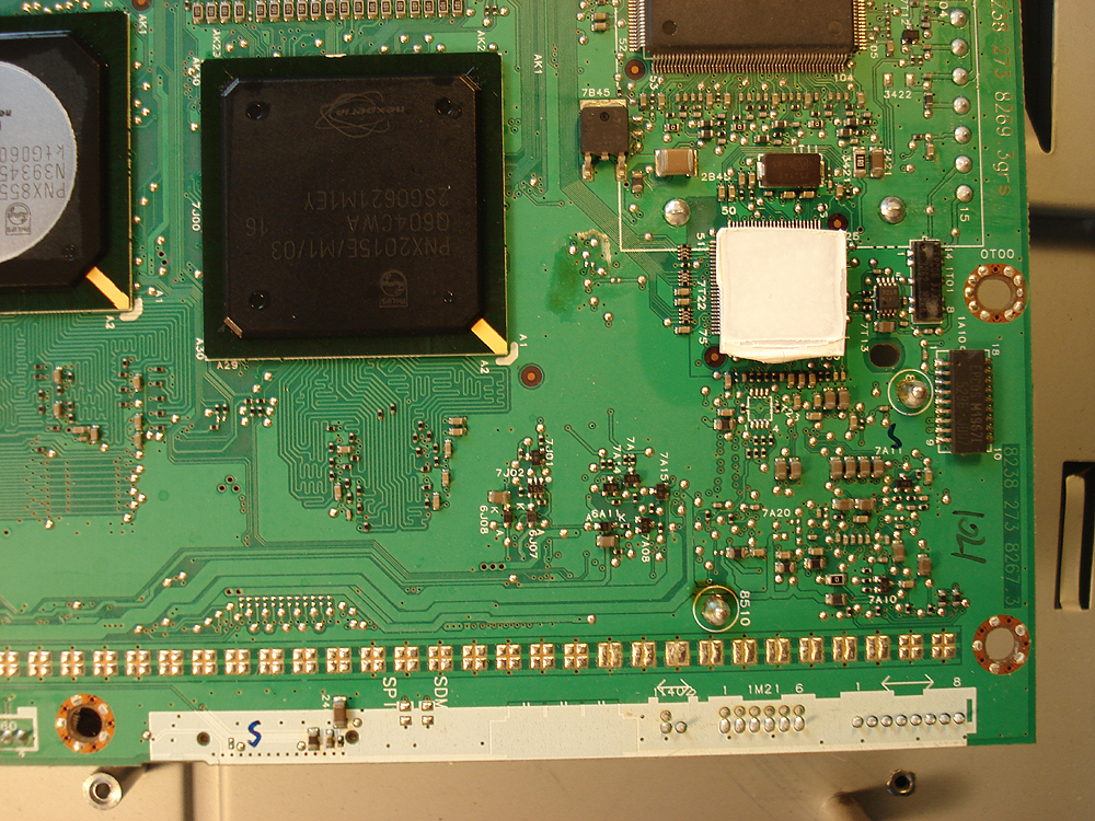

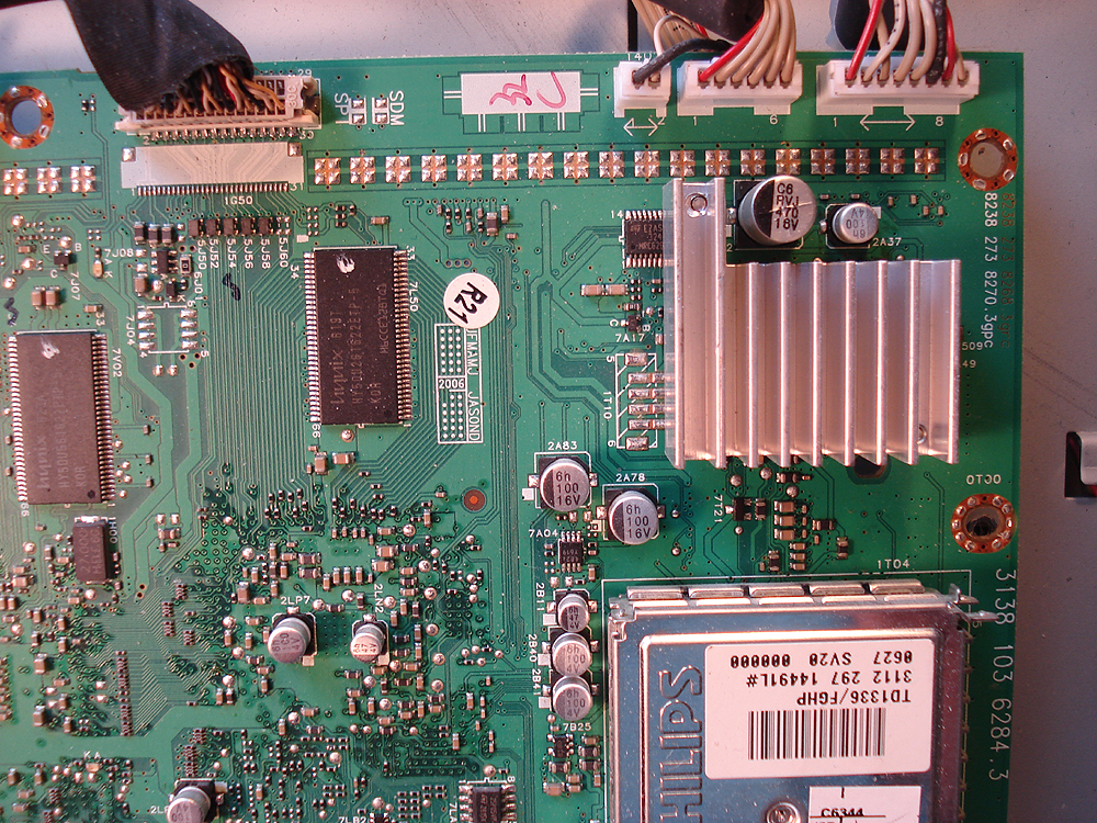

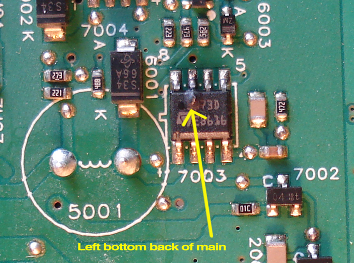

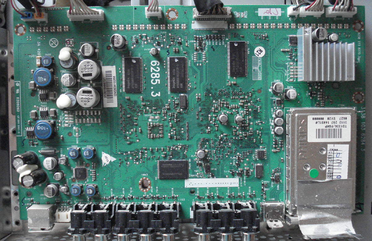

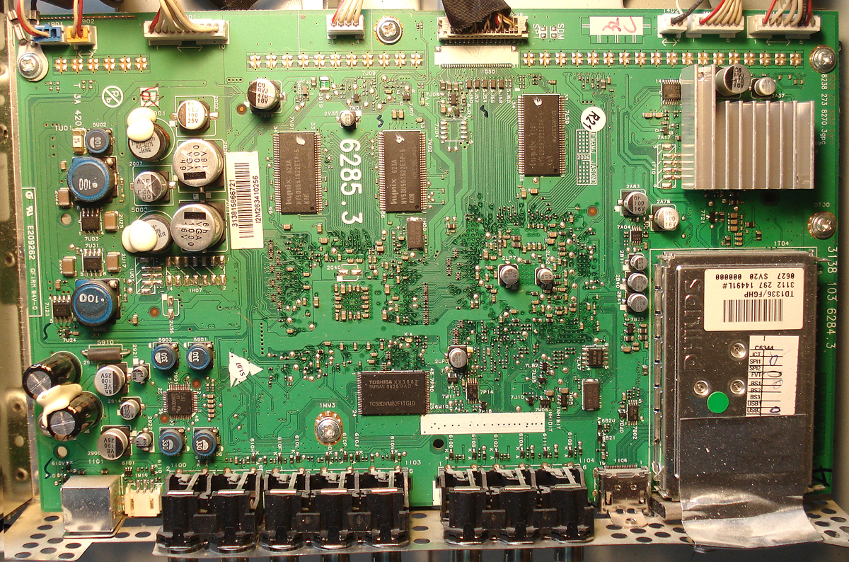

            Here are new pics and a close-up of a possible problem (my guess anyway).

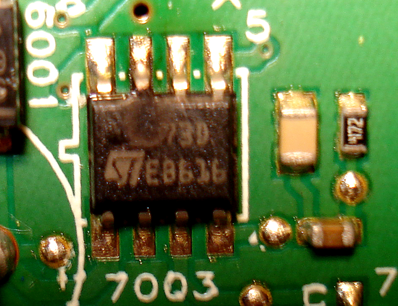

              I think you have found the problem with that blown part. At this point, just to be sure we have the correct service manual for this chassis, can you get the chassis number for this TV, the part is blown up and I cannot see the complete P/N on it. The link for the service manual is for 37" but yours is 32" so I want to get the correct information. It looks like a switching regulator IC.
              Follow-up:
              I look at the 37" version service manual, the IC is for the 12v buck regulator P/N L5973.
                Hi budm
                First of all........Thank you very much for your generous help and your time.
                I've been trying to download the pdf manual but it keeps shutting down the download at 3.7mbs ........... I'll keep trying. I think you've identified the right part #.
                I've included one more close-up of the part. I scraped the swollen area off, it was like dry crumbly soot but unfortunately the rest of the id number is gone. I'm far from understanding how to read these electronic diagrams but I'm trying. Cheers....Ray
                  I believe that is the correct part number as shown the scaler bd PDF as I have onpost #7you can see that the coomponent designators match your picture. The IC deisgnator is 7003, the inductor desigantor is 5001, Diode 6001 also matched.

                                    Are you able to read the component markings on top of your chip? He wasn't able to read his.
                                        L5973D works from digikey.
                                        Replaced it and everything seems to be working for now. Just be careful for there is an exposed pad on these SOICs.
