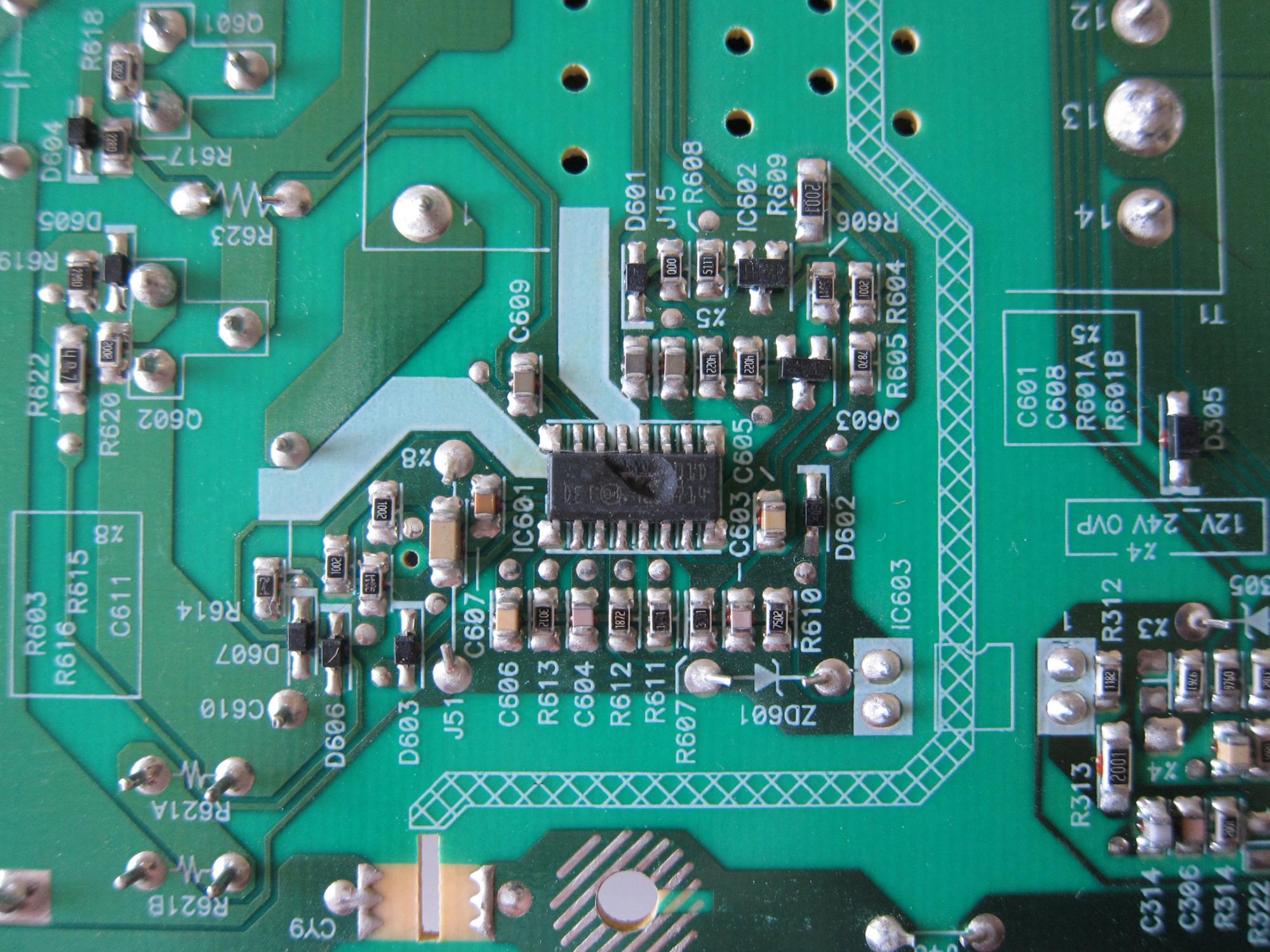

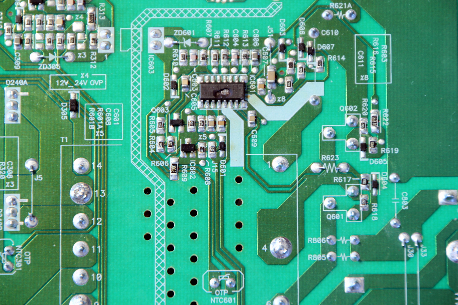

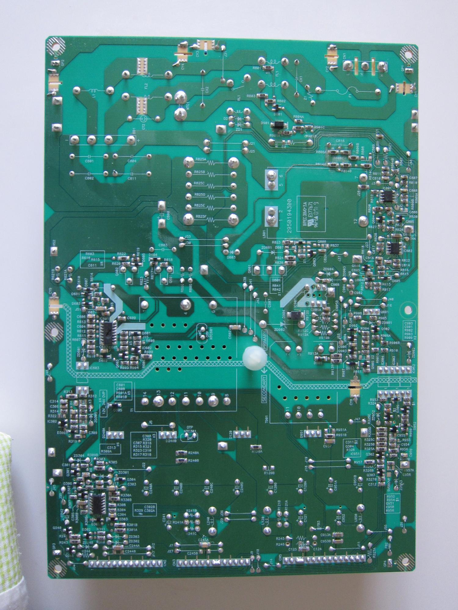

    My father was given a 42 Visio by a neighbor. They cut it on and heard a "pop". Opened up the case and looked the power supply over. 156 VDC at the main cap but no 5VDC STBY. Flipped over the power supply and noticed the blown 16 pin chip on the primary side. I believe this is the PWM chip? ShopJimmy of course sells the replacement PS for $50, but I would like to take a stab at repairing the PS. Anyone seen a Delta PS like this with similar issues?

    That blown chip will have blown other components at the same time. I can see that at least a couple of SMD resistors are blown just underneath the IC.

      Check Q601, Q602 in the picture for shorts also.

                              Amazing! If I didn't know better I would have thought you took a picture of my power supply from a vizio VS42LFHDTV power supply part number 0500-0507-0331 DPS-283BP A REV S0
                              I purchased a power supply from shopjimmy.com for $49.00 and free two day shipping during the month of April.
                              I too would like to find out where I could get that ic chip. the replacement boards chip had no identification on it. To the person that said that it looks as if some resistors had been blown , are you going by the discoloring of the resistor?
                              Also the locations Q601 and Q602 what exactly are they (sorry for my ignorance) and would I test them for a short to ground or continuity across certain pins. I would love to have a backup power supply for my TV (which is working perfectly with the replacement board BTW) Thanks in advance for any help.

                                Thanks to all. The replacement PS from ShopJimmy worked well. We were able to scavenge the variac and used a DVM inline to watch for spikes in the current draw while powering up slowly. Always a little intimidating when it is not your own stuff you are working with. The set did not seem to have any other issues and drew a nice picture.
                                Sparky, regarding the suspect resistors, I measure each one alongside of the devoured chip and then compared them with the new powersupply. About 5 resistors were damaged. Several were much higher in value and others were almost shorts. Regardless of their varying values, they all had bubbling on the top side when looked at closely under a magnifying glass.
