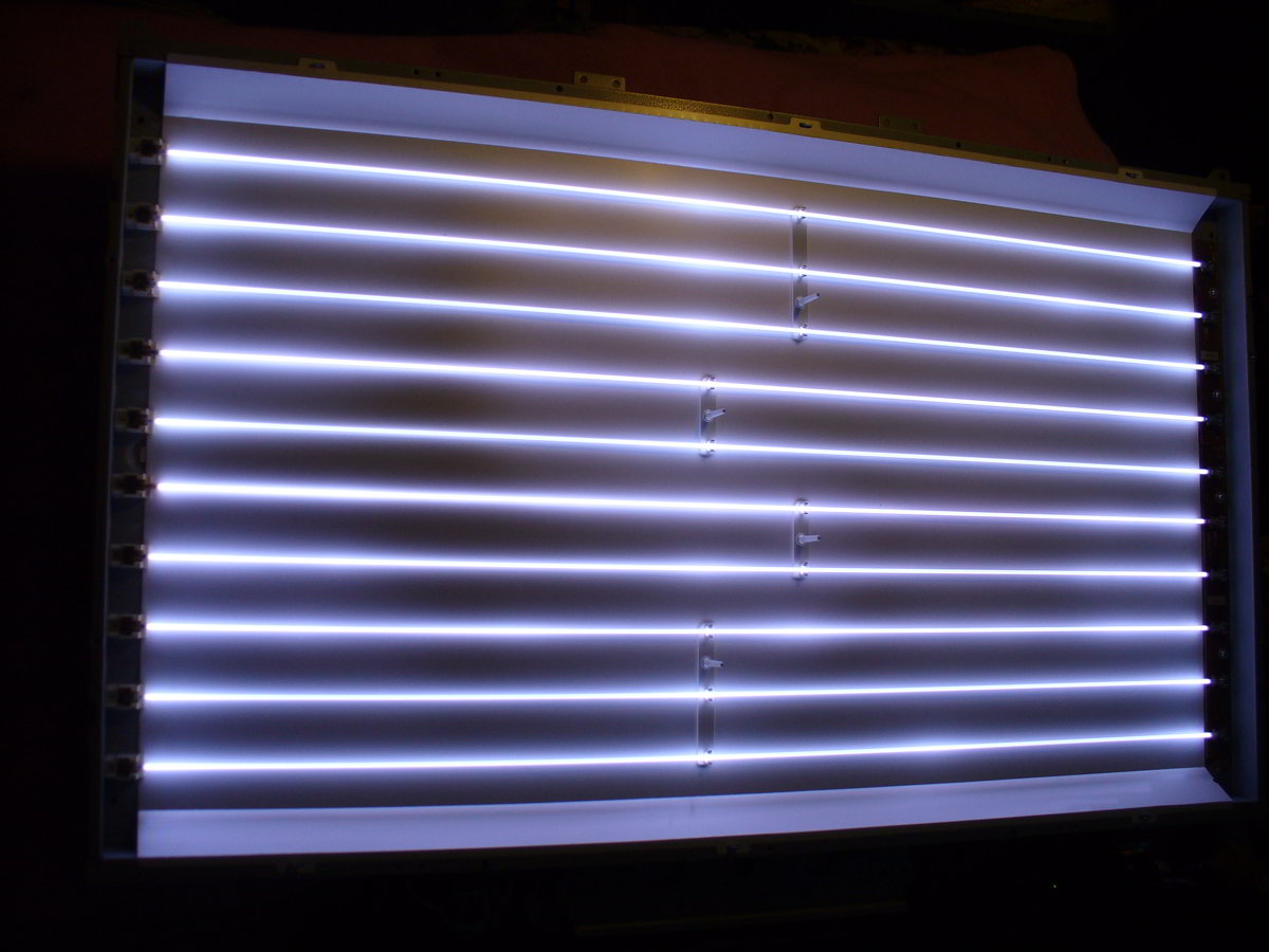

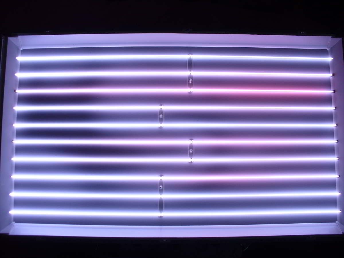

                                Replaced 6 bulbs for $18. From Sharp LC32sb23u(not 24u) found on C/L as non working.
                                $18 invested and now have nice tv for my spare room.
                                I have 3 bulbs, good LCD screen, diffusers, and mainboard leftover if someone needs them. SMPS was shot (commercial power transformer strike), Old lady said it was only 15 months old when it was keeled.
                                Also, you can do a white screen input and see bad lamps before taking it apart.
                                Pics below of bad and good lamps.
