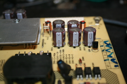

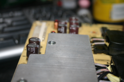

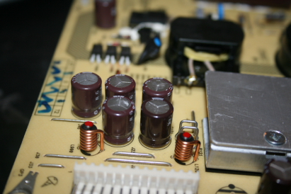

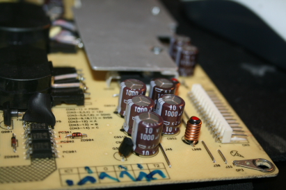

            By the way, my post #41 with the attached PDF, I also circle some caps that look like they have domed tops, did you verify that, may be its the distorted pix.

              I took these pics earlier then walked away from it for a day to try another avenue hopefully be successful this time.
              Here are 4 views of those caps, they do look odd at certain angles, but when I look closer then they look okay...
