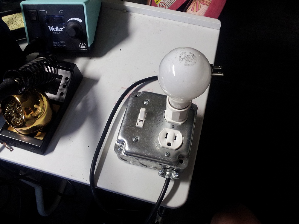

    Finally I have put together budm's short circuit tester. It came out very nice and compact. One steel box(the ones which goes into the wall), steel cover with switch and wall outlet cut out, wall switch and a wall outlet. The bulb is a plug in style and plugs in in an outlet, the other outlet is for the testing device. One of the side bridges from the outlet I have separated. A TV power cord and one of those clamps with nut on the side of the box and it's all compact and nice.
    I will take pictures when I'm home.
    One of the monitors (thanks to budm for helping repair it) is set up on one of the benches(IKEA $40 kitchen table ), now I(we) have to repair that Asus to be able to install it on the real workbench. This way I will have two separate work places with two monitors. I can work on two TVs now. Need more help from budm

      Here it is:
        #83
        Re: Instruments/tools needed for TV repair
        That looks great, you will be so happy when you are trying to find out if you still have short circuits or, when it is bad it will light up bright right away. You can prove that by putting a jumper across the filter cap to simulate dead short so you have some idea what it looks like, then try it with working TV or monitor, you will see how the lamp react.
        Do you still have that set with the shorted out MOSFET's that you replace twice? You should alo haev some 150Watts and 200 Watts for testing some big TV also.
