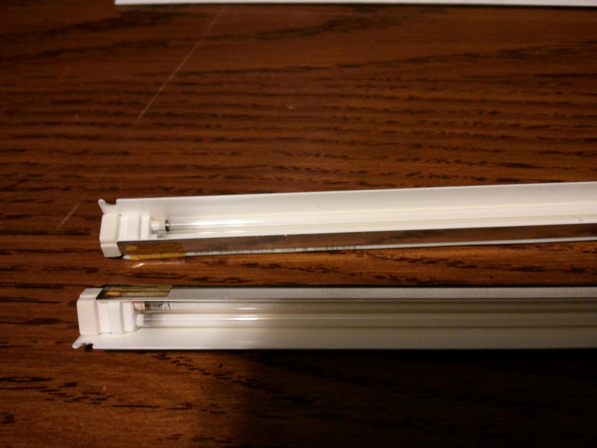

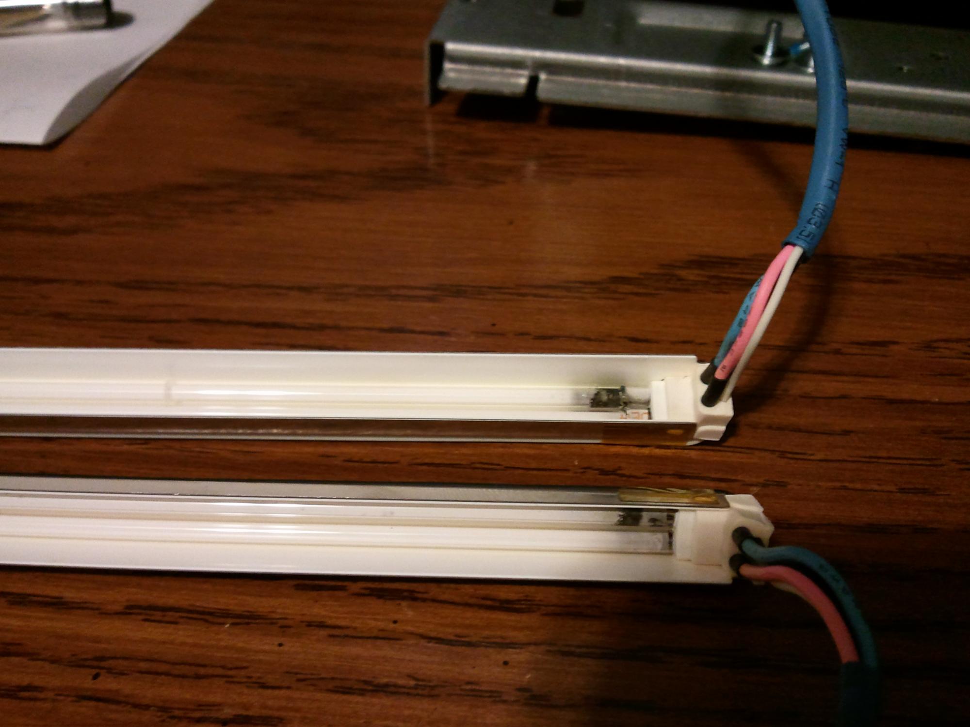

    My neighbor gave me a lcd tv that would power up fine and display the memorex logo sometimes for as long as 5 minutes then go dark. Flashlight shows a picture and it has sound. When the backlights came on you could hear a buzzing coming from the corner of the panel so i suspected bad ccfls. I tore the panel down to get the ccfls out and found they were indeed bad. Two on top and two on bottom. Both the bottoms were completely shot and only one on the top is good. Looked around for a few minutes to price new bulbs and decided to try out some leds. Ordered a 16 foot roll of flexible smd led ribbon that can be cut to fit for 15 bucks. Only need two 16 inch pieces but i can find something to do with the other 13 feet. Anyway, i'll post some pics when i get the leds installed.

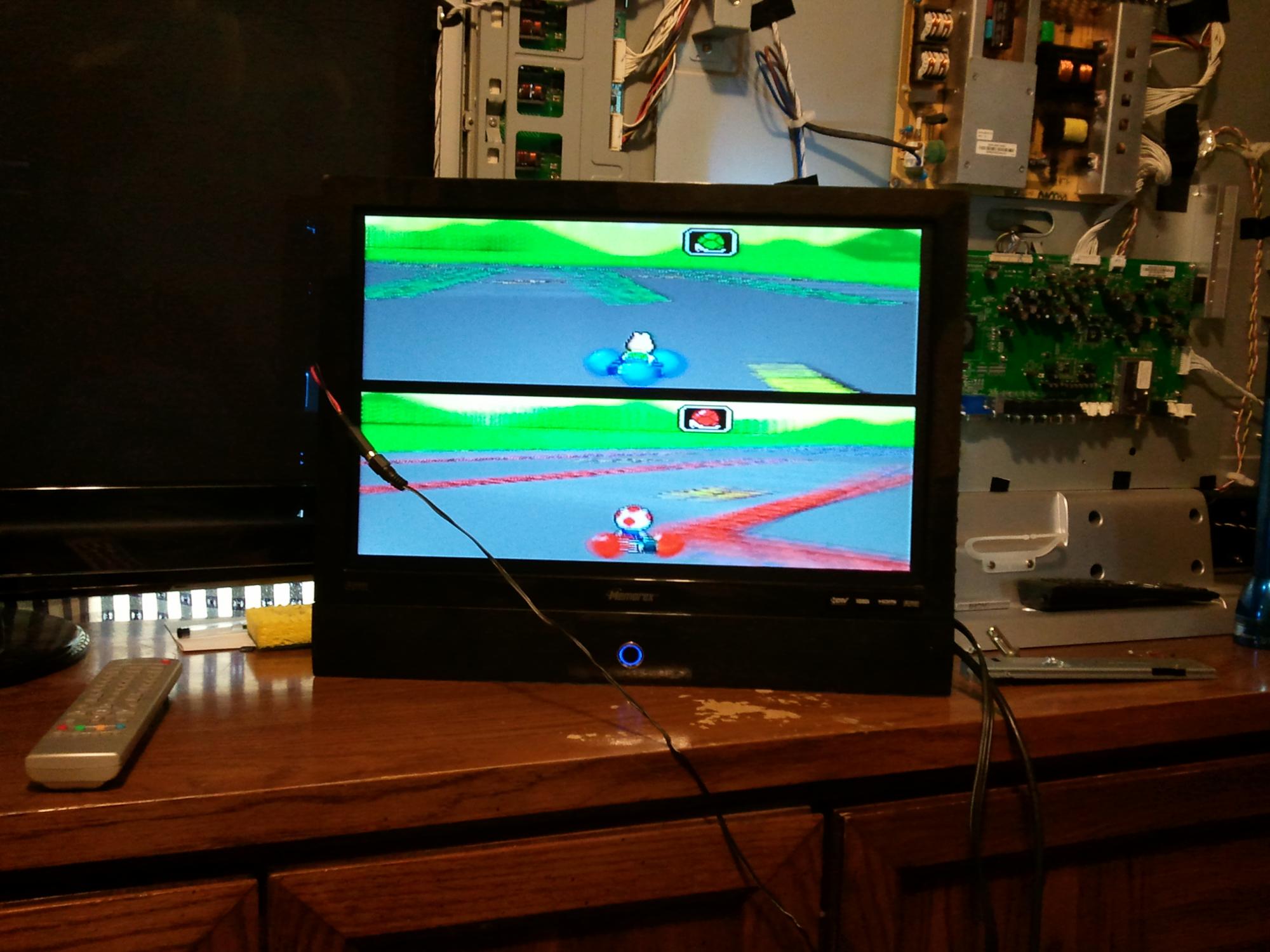

              Installed the leds today and the tv works. The picture is nice and bright. I tried uploading pictures but i'll have to wait until i get the laptop down to some decent internet. You can faintly see the leds shining on top and bottom in the picture but that was to be expected and it doesn't bother me much. The leds didn't come with a spec sheet so i can't tell you much more about them other than what i've already posted. I got them on amazon.com for 15 bucks.

                  Pics as promised. i"ll take some better ones where you can see the leds shining brighter at the top and bottom.
