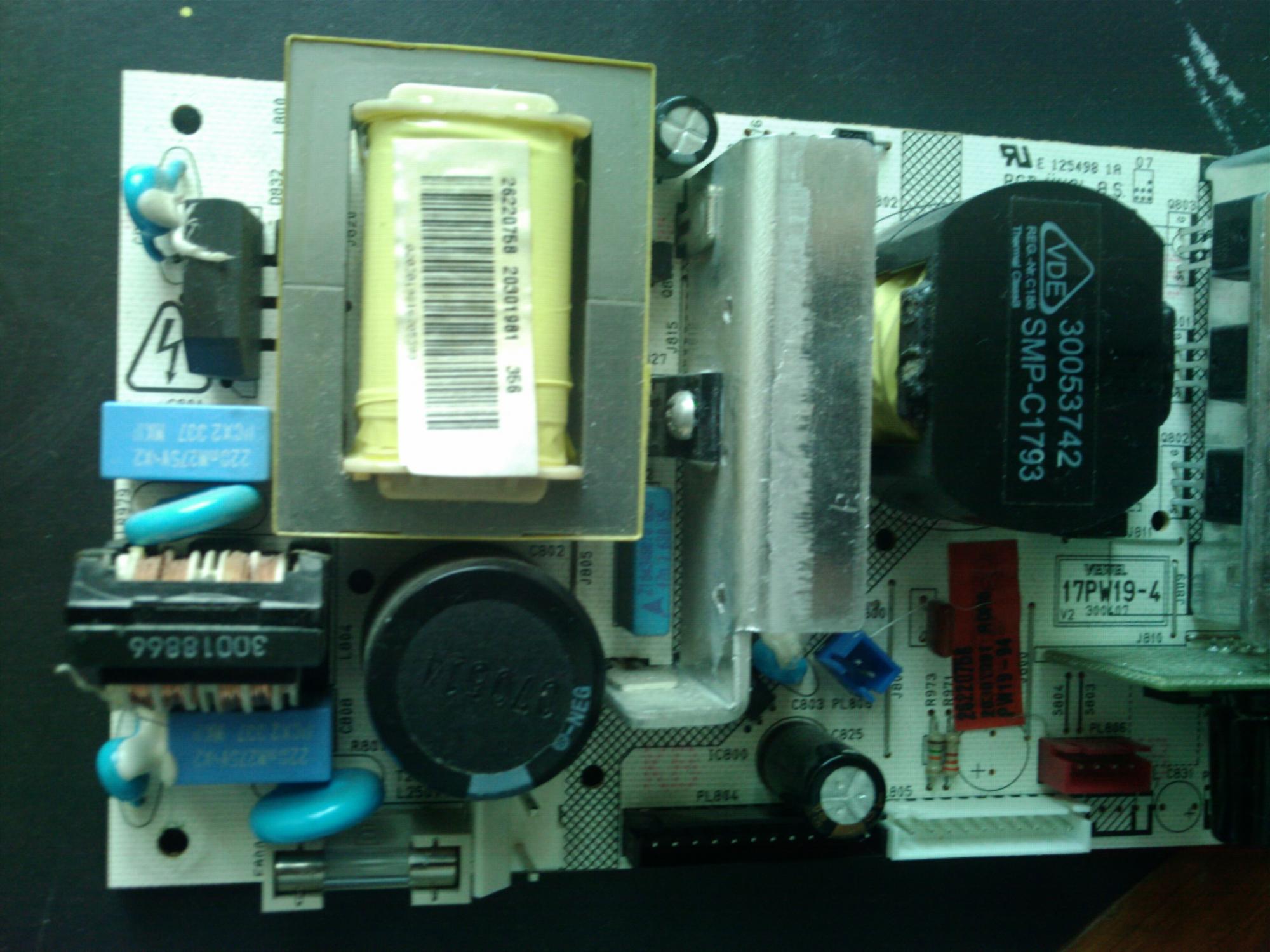

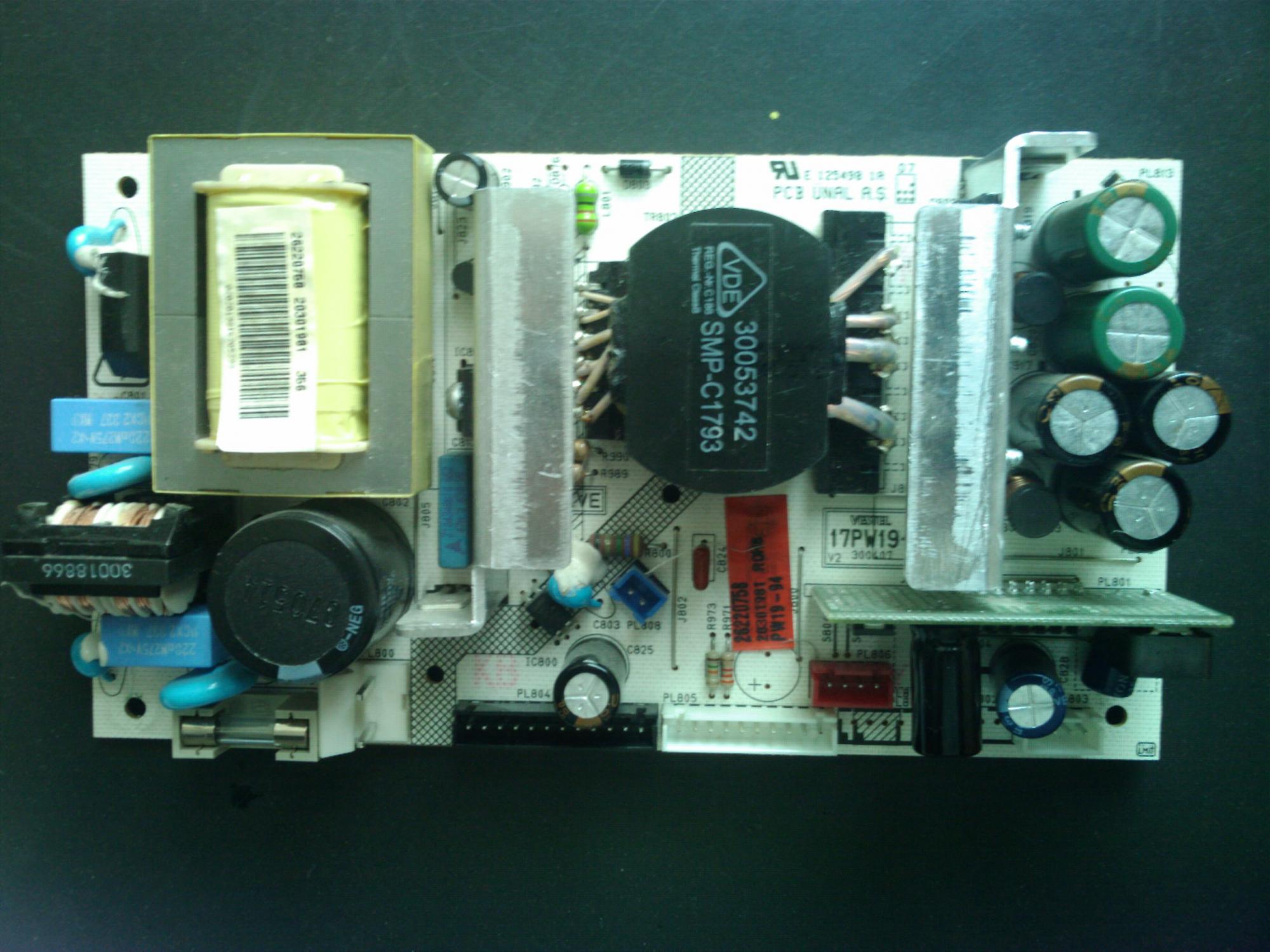

    When I switch on LCD tv Toshiba 23W330DB, the backlight has a continous quick flickering.
    I suspected a problem with the Vestel power supply unit 17PW19-4 (see attached pictures).
    I first measured the output voltage that goes to the inverter and found around 42Volts there!!! (no load i.e. inverter cable disconected).
    Any pointers please?

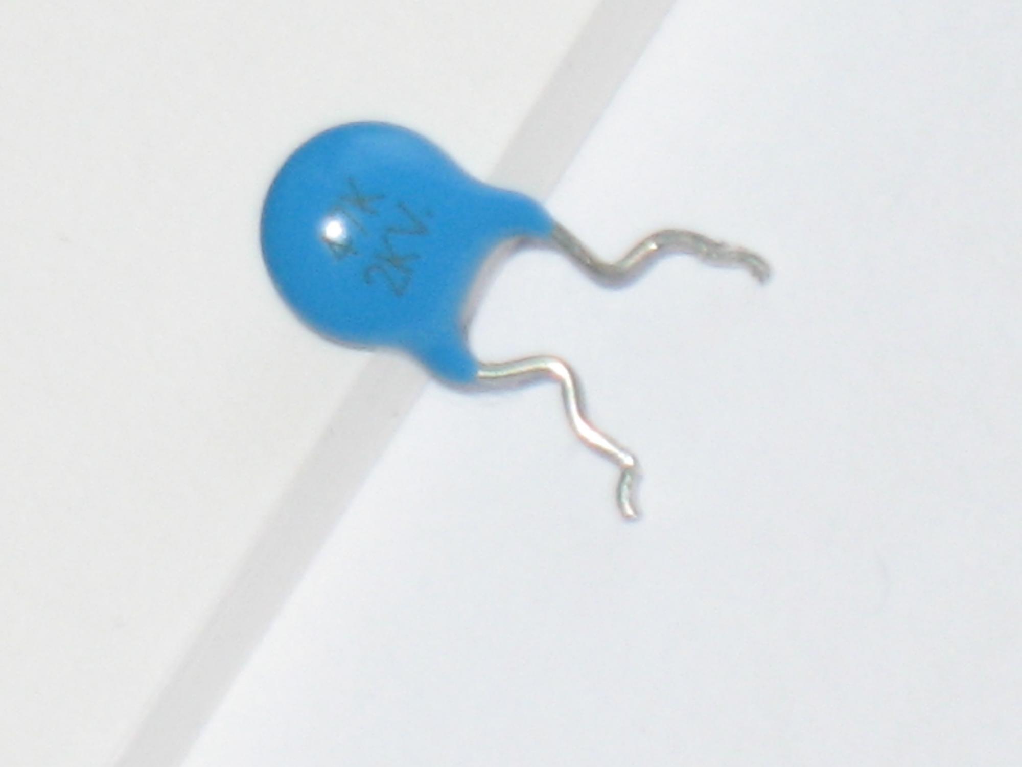

      I took the blue cap off. It says 47K and 2KV. I took it to a friend who measured it and found 80pF.
      Does this mean the cap is good or bad?

        I think that is bad.
        Can you show a picture of it? I think it's supposed to be 4.7nF.
        It's supposed to be DC 24V, usually.

          here is the cap. It looks fine (no cracks,...etc)
          Are you sure it's 4.7nF and not 47nF then?
            Re: Vestel 17PW19-4 (Intermittent backlight)
            I believe the 47K is 47000pF which is 0.047uF or 47nF

                Hmm, that looks like a Y-cap. Where did you find it? Y-caps are safety capacitors, they are not generally critical to the operation of the TV though.

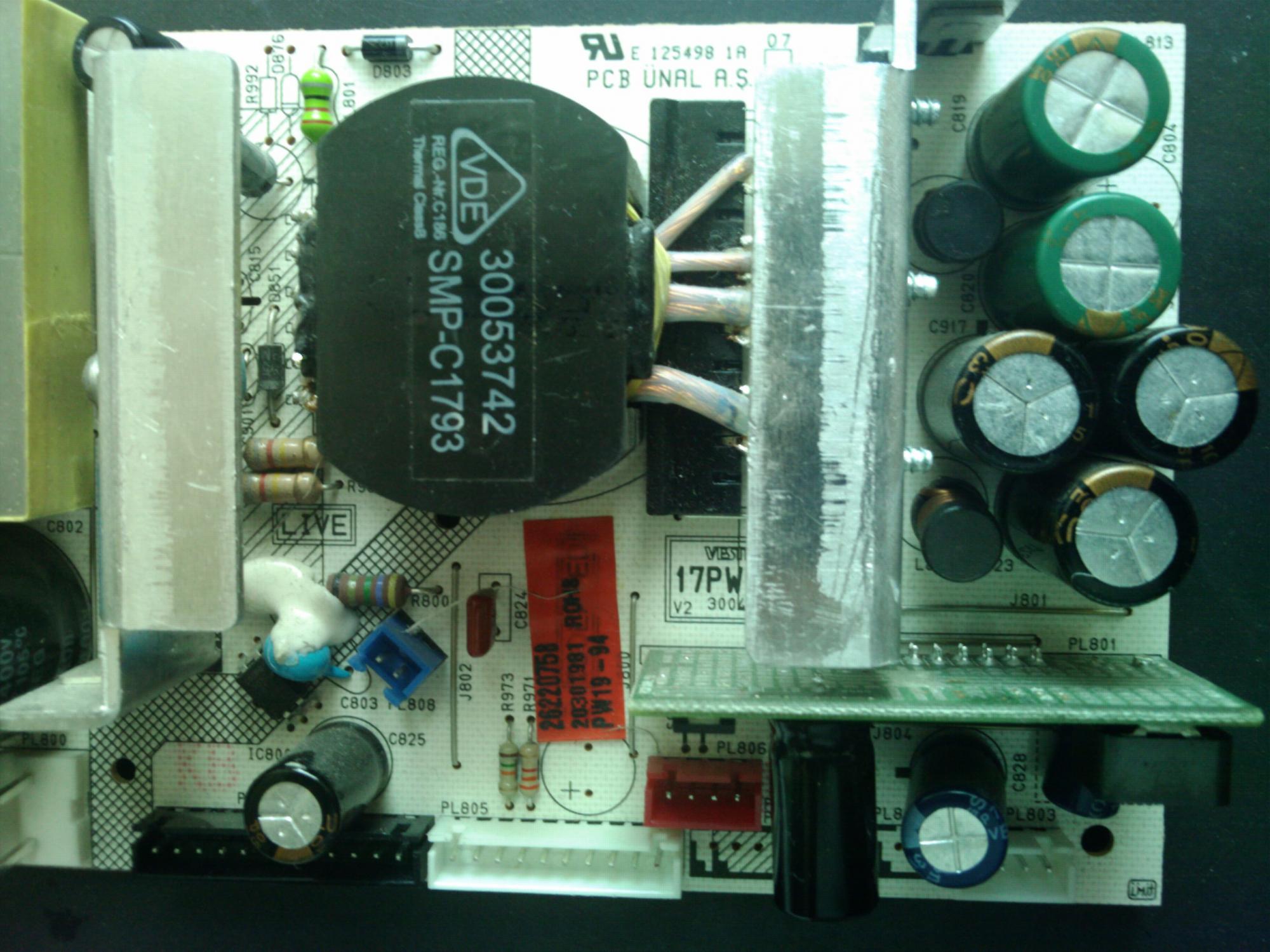

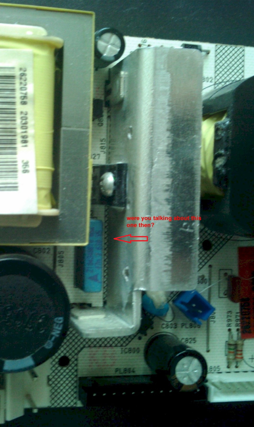

                  Please see attached pictures for the location of the C901 cap.
                  Are you talking about the cuboid blue one in the second picture?
                    Yes, I'm referring to the cuboid one in the second picture. That can sometimes cause this fault.
