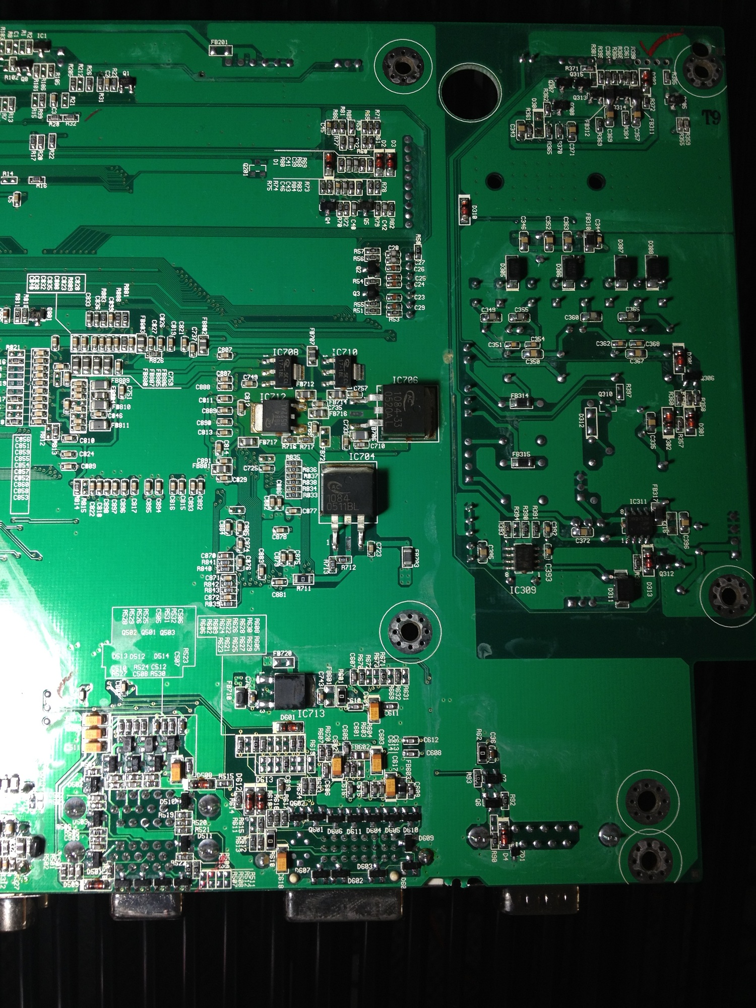

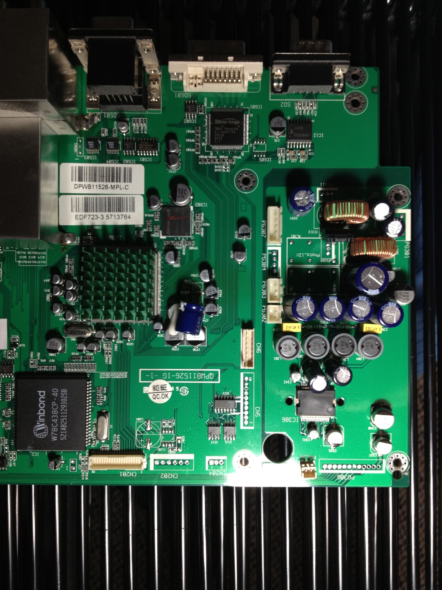

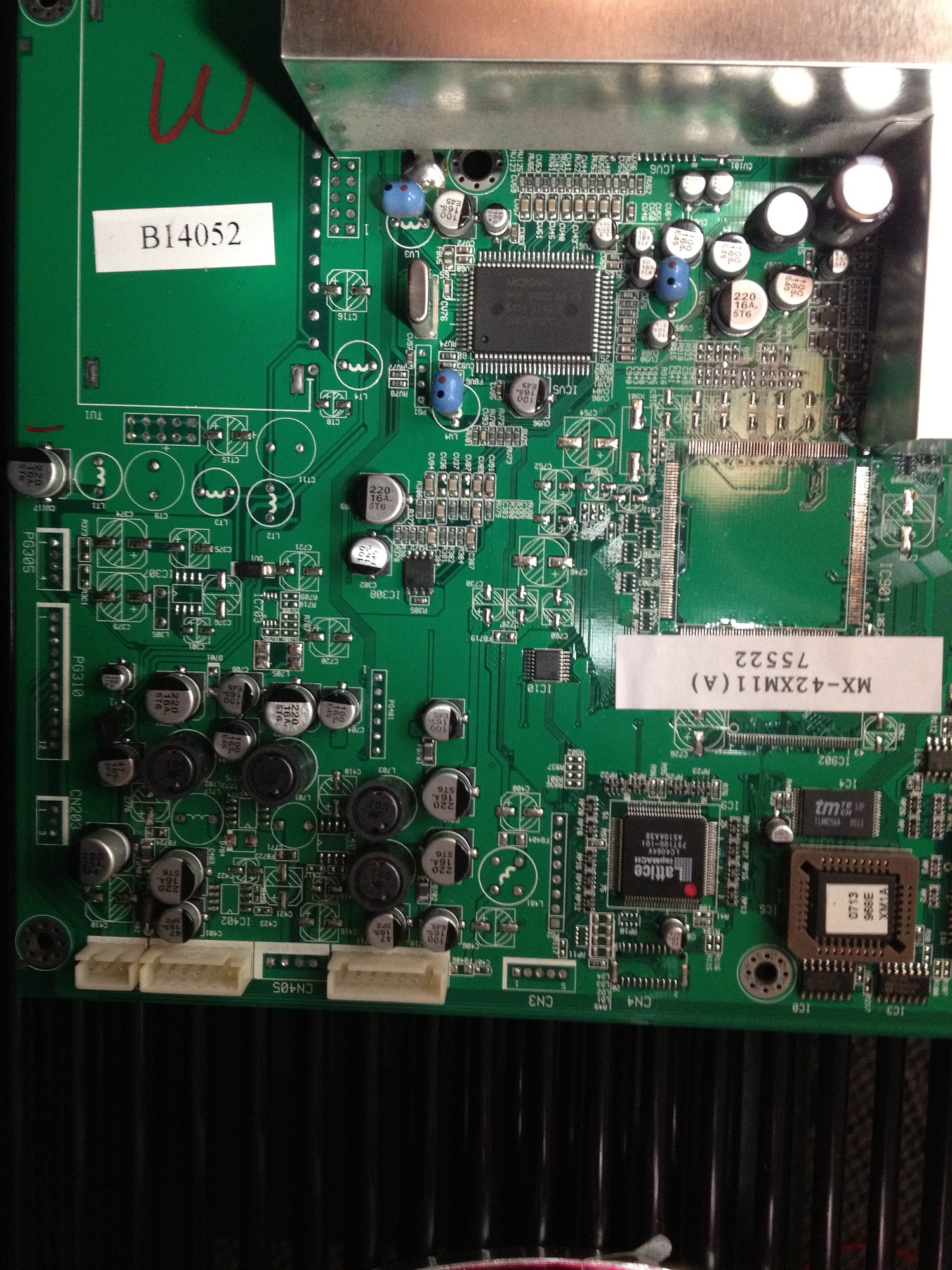

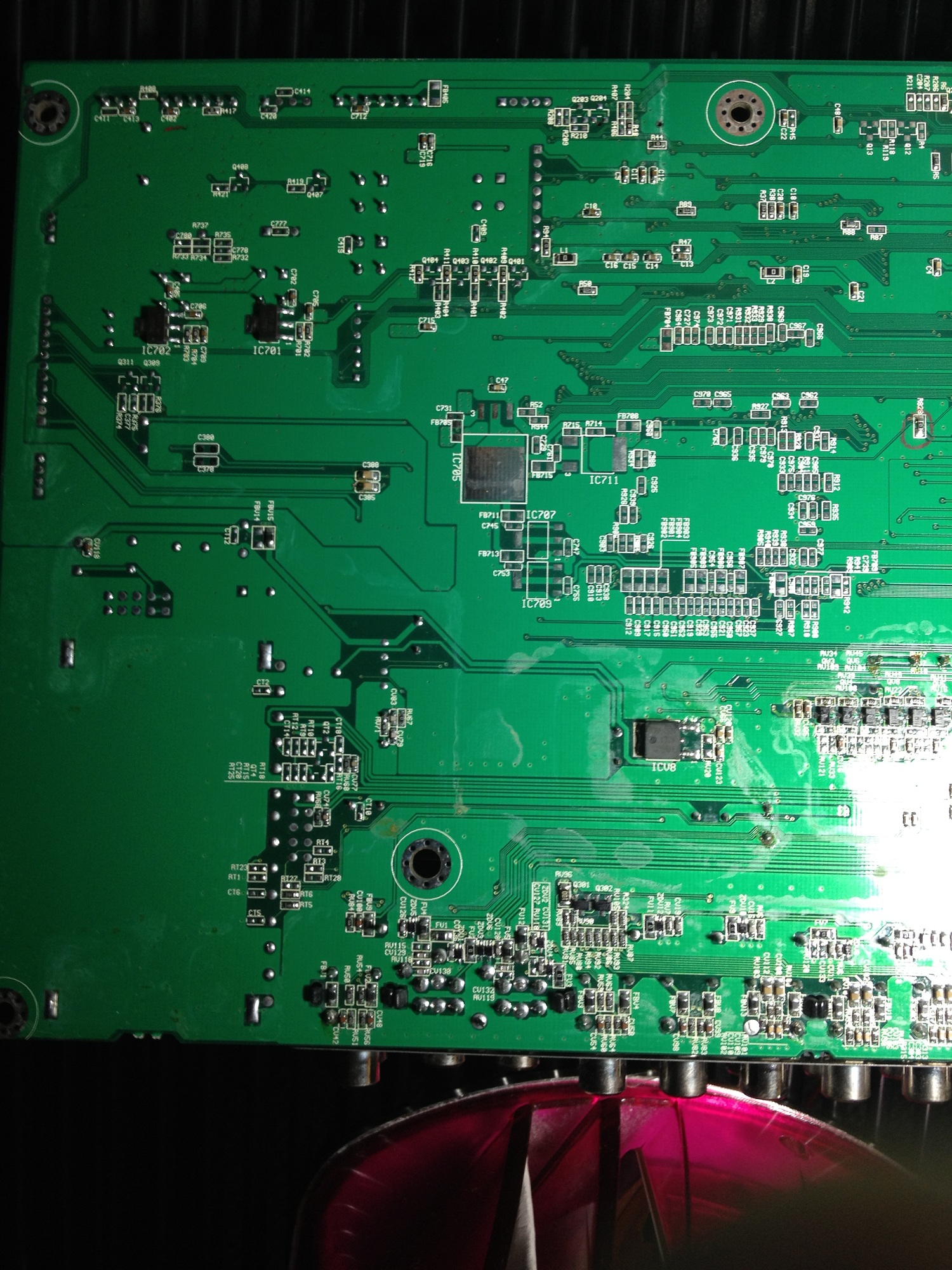

      Well, I'm stuck. I don't know what exactly i'm looking for. I tried cooling the entire main board to see if it would effect the problem. But even while cooled the rate of lines appearing didn't change.
      I included photos of the main board back and front.

        Have you tried pressing on the main processor, the one with the green heatsink?
          Re: 42" Maxent Plasma MX-42XM11 Lines on screen
          Hm it seems pressing down on the main processor causes more lines to appear, and releasing the pressure causes the new lines to disappear. Actually this is true for any of the chips I press on

            This would definitely point to a cold solder joint somewhere; try and localise it by pressing on other chips. Such as the ones without any leads on the outside; the EtronTech one is a good possibility (this is probably RAM.) Do you have a part # for the board? It may be available cheap.

              The lines are becoming more stabilized so there's less change when pressing down on the chips. At one point I noticed that when pressing down on IC12 (next to the analog input in photo 2) some lines disappeared. It is the only chip that manage to decrease the amount of lines when pressed down. There might be more chips but it's under the metal cover over the inputs which is soldered on the board.

                I see it's $100 on eBay - so most likely not worth it.
                Do you have a part # for IC12?
                    Originally posted by tieny View Post
                    232cb p0509bhn7
                    That's a serial interface controller... especially if it's got 14 or 16 pins.
                    Unlikely to be the problem, but possibly in that local area.
                    Remember all the stuff near the inputs is likely for dealing -with- the inputs. Whereas the OSD is processed on the main processor using the RAM. You may be flexing the board causing the symptoms to go away in a different part.
                      Alright i found the problem, it is the EtronTech RAM Chip. Pushing down on it hard enough or at a certain spot causes all the lines to disappear. (With the label "Etrontech" facing forward, pushing the right edge of the chip causes the problem to go away.) I just didn't press down on it enough being afraid I might damage something before.
                        How would I go about fixing this? ( I'm not familiar with these types of chips, are they soldered on?)
                        As I expected - the only BGA device on the board it looks like.
                        BGA (ball grid array) devices have many tiny balls of solder underneath the device which can break with temperature and vibration causing the problems mentioned. Lead free solder is a prime reason for early failure.
                        There are several techniques to fix the problem - one is reflow and the other is reballing.
                        I would recommend reflow, but it usually only lasts for a short while. Reflow involves baking the board at around 230°C for 2.5 minutes. The idea is the solder will melt and the chip will be re-soldered.
                        You can sometimes also do reflow with a hot air gun.
                        Reballing requires you to remove the chip and replace every single ball, then resolder it. It's not for novices, but it's the only guaranteed way to fix it, sadly.
